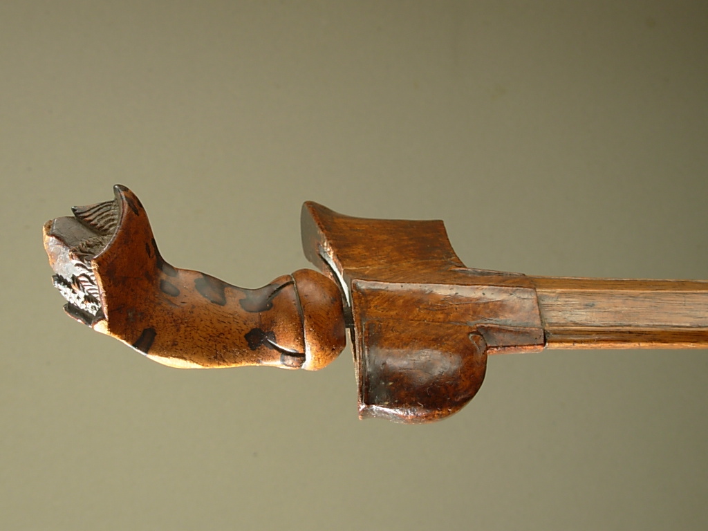

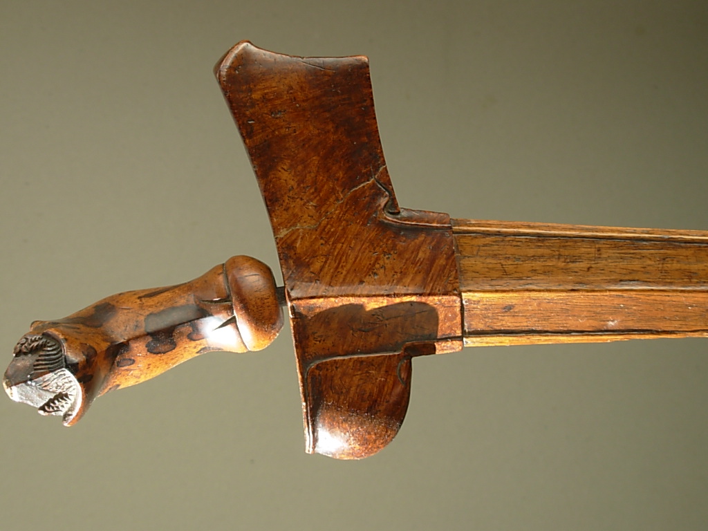

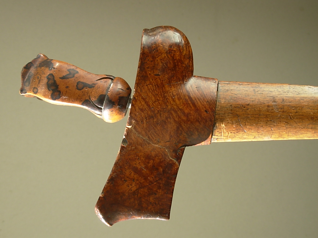

I have this Keris with a very nice ivory hilt, but I find the scabbard very unusual. I think the warangka isn't the original one because it seems to have been lengthened to fit the blade. The selut also seems more modern than the rest.
I think it might be from Sumatra or Peninsular Malaysia, but I'd like to know if it's possible to have a more specific origin?

Nice keris. Could you make a photo of the blade in the sheath looking down from the top so that we can see the fit? Thanks!

Posts: 6,421
A picture looking down on the blade inserted in the wrongko would be very helpful.

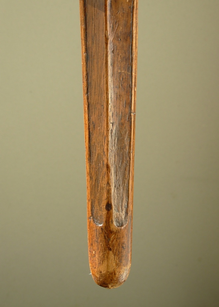

The wrongko is as well somewhat unusual for Madura, the lata is straight by the example in question, by the examples shown from me not.
The hole in the pangulu handle isn't unusual, see the pics of one of my pangulu hilts.

Here are photos of the blade in its sheath.

Posts: 7,218
The form of the sirah cecak & the buntut urang is not typical of a keris that can be classified as Bugis, however, it is typical of a keris that can be classified as East Jawa or Madura.
If the blade does indeed carry flat faces, then we would need to consider the possibility of a gonjo replacement at some time in the (probably distant) past.
