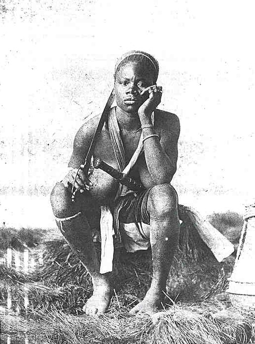

Found some more images ...both dated circa 19 c........the bladed weapon at her waist (first image) ...has anyone any pictures of this type of weapon? Or can it be ID, thankyou.
Ah, Ariel..... the decapitating of prisoners was very common.....almost a right of conquest / status. I get the impression that Chanel handbags were fairly scarce ....so to 'accessorise' ......heads were the next best thing

Old 8th September 2006, 06:58 PM   #10
Posts: 6,001
Some high level diplomacy no doubt.
