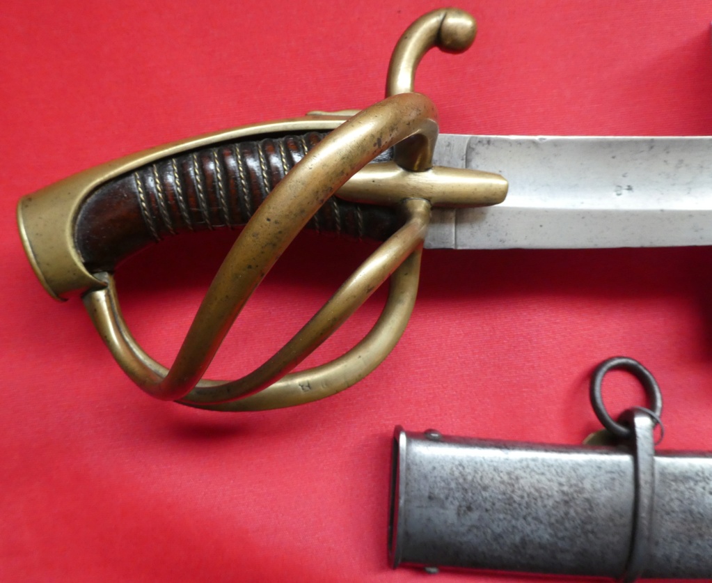

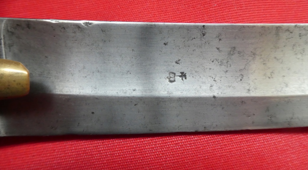

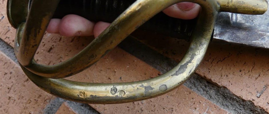

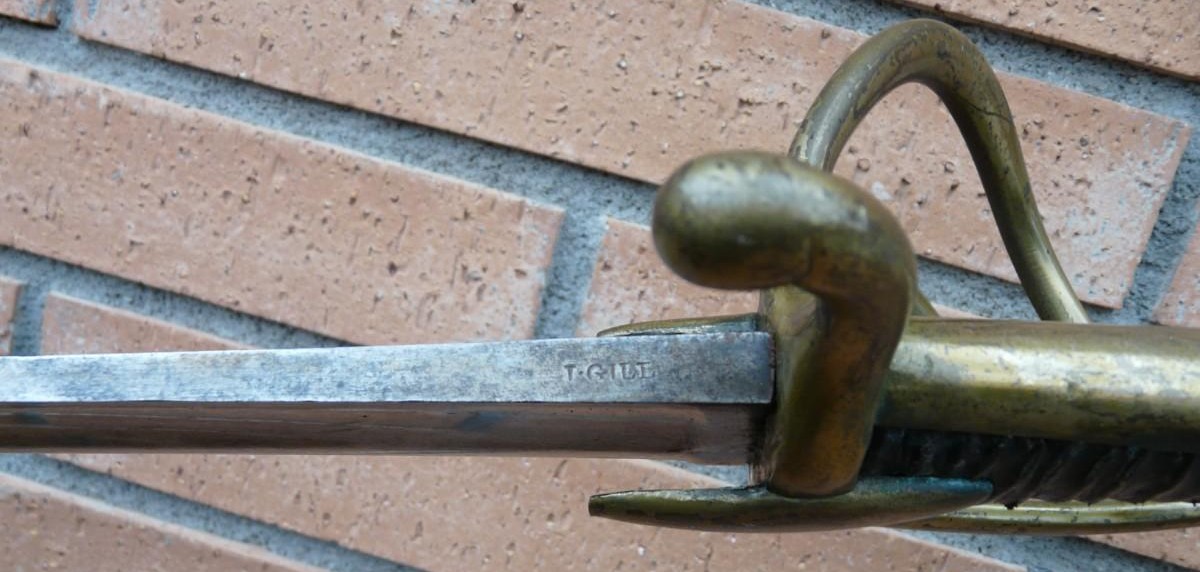

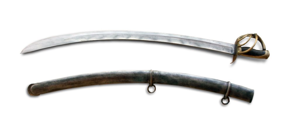

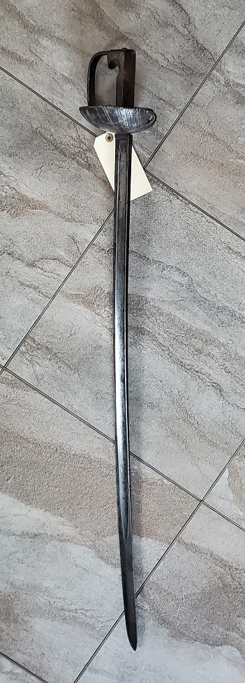

Older ones are probably those British blades mounted with original captured French ANXI hilts, with their original markings. Blade by GILL.

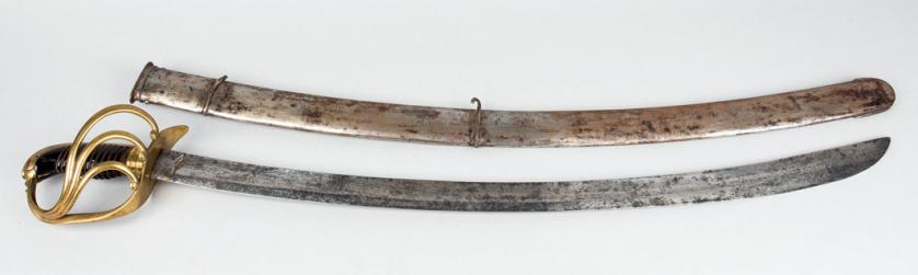

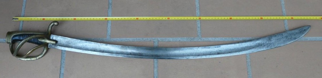

Later, some workshops in Spain were probably able to cast the hilts, copying the French ANXI hilt. These do not have markings. A lot of research could be done here. For example, Gabriel Benito Ybarzabal, who would later make
the brass hilts and iron scabbards of many Toledo swords until the 1830s, worked in Eibar/Placencia, that was under French ocupattion in 1808-1813.
Did he made hilts for the French? No idea. In 1814 he was able to make hilts for the Spanish Guardia de Corps units, so we could think his workshop was spared.

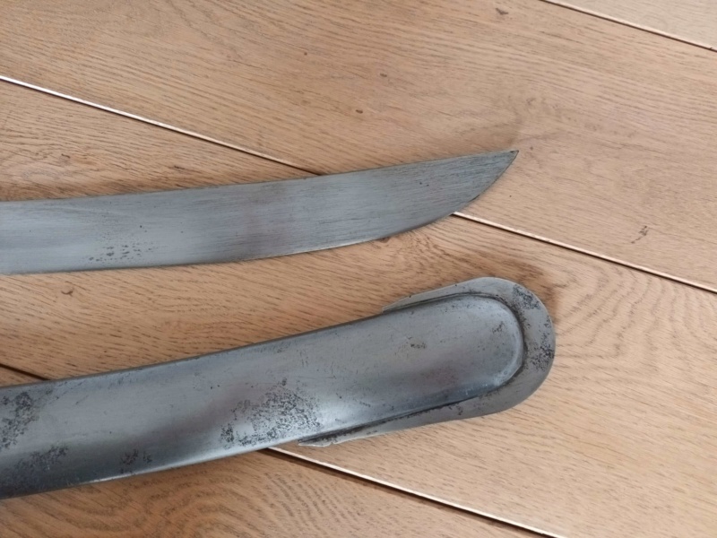

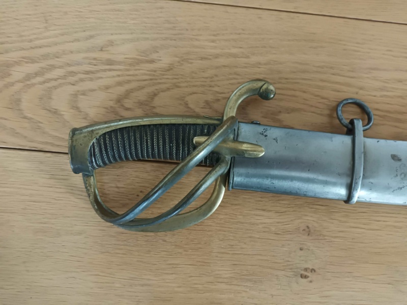

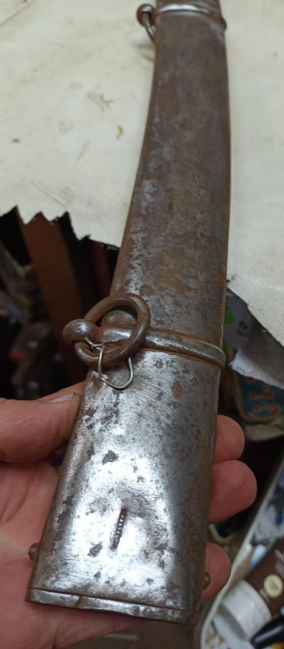

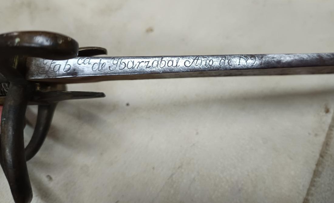

In 1821, after a political turn, larger freedom was given to individual entrepreneurs, so Benito Ybarzabal started making complete swords in his own factory. One of his models was a copy of a LC 1796 blade, marked on the spine Fabrica de Ybarzabal Aņo de 1821, with an unmarked copy of a French ANXI hilt. Scabbard, copy of the British original, is marked Ybarzabal. It seems this concoction was a favourite of some Spanish officers and they ordered it to be made anew.
Spanish cavalry officer swords with Toledo blades can be found with iron hilts resembling the ANXI, in the period 1808-1820. And same happens with the 1796 LC blades.

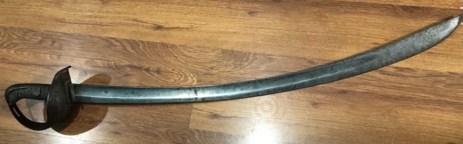

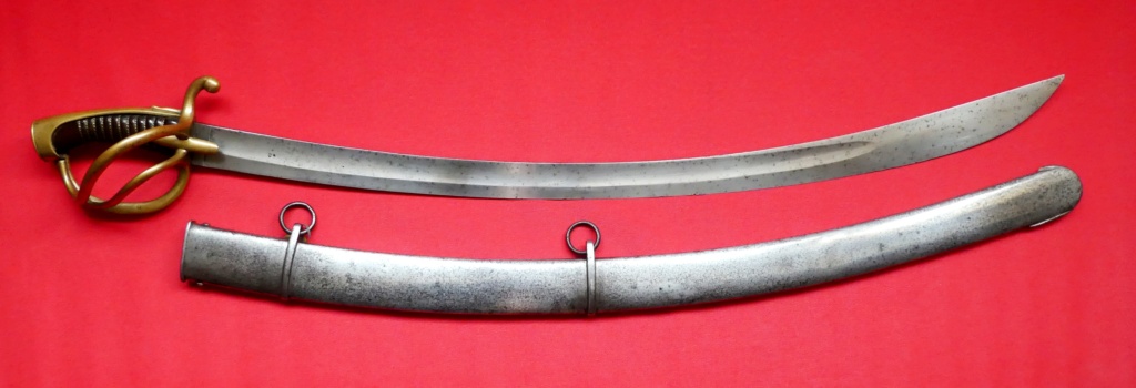

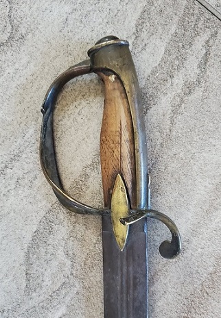

In later years, some Spanish derivatives of the ANXI hilts, as the rare 1825 LC model or the 1815 LC for troopers or officers (here) were also matched to the British 1796 LC blades.
Even the 1860 LC model (Iron basket) can be found with an old 1796 LC blade. Probably an officer favourite.

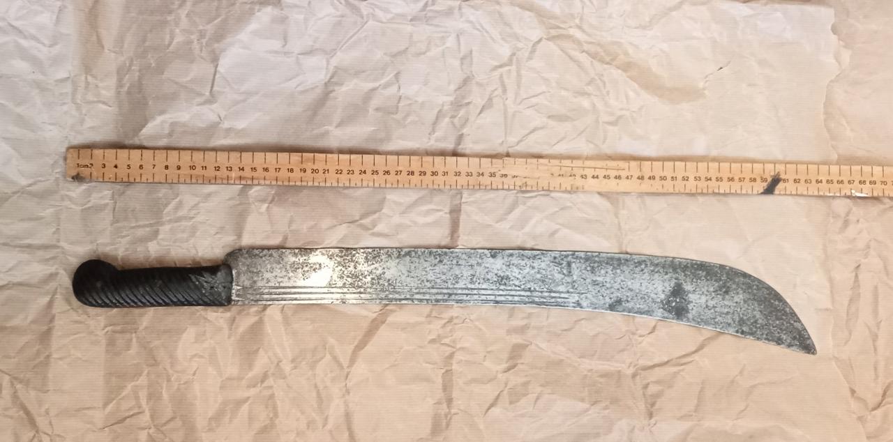

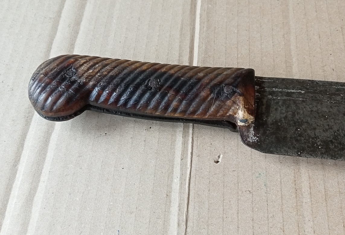

Countless of these ended up in North America in trading networks (thus they were well known among American Indian tribes) and in Mexico. The blades often were remounted in many Spanish colonial swords, such as the Dominican and Cuban machete type swords, even on other cutlass type weapons.

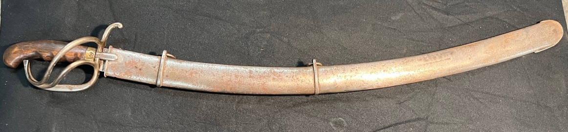

With the ANXI hilts, it seems they formed the basis for hilts produced in Spain in the 1820s seen in colonial settings, so it seems possible that at some point Spanish cutlers might have produced direct copies of them.
This colonial Spanish hilt 'reflects' the style of multi branch hilt which may have some connection (?)
The second example (right) also a Spanish/Mexican hilt of same period but of course brass and again resemblance. It is unclear whether these hilts were produced in Spain or Mexico, but more likely Spain.

In noting the earlier posted example here of a French ANXI saber with a blade by Gill, I would bring up the high reputation Thomas Gill of Birmingham had established after the 'sword scandal tests' of 1786. In these matters he pared his blades against several other British makers as well as German blades.
While the other blades failed in notable number, only 4 of his did (out of 2600 examples).

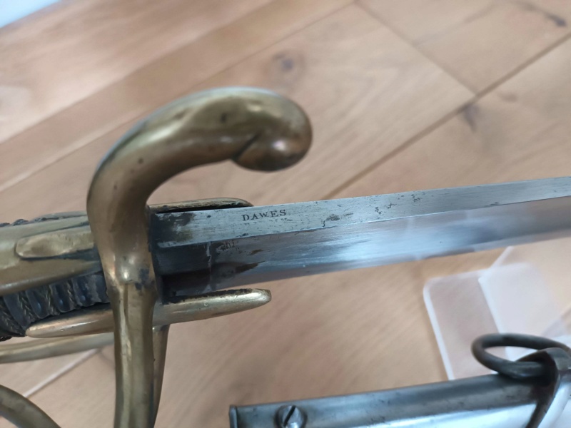

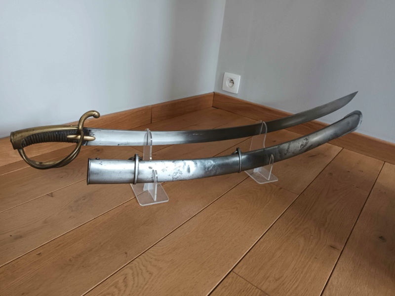

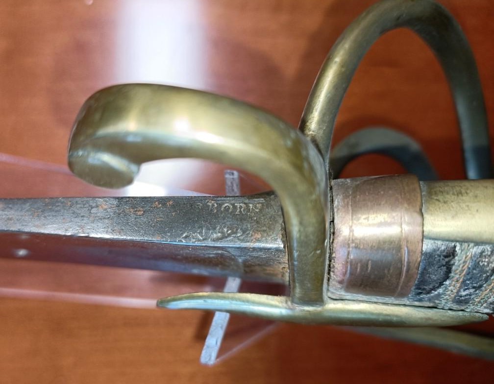

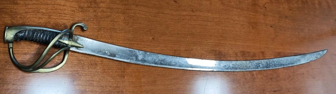

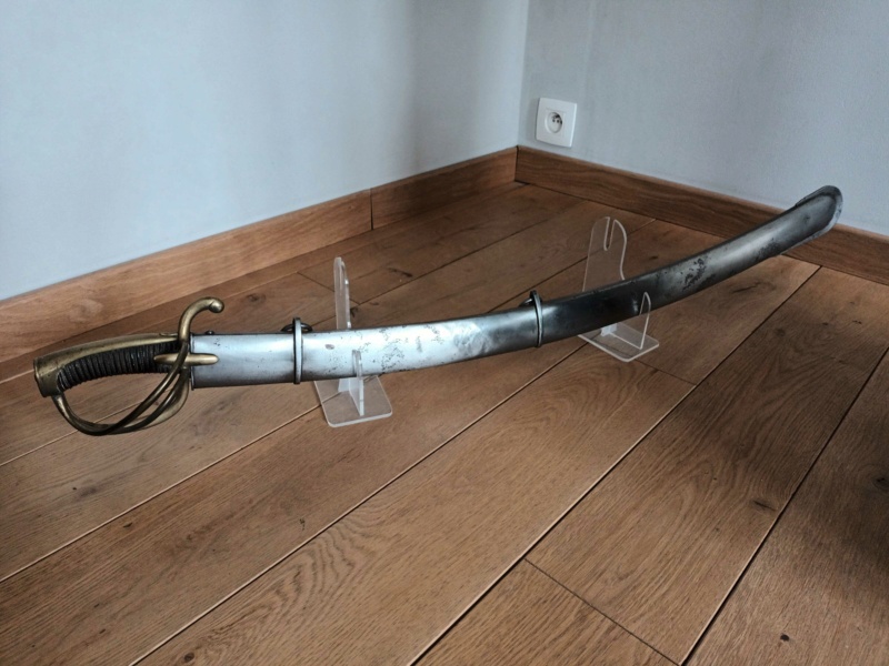

Another couple of Peninsula Anglo-French concoctions. Both by Dawes.

Excellent and MOST esoteric! It seems there was far more cross diffusion of British and French blades than realized in these times, as if the Napoleonic campaigns were not confusing enough!!
Clearly the regard for British blades brought about by Gill must have expanded to other French examples of these sabers, as I noted another with Osborn blade.
