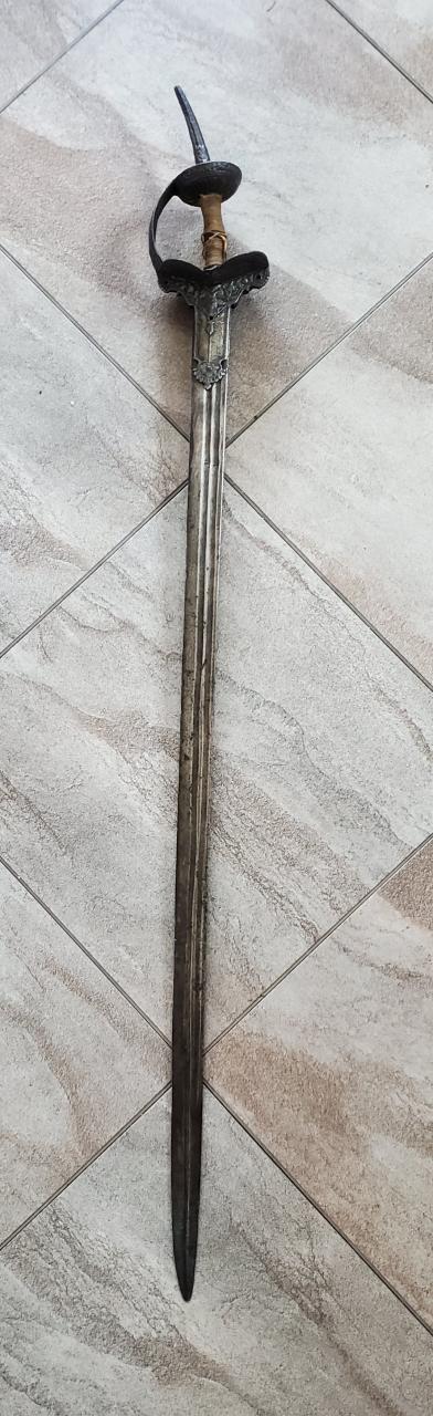

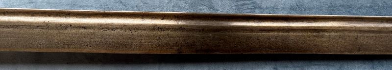

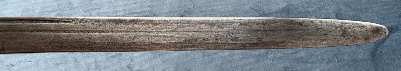

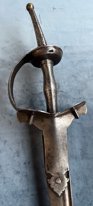

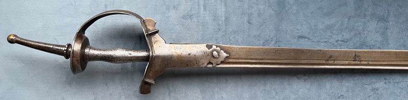

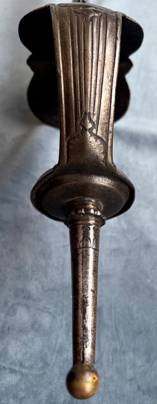

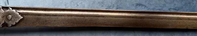

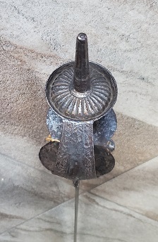

For quite a long time in my collection there is a Khanda (Firangi) sword, probably Marathi, "Shivaji's sword".
The blade is Indian, straight, with two thin fullers on both sides of the blade.
Such swords were primarily insignia, denoting the power and high position of the owner, they were also presented by rulers to their commanders or courtiers in recognition of their merits or other encouragement. These were sword-stick, which were held in the hand in a vertical position by the handle, with the tip of the scabbard resting on the floor.
Overall length: 1200 mm, blade width: 35 mm, blade thickness: 6 mm, weight: 960 g.

This is a beautiful example of these distinctive Indian swords, which is simple, unpretentious, and quite likely from northern regions in India, Rajput.

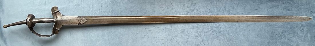

With the development of the expanded elements of the 'basket hilt' by the late 17th c. through the 18th long straight single edged cavalry blades began to appear on these, and they were most certainly fighting swords. The long stem on the hilts already extant had been intended for two hand use of the sword, though later less prominent vestigial examples are known.
The 'firangi' blades seem to have been mostly European, with German and Italian blades most common, and these seem almost invariably backsword (single edged). While more typically German, we have seen Italian examples which likely came from 18th c. schiavona.
Indian armorers were fully skilled in producing their examples of these blades, thus technically overriding the 'firangi' term, but that is of course irrelevant. In my opinion, 'khanda' remains the most workable term for these aside from the familiar nit picking

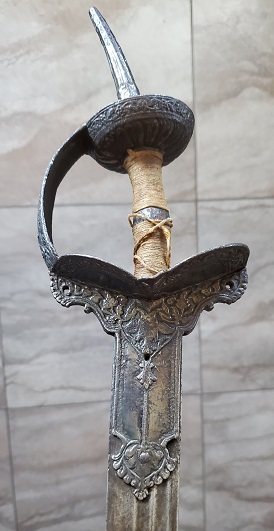

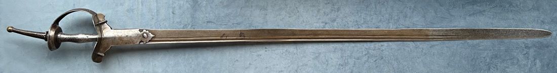

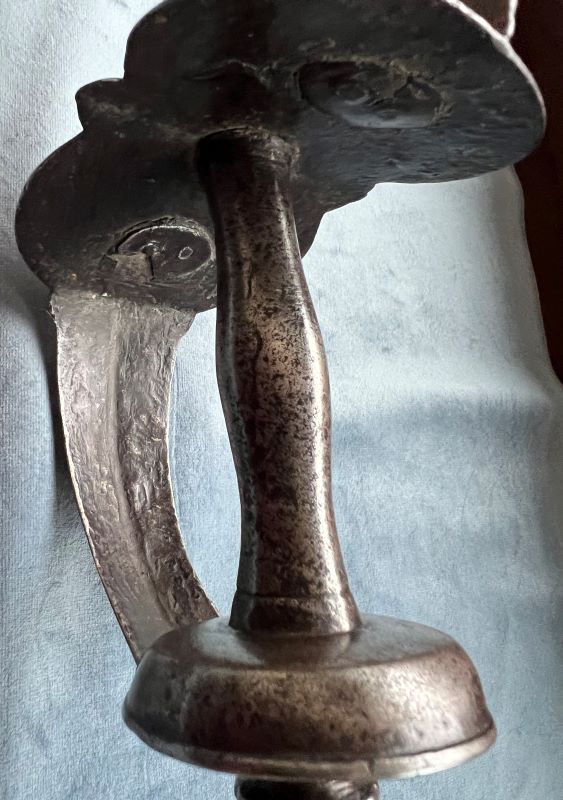

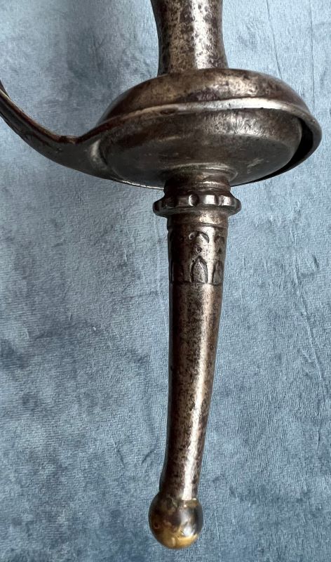

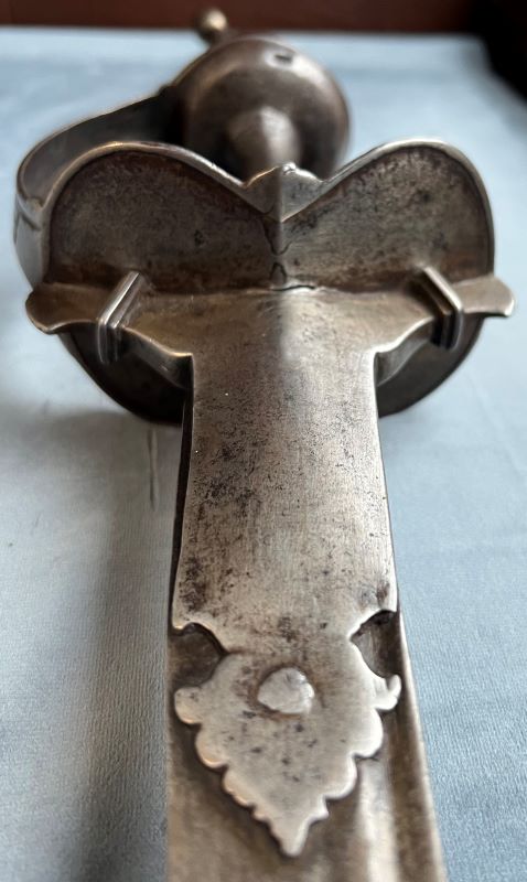

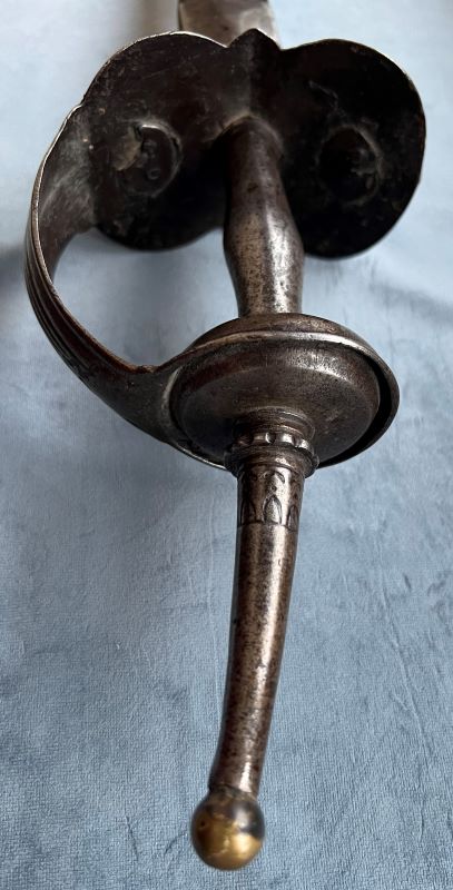

This is my single example from years ago when I was studying Indian swords here, and of course likely end of 18th into 19th. Blade is unmarked (unable to see beneath forte reinforce) but surely European.
It is tempting to consider these as being from period of the Anglo-Maratha wars 1775-1819 (the MAHRATTA is old spelling of Maratha). It is really hard to say Maratha or Rajput on these without far more expertise in decoration and other nuances, but these swords are the most compelling of Indian forms, far less ubiquitous than tulwars of course.

Thanks Jim McDougall!
You have a beautiful sword, probably a fighting one.
My sword has a thin and flexible blade, it is impossible to use in combat, so I consider it an insignia.

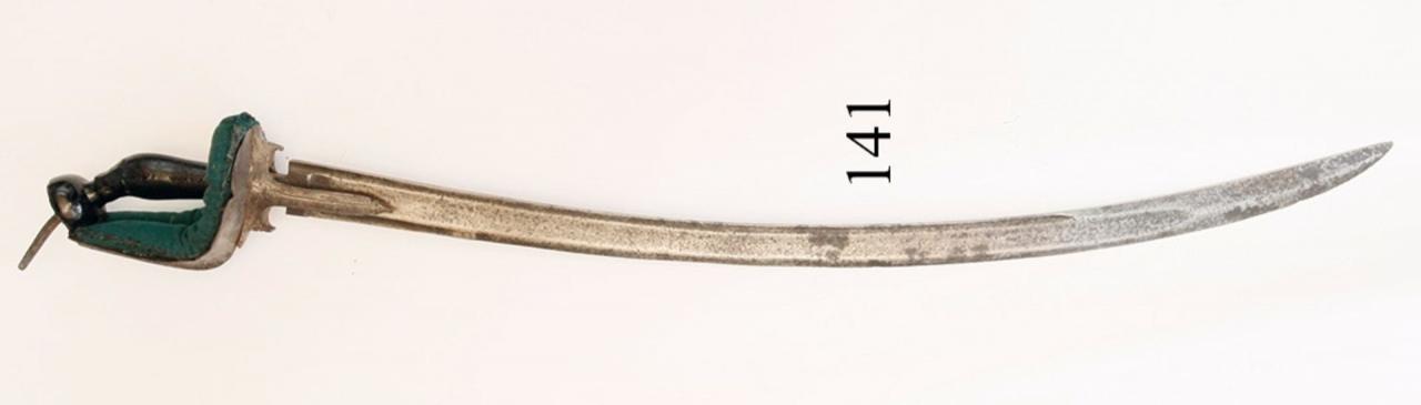

It's interesting to note that the khanda sword was adopted in the North of Sumatra and there it was called peudeung, just won by a German auction such a sword, mislabeled as "Khanda from India".
