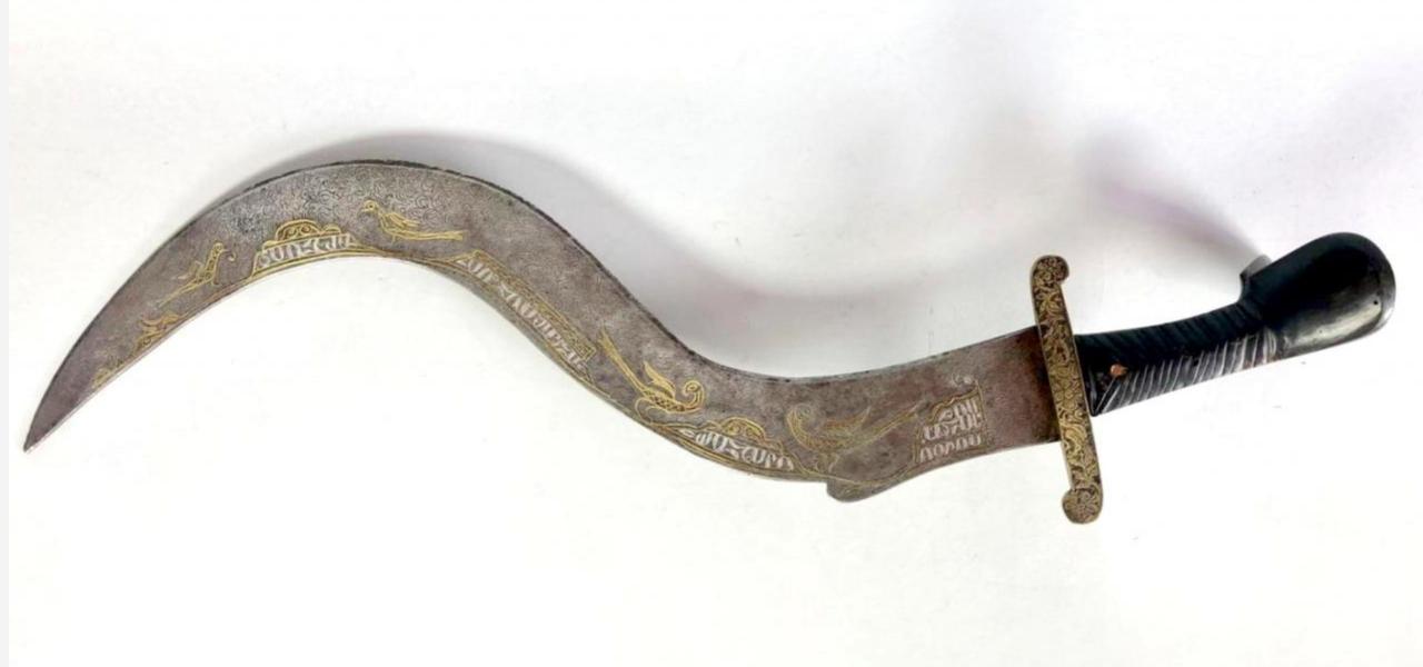

Just arrived today. This is quite possibly one of the rarest ethnographic weapons, I am only aware of one example that ever sold (this one, sold once in 2012, the same example sold to yours truly in late 2023) and a very small number of photographs of 2 other examples, which were posted to this forum. So needless to say it's a great privilege to have this in my collection.
In terms of identifying this weapon, it seems to be a very extravagant version of the Kurdish-Armenian yatagans, which are somewhat more well-known and documented. The closest thing, both in blade form and decoration, is this Yatagan (find it below) with stylistic inscriptions in the Armenian alphabet.

beautiful ! Thank you very much for showing this☼
Question I have is how it was used or better:
did it require special or different style or way of fencing ?
Impossible to tell, given the lack of sources, how this weapon was used or if it was even used at all. May have very well been a decorative piece. I will say, it is a lot sturdier than the Black Sea Yatagan I own.

http://www.vikingsword.com/vb/showth...lack+yataghans
Falls right into place with your previous thread and entries.

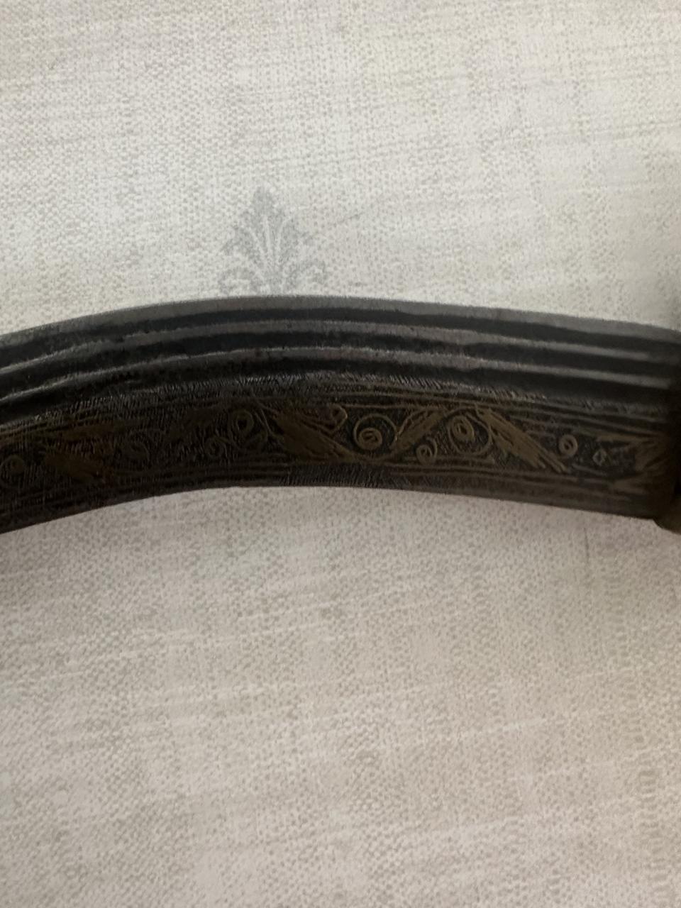

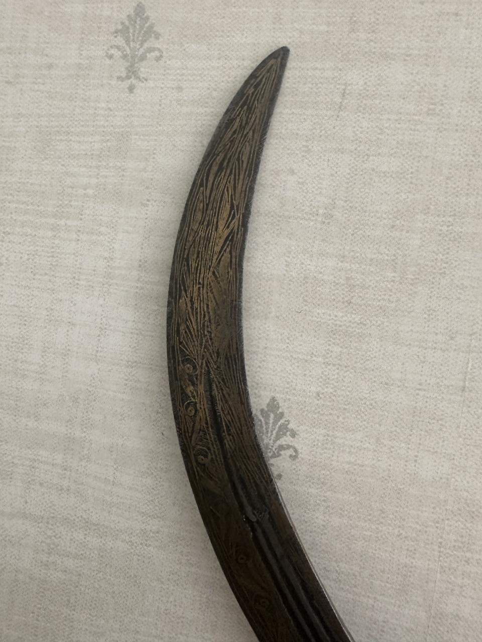

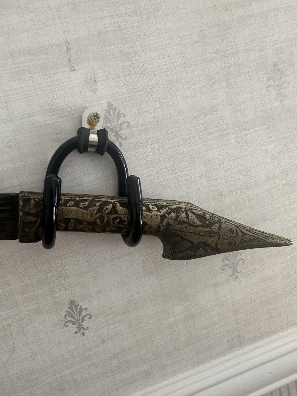

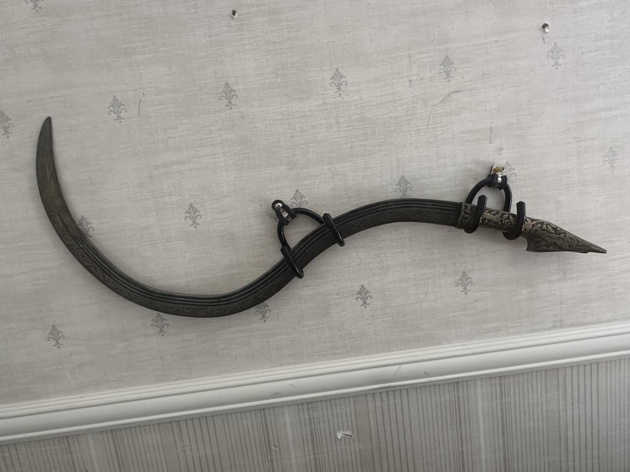

It may be for theater or a performance. The engaving at the man on the end matches my Qajar theatrics kindjal very closely. See my post on it as well.
