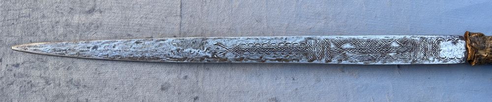

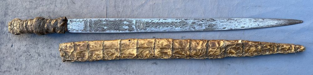

My latest dha/daab, oal 83.5 cm, sword 81.5 cm, handle 26 cm and thickness of blade against handle 9 mm. It could be a sword from Laos. On Iain Norman's excellent homepage on Asian swords, in the article: the sword of the elephant, similar specimens but still some differences.

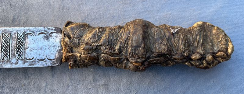

My dha has no handguard, the hilt is damaged but seemed to have been wrapped entirely with a thin white/gray metal rather than cast brass/bronze. The decoration of the handle against the guard is rather rudimentary, the knob at the end then resembles the specimens shown. The blade has had a hard life, with a bent piece in the center with two notches in the edge, must have been a violent impact. On the blade on both sides two light decorations. Sheath is in fair condition, the black rope seems recent (plastic?). Opinions welcome.

That one looks in pretty rough rough shape but it might clean up well. It needs a good clean to assess the hilt more clearly and the blade too. I think I see some areas of delamination of the blade—is that the case? I agree that it is a daab, probably Lao, 19th C.
Iain will give you a more definitive answer.

Thanks for your response, the handle is indeed in a rough state. I have tried to polish the metal but with little result.The remaining metal is quite brittle, especially at the pommel.Where the metal is gone there is a hard material, looks like some kind of resin, a bit strange.The blade has some flaws in the steel probably due to impurities during melting, probably native steel.

The sword in question was once a very nice sword, sadly it's left as a relic only. The stuff at the handle is indeed a mixture with resin and other components to form the thin silver cover which is mostly gone. It's a similar technique which was used by keris handles.

In my view this is a late 19th century Laotian sword, although it can be from the neighboring Lanna regions.
The resin you mentioned is the usual tree resin used to fix blades and handles. Very multipurpose for dha/daab and you will find it used to glue down all sorts of materials.
The blade decorations are typical in both Lanna and Laos and can be found on blades with great age and of course newer 'touristic' swords. They are not a sign of a good or blade in their own right and need to be assessed with the whole sword.
