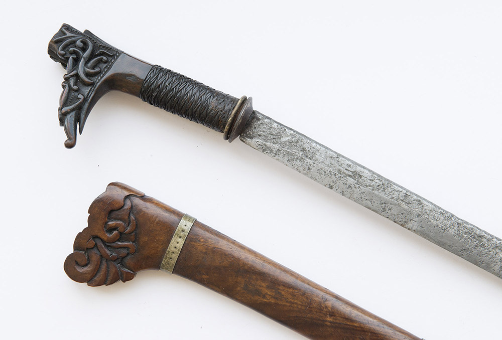

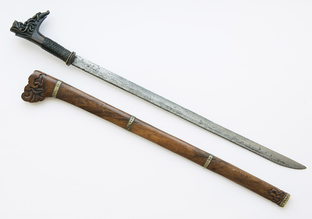

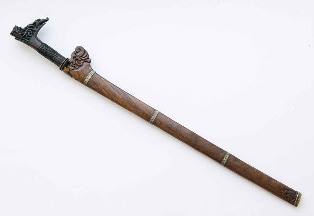

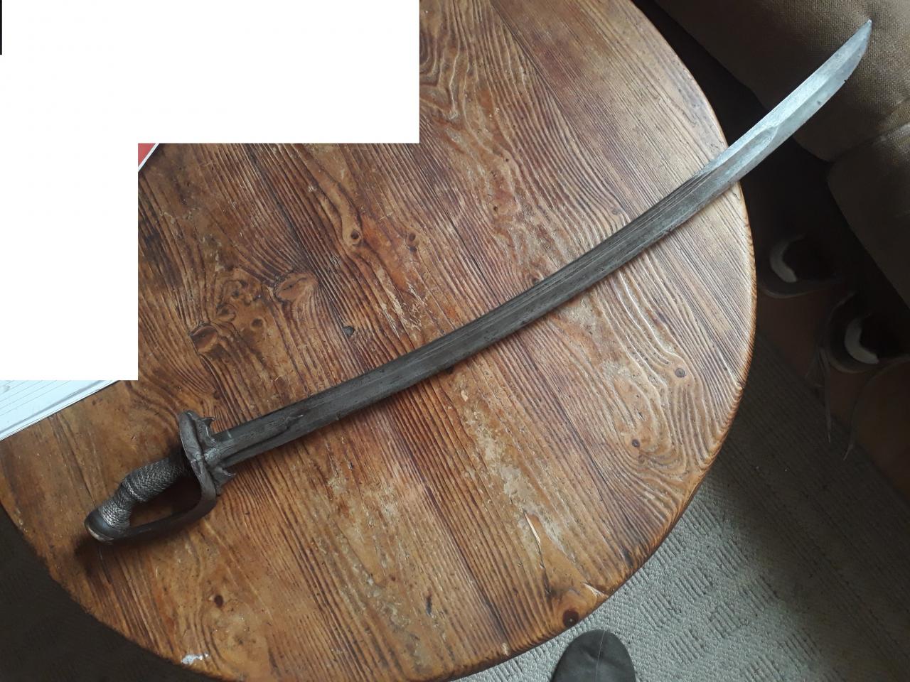

Lately I was able to add an Aceh peudeung to my collection. It was described by a German auction house as a firangi. But after I have received it I have seen that it was in a very bad state, someone had attached the handle with a white compound mixed with steel wool but pushed the handle not deep enough to the blade, glued a green modern synthetic hand cushion inside the handle which made it impossible for an adult hand to grip it and the handle was badly corroded. It takes me some effort to open the handle and to remove this white compound completely. I bathed the handle long in vinegar to remove the rust. After all was cleaned I reattached the handle in the correct manner. Now it's a good peudeung, not a first class peudeung but a fairly nice example IMVHO. What do you think? All comments are welcome.
It's 91 cm long, blade 75 cm and 6,5 mm thick at the spine behind the handle.

There seems to be a pretty amazing similarity with most of the examples of this sword that I have seen; almost like they came from the same shop or manufacturer. The example I bought from Artzi has the original pad still installed. The only differences that I have seen are in the richness of the embellishments added
Do any of our members have an idea when this sword form was introduced into the Acehnese panoply of sword forms?
I would say the steel parts of the grip and guard (including langets) are highly standardized but not the rest of it (blade, pommel cap, cushion, decorative elements, scabbard).
I have two of them atm; one has a very nice, light, nimble blade with a triple fuller running into a single wide fuller that is otherwise quite similar to the one Detlef showed here, and a silver wire grip. The other has a bare steel grip and a fairly standard triple fullered saber blade like those found on 19th c nimchas and other swords. They look superficially similar, but they handle quite differently and they have quite different distal taper.

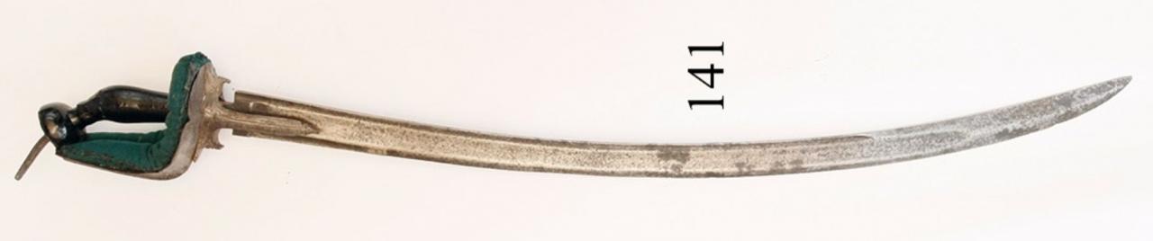

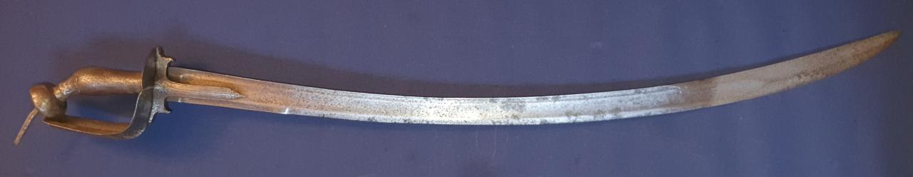

Rick, so far I know these are officer's swords which were used in the Aceh wars. But I can't tell you when these swords pop up in Aceh. I think that they are strongly influenced by the firangi swords from India, Aceh was at all times a trade spot between many cultures, India, Arabian Peninsula, European and Chinese ships coming along the Malakka street. I think that this can be seen by these swords. The high end peudeung have gold crowns on top of the handle set with diamonds. The blades differ like you can see by the posted examples and the engravings on the hand guard also.
Attached are a few more pics from my example.

Here are some pics of the before mentioned gold top pieces of handles.

They are definitely influenced by Indian basket hilts, and are often mistaken for them. There's one in the World Museum here in Leiden that is mislabeled as Indian.

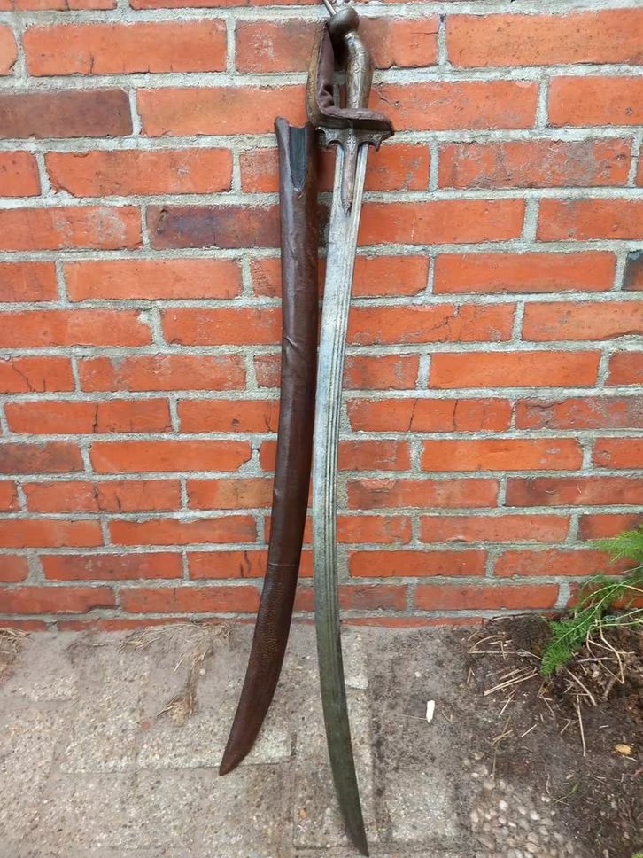

I don't know how far back they go but this rather cool looking lar bango sword (18th c according to the auctioneer) has something that looks to be an earlier version of such a hilt (grip not as strongly curved near the pommel as these later examples).

BTW Detlef I would be interested in hearing how you went about fastening that blade without damaging anything. I have one sword I kind of need to do that with but it is a silver hilted Yemeni saif and I am worried I will destroy it when/if I try.
Hello Jelle,
I have used a two component mass named milliput, it's like putty and gets hard after a few hours and is black when hardened and looks like cutler's resin when hardened. You can get it on Amazon.
