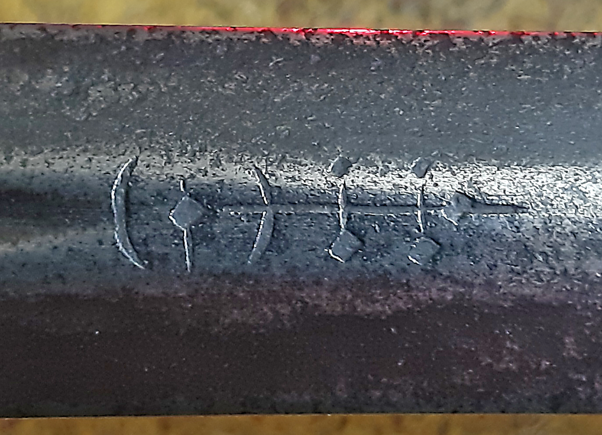

I have finally been able to photograph the (punzone?) on the English rapier blade marked Sebastien Hernandes.
I am sure one of you will be able to tell me, from this mark, if the blade is Spanish, or German using a Spanish name for prestige.

Old 9th April 2024, 03:12 AM   #5
Posts: 10,872
Looks like the 'anchor' device typically in fuller on early Spanish blades as would have been on Hernandez blades end of 16th also Tomas Aiala. It seems this one resembles one on a rapier of the Atocha wreck (1622).

Keith, I wish I had good tips on conservation but I seldom do much cleaning etc except for WD40 to stabiliize and perhaps some very fine steel wool. Easy does it as you dont want to compromise any existing marks. For some reason I thought you had seen the Hernandez punzone at the ricasso as per Palomares.
As mentioned, I have always thought that his punzone was not copied on German blades.
While the Germans did adopt the the multi bar 'anchor' (much like somewhat exaggerated cross of Lorraine) the character of the anchor on this blade seems to me in accord with those on earlier Spanish rapier blades as noted.
For me, everything so far with this blade suggests it is indeed Spanish, and incarnated with an early 17th century English cavalier rapier hilt, as was very much in vogue then, remarkable!

As Fernando remarked earlier in this thread, the image of what I thought was the typical Hernandes punzone was very poor (vendor) and I saw what I wanted to see.
I approached the ricasso inside the dish with some white spirit, as I have found most black discoloration is old preserving oils or waxes - or both - and a lot of the muck did indeed come off; enough to indicate there was no marking beneath it.
The mark I posted earlier today is from the lower end of the fuller (on both sides). I have seen quite a few that are similar, but not one that is an exact match (see pics). That, along with the name, is the only indication of provenance.
