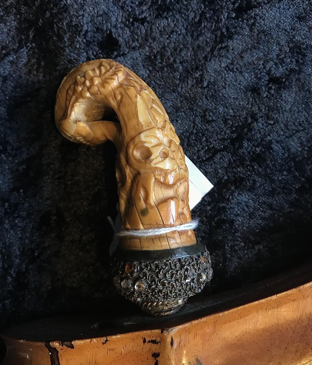

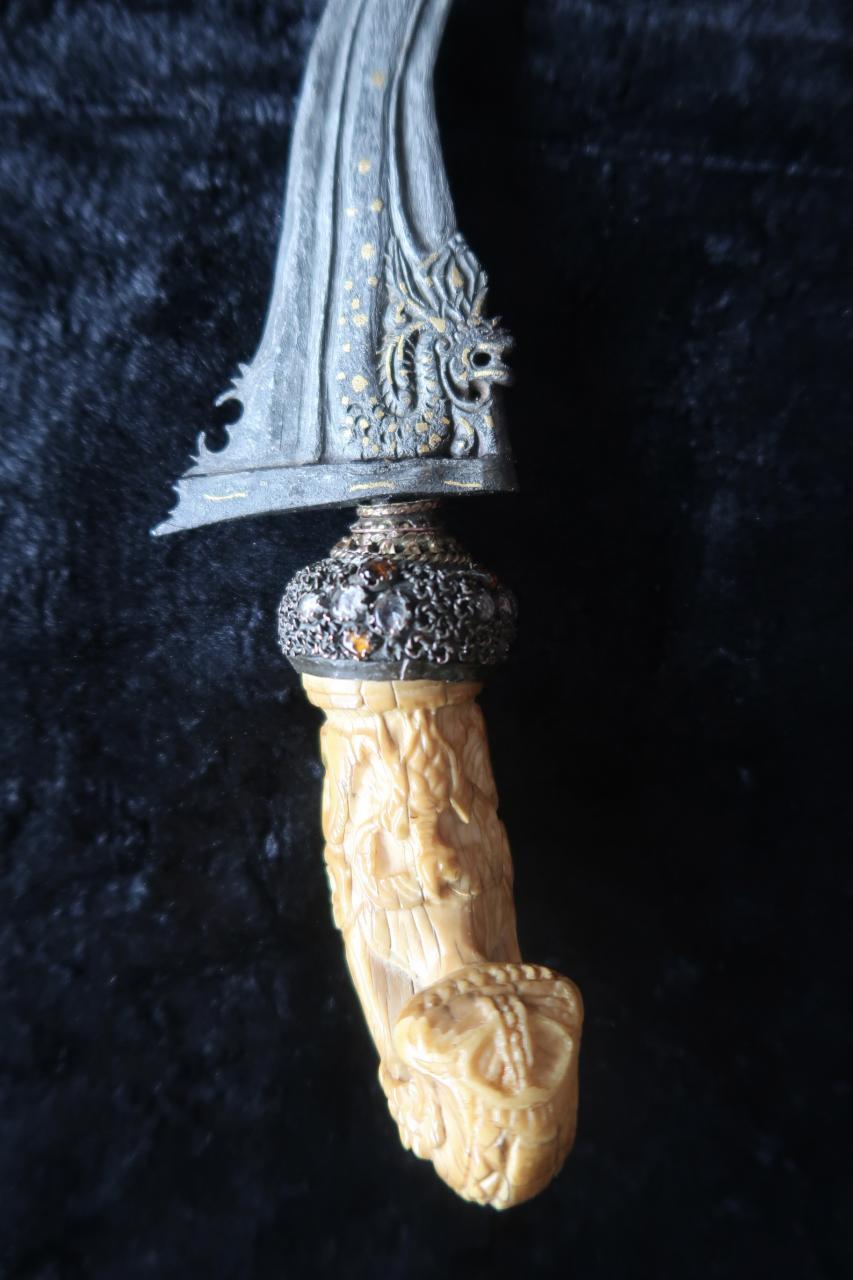

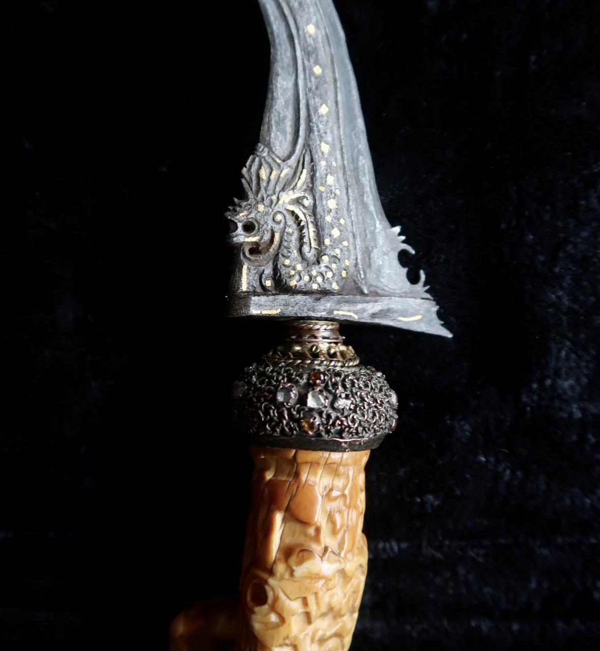

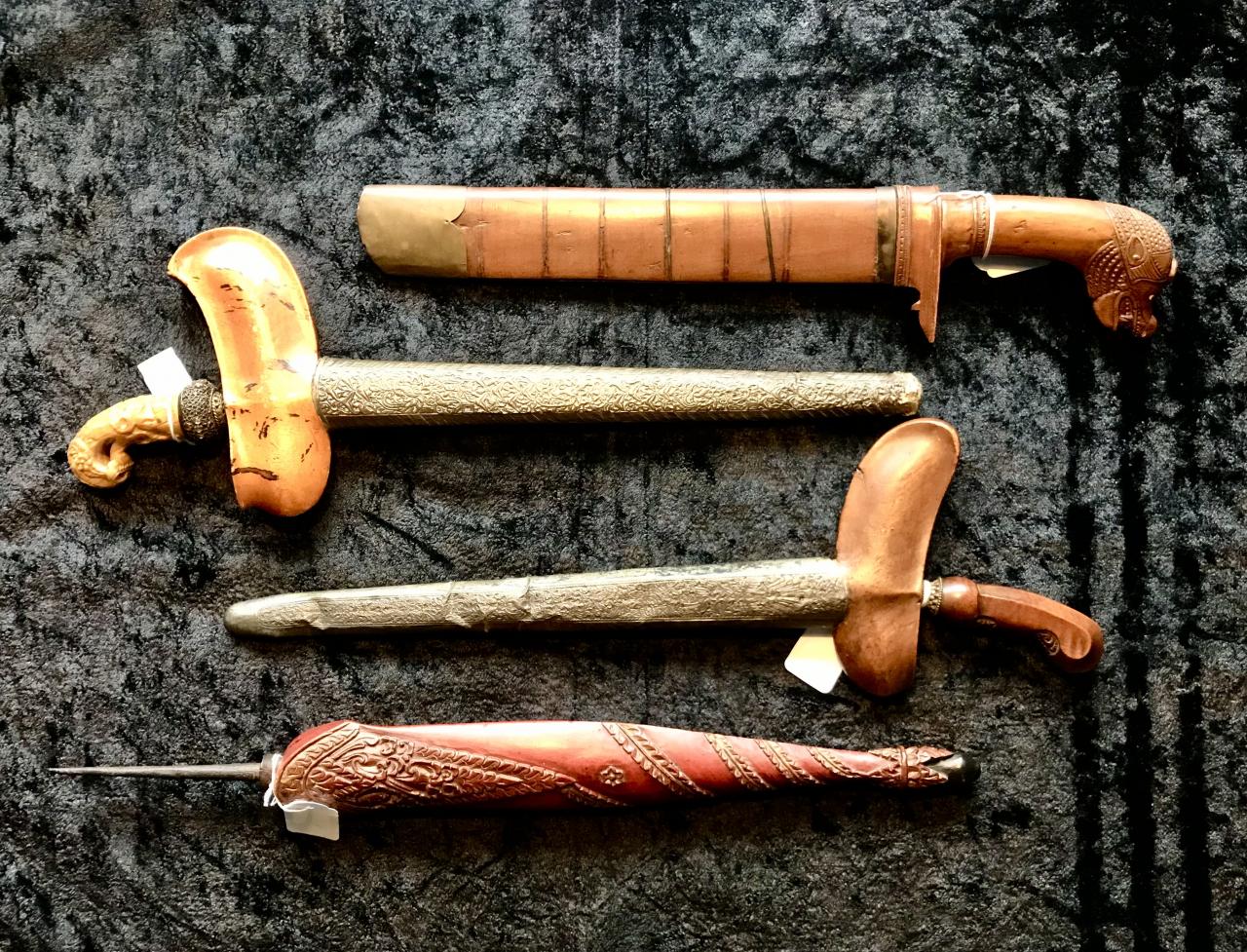

I bought several items at an auction in the Netherlands a golok, a Keris Yogyakarta Gayaman and a Tombak with sheath the tombak shows pamor
And a nice 19th/ early 20th Century Keris with a Warangka Gayaman (Kayu Pelet), Ivory Madura Ukiran. Silvered Selut with stones. The Wilah inlaid with dots and carved with a Naga and 11 Luk. A silvered pendok that needs restoration. I already restored the mendak as it fell apart so I made a new inner sleeve where all the parts slide over and hammered it carefully together again.
I am not sure if the inlay is gold but it looks like it.
Hope to learn more about this Keris through the forum.
Thanks and best wishes, Martin.

Hi Martin. For me it is really difficult to give a good assessment of this keris based on the photographs you have provided. First off o would like to see the blade photographed flat, not approaching from the an angle as you have, so that i can see the actual proportion of the blade elements. Also an image of the entire blade in one photograph would be helpful. Try to photograph it in better, even light so that that you can get sharper, more detailed images. Overcast skies can provide a nice even lighting for this. I don't think the blade is particularly old given the way the features (naga and greneng) have been carved, so it is strange to see the hole worn through the blade (usually this would be caused by many generations to acid washing). So i am not certain if this blade was intentionally aged or not. Better photos might answer that question.
Your hilt does appear to be old ivory and this type of hilt is from East Jawa/Madura and is called Donoriko. Yours does not seem to have been carved with a great deal of detail as some others and it has a good bit of damage. But again, better photos would be helpful.

Hello Martin,
I agree with David, better pictures would be very helpful.
But I think that the blade is kamardikan and crudely executed. The handle is antique but not worked with great skill and very worn, compare it with other donoriko hilts (just use by the search function the keyword "donoriko").

In respect of the dragon blade.
It is not an old one, "old" being back into the 19th century --- this "old" idea can wander around more or less according to the feelings of the person who is providing the opinion, so "old" might be pre-1640 or so, or it might be 1978 or so.
My feeling about this particular blade is that it could be 1920's through to mid-1970's, before 1980, but excluding +/- the period of Japanese occupation during WWII.
The hilt is not a masterpiece, as already noted, but it is true to form and all keris & their dress do come in varying qualities, the difference between best & lesser items is usually expressed in $$$$.

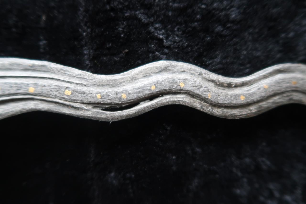

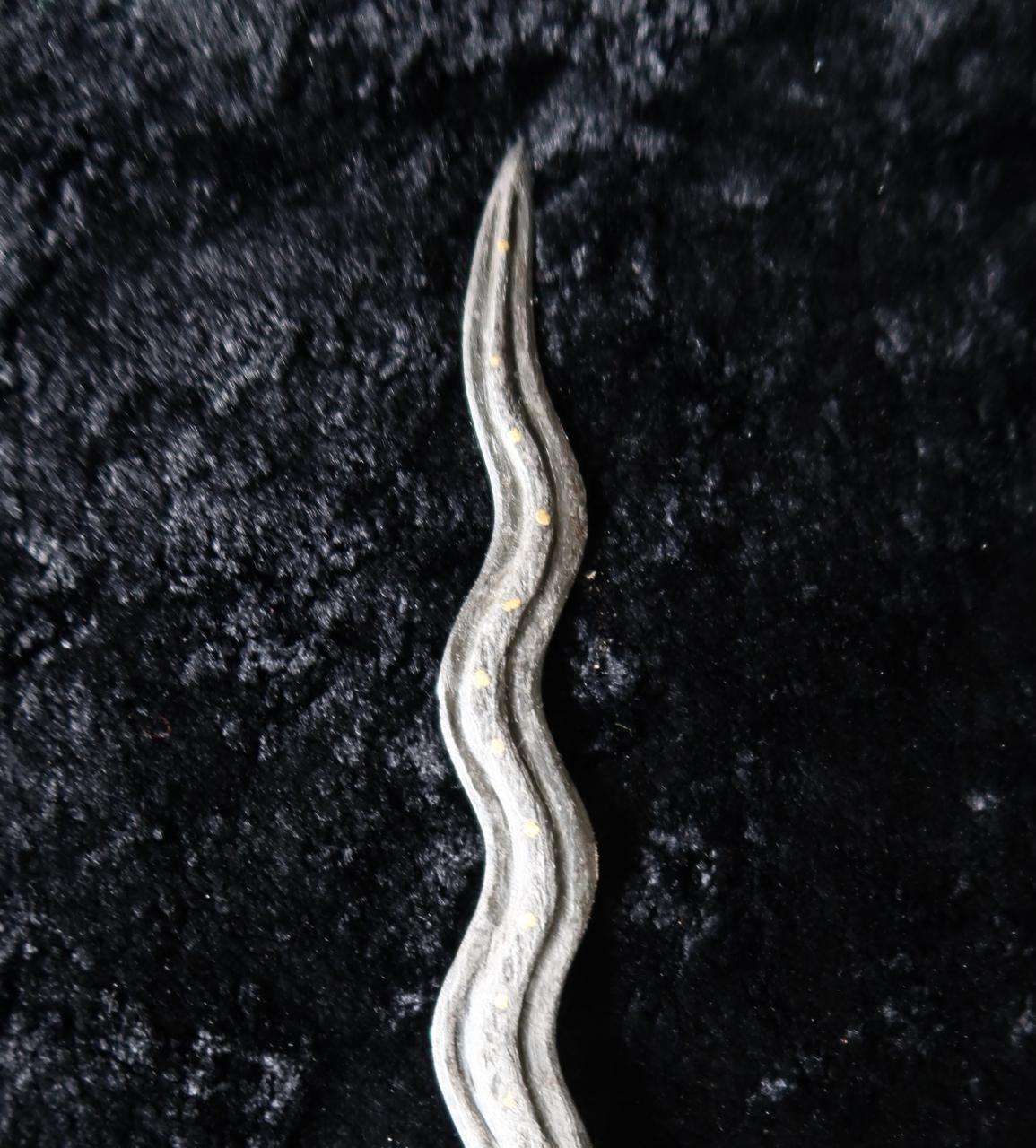

I cleaned my Keris from the dammar varnish today and this is how it looks now I took some images from the wilah. I also had in my spare parts a nice old silvered pendok for it.
The pamor is it Batu lupak or is it pamor kul buntet? I am trying to identify it but it’s difficult for me.
Hope some of the experts can tell me more.
Regards, Martin.

I believe most people would classify the pamor in the sorsoran as Kul Buntet.

Question
It doesn't look inserted to me, Alan.
To me, this motif at the base seems to be a part of the overall pamor (with much of it now lost to erosion).

I tend to disagree Kai, erosion and the necessary coldwork has taken a part of the swirl, I feel that this swirl might be continued into the pesi, & and if that is so, then that pesi will have been attached to the blade after the body of the blade had been forged, however, this is just a possibility being floated, because we cannot know that without seeing the pesi, especially under the gonjo.
In any case, whether the kul buntet was inserted as a swirl, or whether the maker was sufficiently skilled to create a swirl in one part of a larger motif, the end result is still the same:- kul buntet.
If it is a part of a larger motif, is that larger motif mlumah or miring?
Incidentally, on the subject of "insertion" of a pamor feature, in some cases we can form a hole, or even an impression in the material, & then lay the swirl or whatever into it, but it is also sufficient just to lay the additional piece of pamor onto the already forged material, then cover it with another piece of material that gets removed during the cold work.
