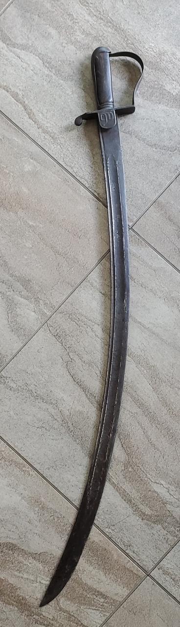

Default Sword Identification?
Hello; I was told this sword is from the 18th century. I think any of the markings maybe too pitted to see now. The handle appears to be wood as it has some small gouges in it. The blade is 24 inches or 62cm. There also appears to be the numbers 18 or 13 on the top of the handle.

Interesting saber, thank you for posting it here.
Its really hard to tell material from photos, while this appears wood, it might be horn.
The blade could very well be late 18th c. European, but the sword in its ersatz hilting seems of course very much later, into early 20th c. Its very common for old European blades circulating in colonial regions to be remounted numerous times.
The hilt is a common stirrup hilt type used by many nations in varying degree so hard to identify, but it reminds me of an Ethiopian 'gurade' in a sense and of early 20th c. Obviously the Lion of Judah is absent on this example, but the character of the hilt seems similar.

Welcome to the forum, Piratelady . How long is the blade ?

Posts: 6
Hello fernando, the blade is 24 inches. I am almost positive the handle is wood. It has some small gouges in it that a horn would not have.

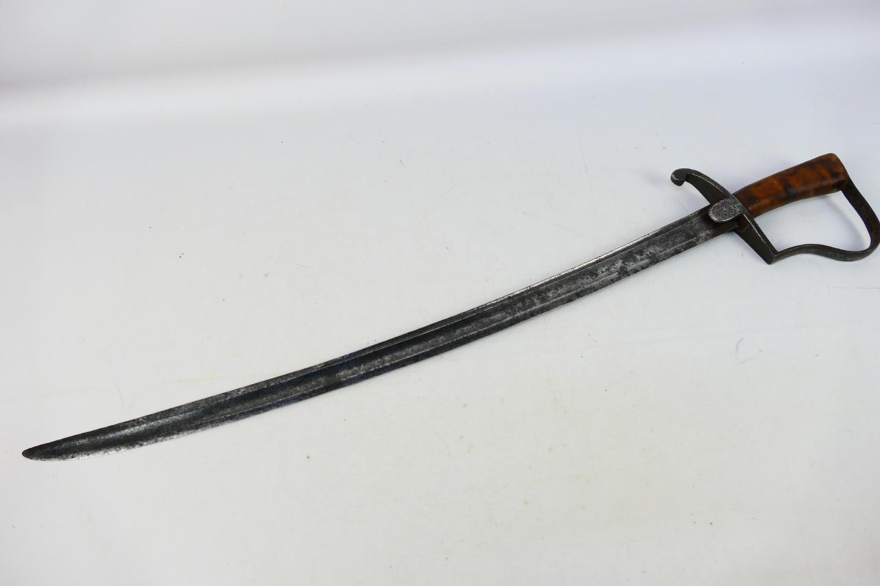

As Jim has aluded to, this is a sword is a composition of (some) original parts from different swords.
The hilt looks like it came from a German new model artillery sabre while the blade at first glance looks to be French in style, possibly mid 19th Cent. Without markings and blade diamensions it's difficult to be sure, but it looks similar to the types of blades seen on the French m1845 infantry officers sword.
See if you can see any reminants of engraving on the spine of the blade close to the hilt.
The hilt is missing the backstrap, grip tabs and pommel cap that would have gone with that guard and the wood grips are modern replacements. Looking at how the blade is attached to the hilt, and given the likely newer age of the parts, I would judge this to be a more recent marriage of parts, than a colonial era eratz sword.

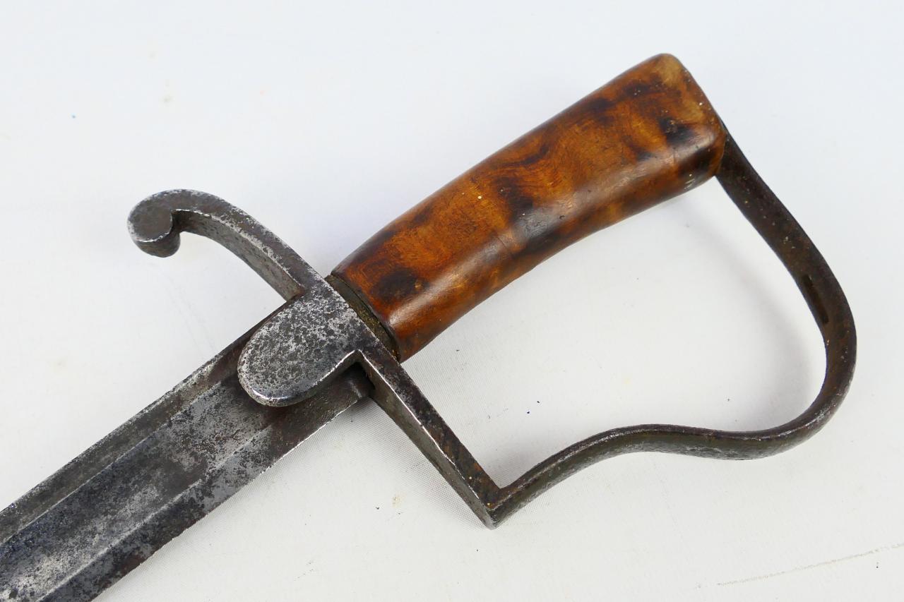

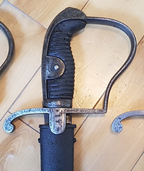

The hilt is most certainly a late version from one of the blucher m1811 family. Late because, as Jim notes it has the narrow langets. This style of sabre was in service with the German Army from about 1848 to the beginning of WWII. It has also been used by other nations (it might still be in service as a dress sword).
Of note is that there are no markings on the hilt. If it saw German service we would expect to see unit markings on the guard along the bottom of the langet. The number we see on the bottom of the knuckle bow is very close to the peen and on the original sword would have been hidden by the pommel cap. This points to it being a manufacturers number, later German swords like the IOD89 had individual parts numbered to keep them together during assembly or repair.

According to the article these photos are from, the main difference between the new artillerie sabre and the earlier ones is the removal of the hole for the sword knot sometime during WWI. As Jim has noted, the sword hole for the sword knot in this guard is smaller than the standard ones; this could indicate later production or service with another nation.

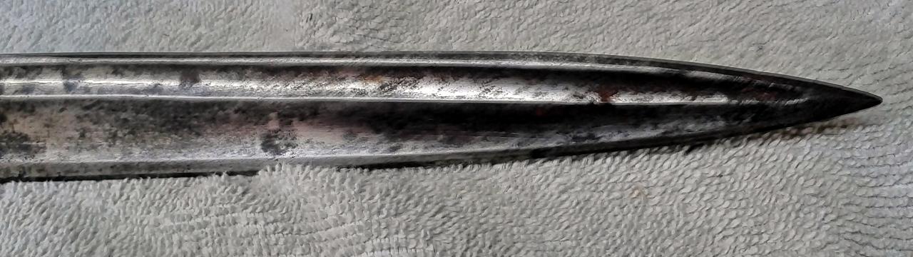

This is an interesting one. I agree that my first instinct was also late 18th Cent based on the fullers running to the tip. But the full length narrow fuller also reminded me of the m1845. However now that we know that it is very short, 24 inch, (about 60cm?) I suspect it could have come from a hunting hanger, or a blade that has been cut down. I’d want better photos of the tip before making a call on that.
Unfortunately, hunting hangers were civilian so came with a vast array of different blade types so this one could be anywhere from 18th Cent to late 19th Cent, we just can’t be certain without markings and better photos.
The grip.
This one is the deal breaker for me and marks this as a newer assembly, it’s too fresh for 19th Cent. There is considerable ‘patina’ on the blade and guard. With such neglect I would expect to see much darker wood with chips and cracks in it. None of that is present here. However it has been assembled with care and they have clearly been together for a long time, but we are now in the 2020’s even something assembled in the 1940s or 60s was 60-80 years ago, plenty of time for something to show signs of age.
All that to remind us to remember to apply Occam's Razor to these situations, when presented with multiple assumptions, the simplest is most often the correct one.
But while we are running thought experiments, I think this is a WWI era trench raiders knife / sword made from a broken French officers sword and a German hilt.

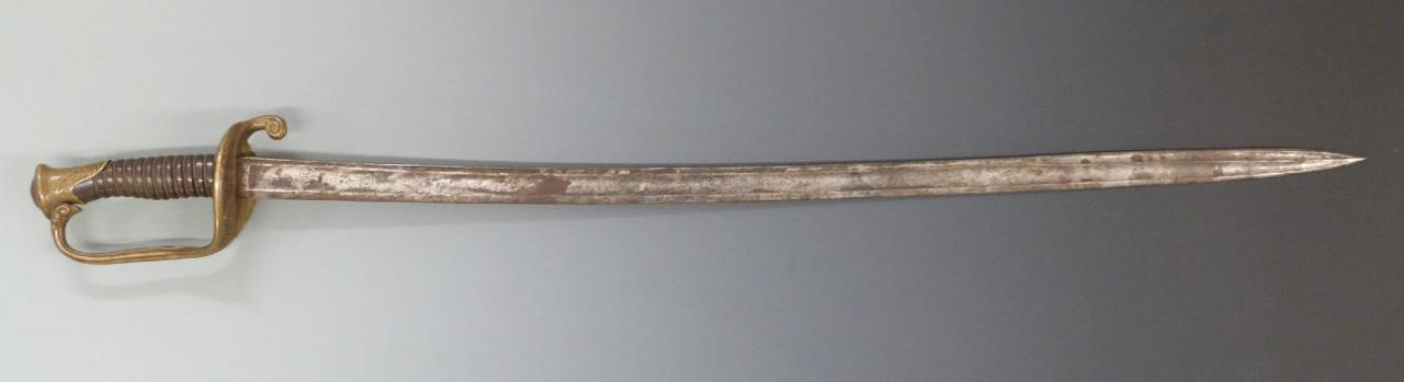

Originally Posted by Norman McCormick View Post
Hi,
... The M1845 French infantry sword has a quill point style blade which is very different from the posters blade. ...
My 1845 quill pointed Frenchy for illustration:

Thanks for posting your sword Kronckew, out of interest would it be possible posting a photo of the blade with a ruler showing the profile at the 24 inch mark?
The French m1845 I had the opportunity to measure had a 77cm blade, the posters is 60cm so it’s some half a foot shorter. If, and I mean that is as possibility not a statement of fact, it has been shortened then the quill point of the m1845 is irrelevant.

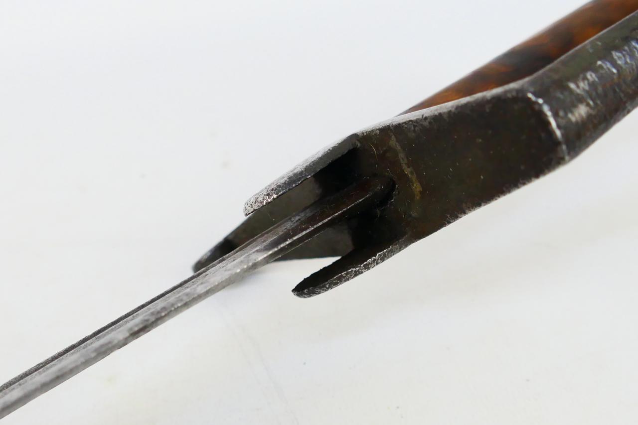

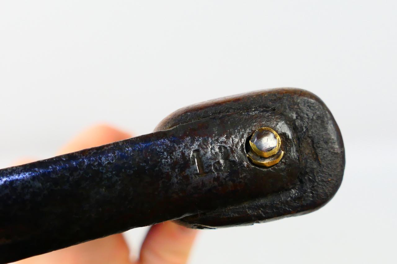

The peen is very clean compared to the rest of the sword and looks quite recent. So either the assembly is recent or the sword has been re-peened in the not too distant past.
Hi,
It looks like someone has cleaned an area to reveal the numbers and in doing so has rubbed part of the peen. The peen does have an area of patina left so I still don't think the assembly is too recent.
Norman.

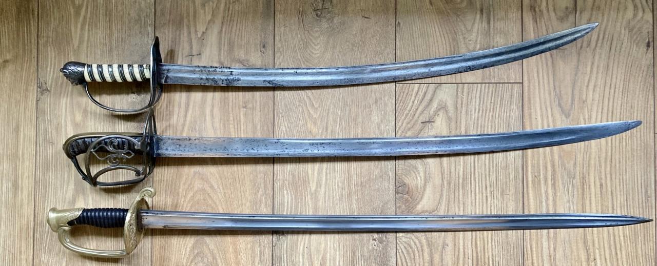

Hi,
Attached photo of a Silver Hilted Hanger C1775, a French Petits Montmorency C1778/82 (I.D Musee De L'armee), an M1845 French Infantry sword. The posters sword blade has a large fuller extending all the way to the tip and the smaller fuller terminating approx 2/3rds of the down from the hilt similar in all ways to the Silver Hilted Hanger shown. In the Petits Montmorency blade the large fuller is much wider and terminates before the tip, these features are also evident in another Montmorency blade I have. The M1845 has a small fuller which extends to the tip therefore if a cut down blade of this type was used the small fuller would also extend to the tip which it doesn't do on the posters blade. The 1845 blade is also actually relatively straight which to me doesn't equate with the mild curve on the posters blade.
I hope this shows a bit more clearly my thinking re the blade.
Norman.
It’s something that bothered me about the peen earlier. The area around the end of the knuckle guard should exhibit less pitting than the rest of the guard. Since it would originally have been covered by the pommel cap and less exposed to the elements. Now that I look closer, it does look like the metal is marginally cleaner than the rest. However the bad lighting on the picture makes it difficult to be conclusive.
At least the pitting inside the No. 13 appears to be consistent with the surrounding metal so it is likely original to the blade, re-enforcing that it’s a manufacturers’ mark.
I agree with Werecow, the peen is significantly brighter than the surrounding area (as is the brass insert) and I don’t see any signs of polishing around it to suggest the area has received any additional cleaning.
Hi,
I still think someone has tried to reveal the the numbers more clearly by cleaning as the proud areas around the numbers have lost their patina but I guess we will have to agree to disagree. Perhaps the poster could clarify as to whether they got the piece like this or they attempted to see the number better. Where the tang button is slightly below the level of the backstop it still has patina. It seems obvious that this sword has been constructed from disparate elements but whether to deceive or to use is anyones guess. I reckon though that if assembled to deceive it was a poor choice of guard. Many of the German states used this type of guard throughout the 19thC and into the 20thC for Artillery/Cavalry swords etc., although the later ones almost always seem to have plenty of stamps for I.D. To choose a recognisable guard style that does not match the period of the blade seems odd if to deceive was indeed the aim so perhaps it was cobbled together for use, who knows.
