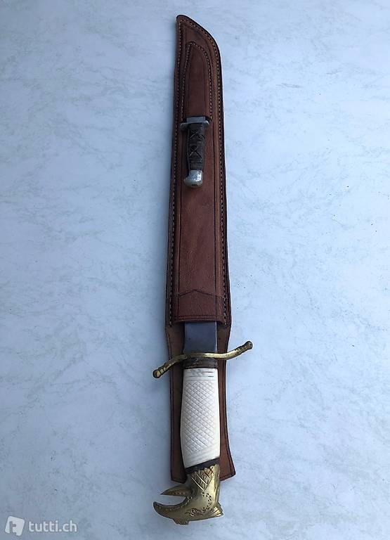

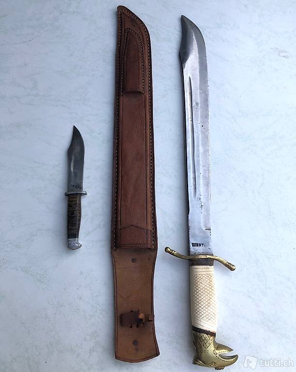

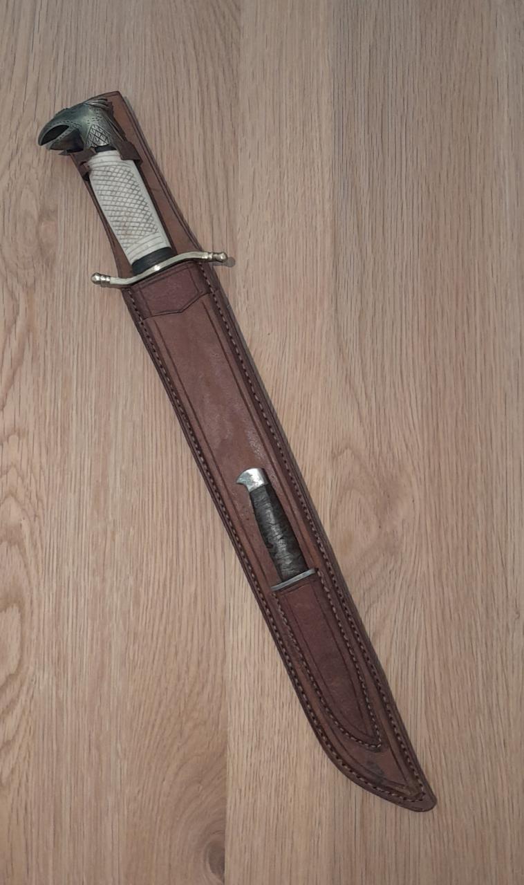

Good evening dear members,
I'd like your advice about this large knife/small machete ,
21,65 inches long ( without scabbard )
He comes with his ''small'' side knife,
looks like a xxl bowie knife with a latino american style
( I find...)
Maybe antique ?
Can you help me to fix it ?!
Kind regards

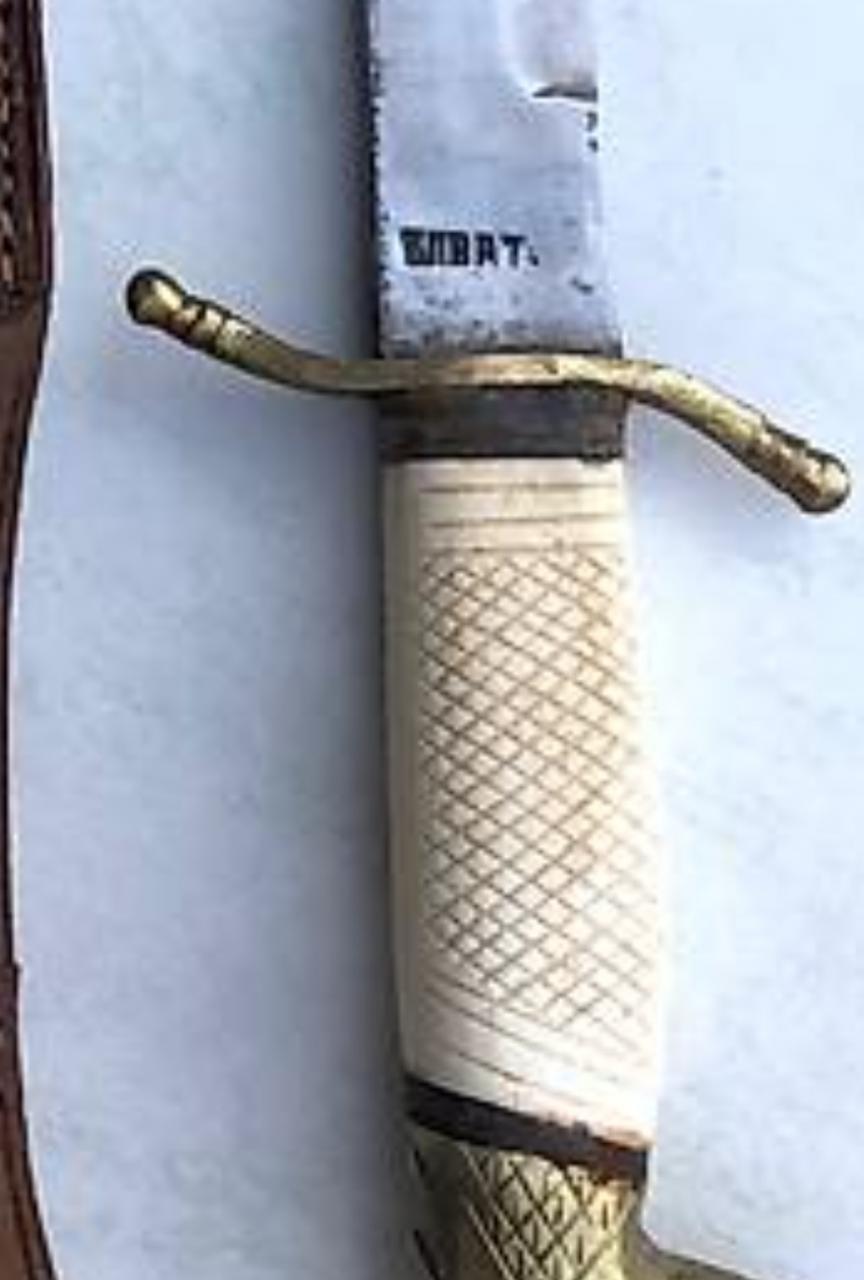

it certainly has a Mexican type of look.

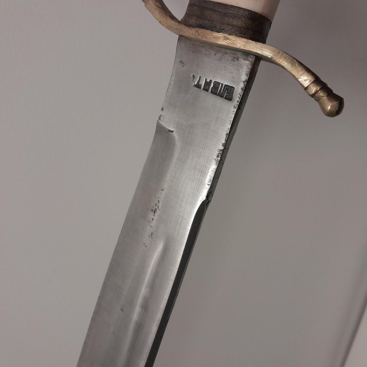

The eagle head pommel is a very common feature. The giveaway would be (if someone recognises it) the punch stamp which loos like ENBAT? EMBAT?

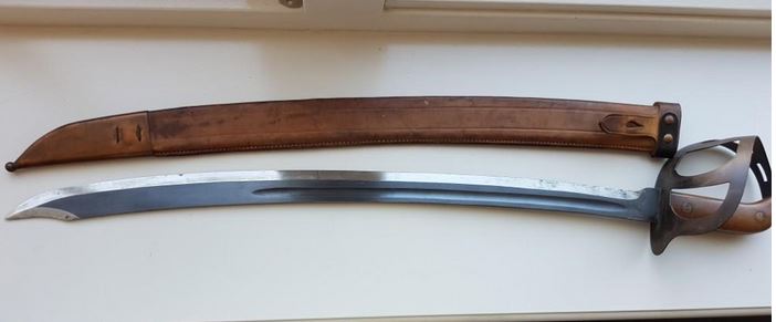

Interesting how much that blade resembles a short version of a klewang.

the clip point and the fuller do look similar and I have been also thinking that I had seen the pommel on some Indonesian made weapon , I think that the key to identify is in the identification of the punch stamped mark.
Please make a beter picture or ask for one
IF this is Indonesian made then it is probably Tjikeroe
if you look though this thread
http://www.vikingsword.com/vb/showth...ight=Tjikeroeh
You will find some similarities

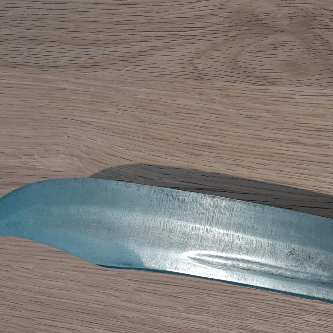

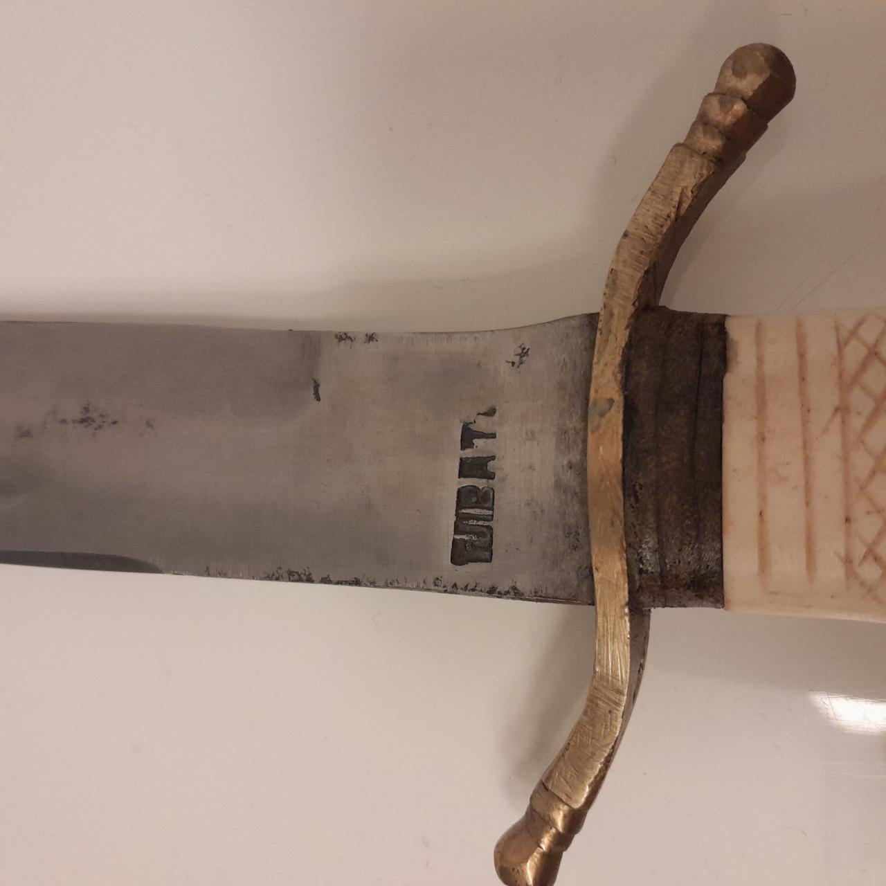

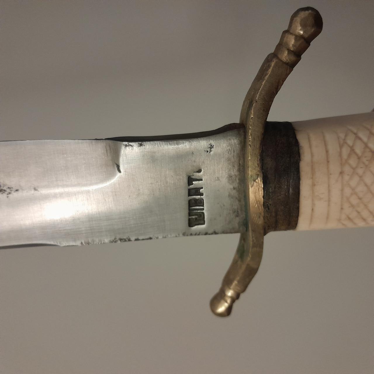

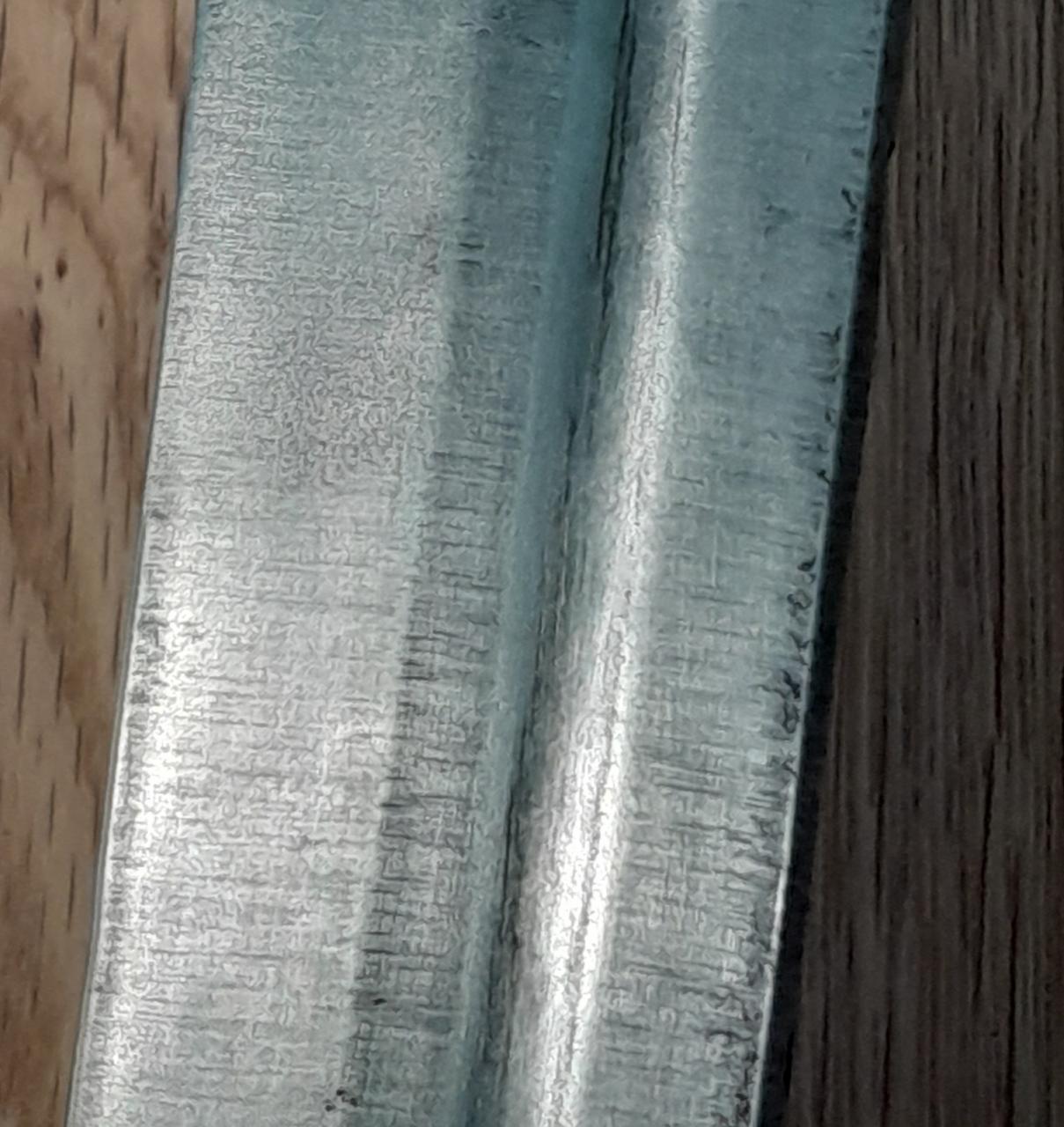

Hello everybody,
The Indonesian with Dutch influence clue seems the right one ,
Here are the other pictures I received,
I can read TIJBAT,
TIJ for Tijkeroe as proposed by Milandro ?
Marius66 is offline   Reply With Quote

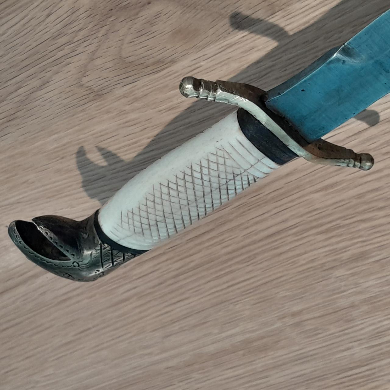

Join Date: Jun 2019
Posts: 131

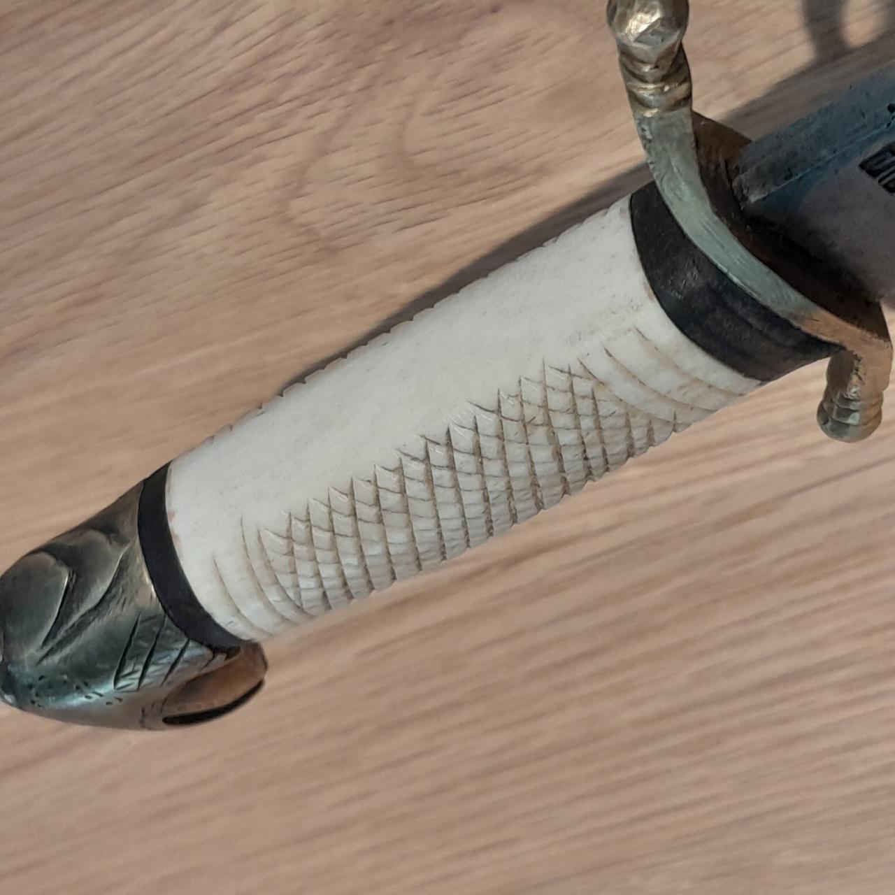

And the bird head pommel clearly looks like the Batavian model linked , thank you !
A garuda head ?!!

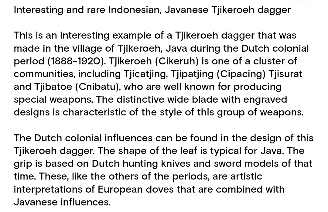

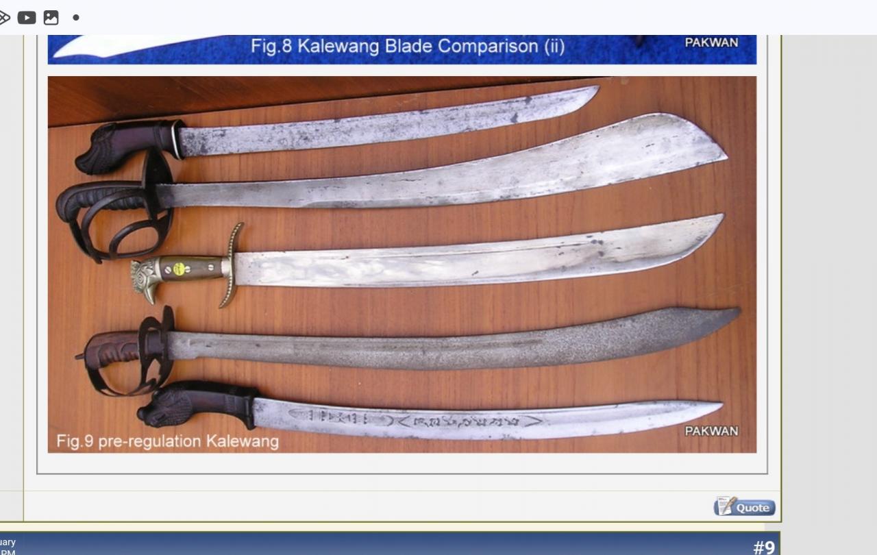

For comparison,
I found this ''similar'' one , the central piece , in another old post about klewangs/kalewangs and the regulation models

Posts: 973
TJIBAT simply for TJIBATOE... 😁
Old 26th October 2023, 08:16 AM   #14
milandro
Join Date: Jan 2022
Location: Netherlands
Posts: 500
thanks to the better pictures and the detective work on Tjbatoe look very conclusive to me.

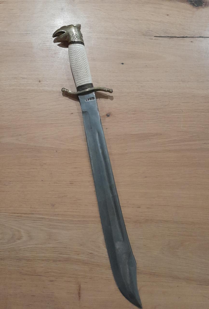

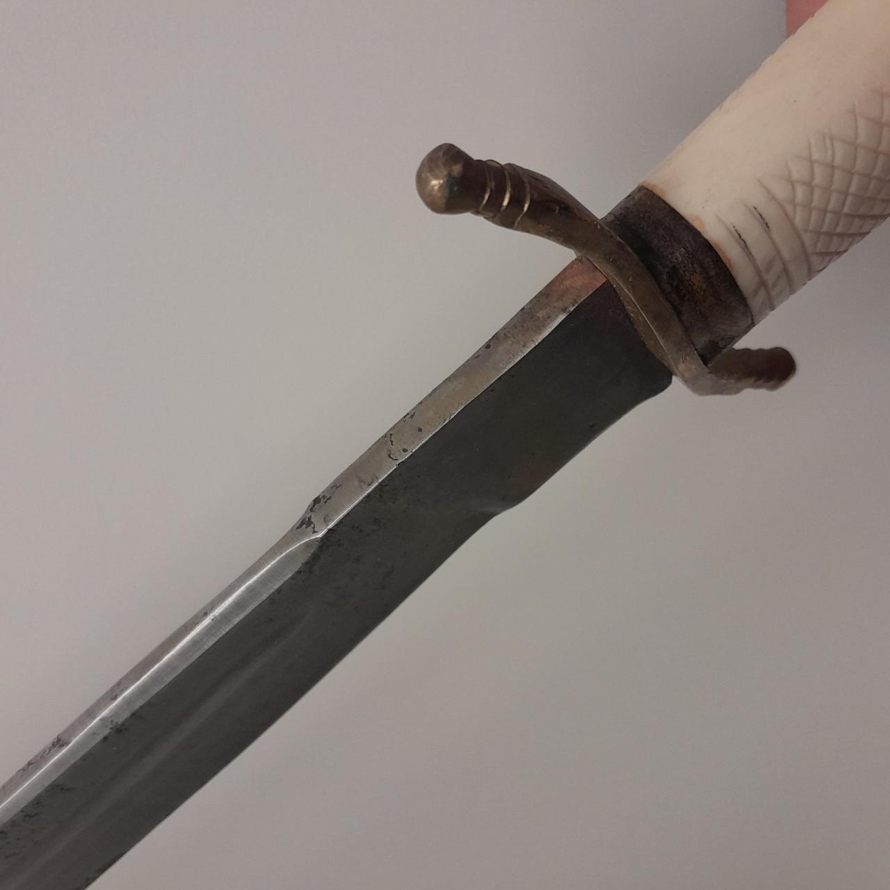

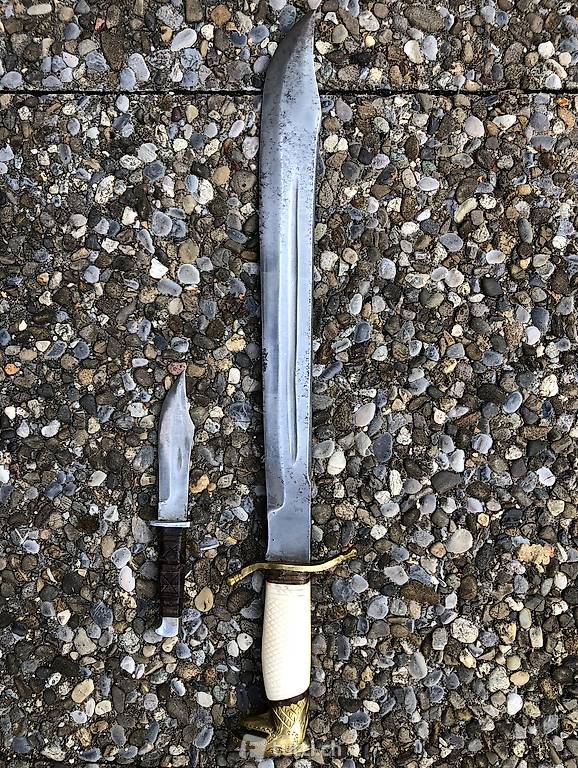

I finally received it,
Here some pictures, an heavy model, 800 gramms
/ 1,75 pounds just for the small sword/machete .
For the dates , I read that these ''VOC dutch models'' were made until 1920 but sure, it looks more something WW2
( reminds me Aldo Raine's bowie knife in the movie Unglourious bastards... )
The steel is good

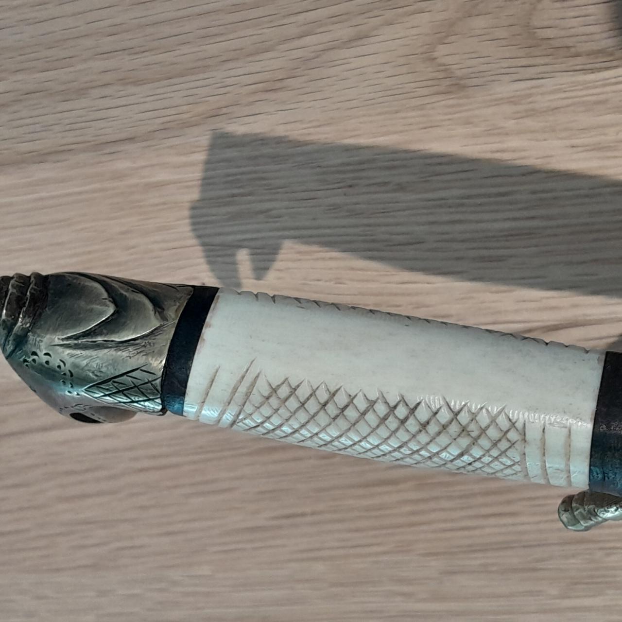

I wonder if the handle is more bone, ivory or any celluloid...
One side cracked when I cleaned it with just a little water/soap
