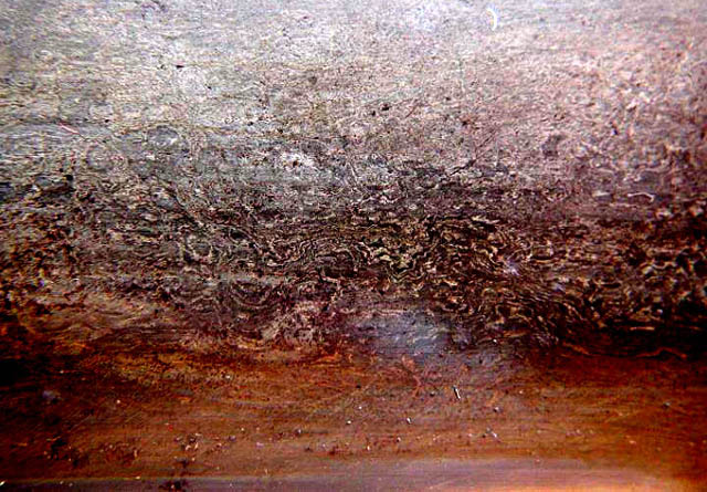

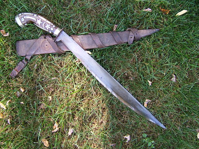

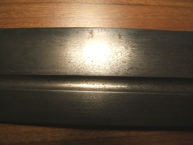

Ibeam was over at my house today to have me etch some of his swords. He pulled out an old Luzon bolo which he thought he saw a wootz pattern in the blade. So I did a light etch and to my amazement it was wootz. I figured the bolo must have been reworked from an older sword I don't think the Christian smiths made wootz in the late 1800s.

Any chance to get better close-ups?
(I know, wootz is a pain to photograph! )

I agree with Kai. I must admit i don't really see Wootz in this photograph.

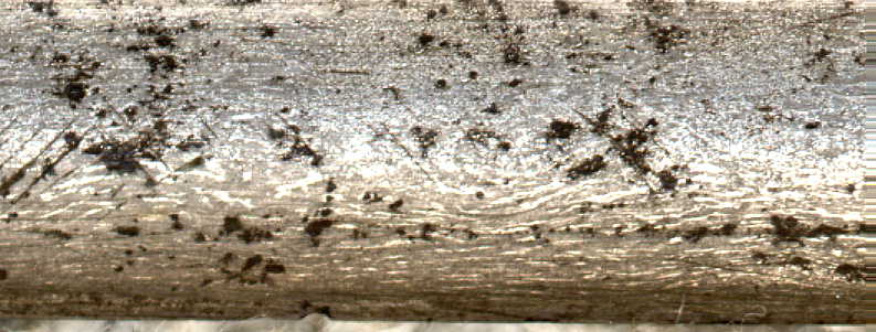

I don't have the sword anymore Ibeam will have to post better pics but it is most definately wootz I did a side by side comparison with some of my wootz pieces and his sword showed a nice pattern. It was real hard to photograph the wootz pattern. I tried sharpening the current close up but the file gets too large for the website to take. Nechesh I can email you a sharper pic if you would like. OK here is a link to view a better picture of the wootz pattern.
http://img.photobucket.com/albums/v1...tphotos012.jpg

I can sort of see a pattern of something, but the pics are less than convincing. Even so, assuming this is wootz, it is a very unusual finding on a distinctly Filipino sword from Luzon -- I've not seen another example. The sword blade is definitely a Filipino pattern ("matulis"). The hilt and scabbard suggest c. 1900 or a little later, perhaps a Katipunan piece from the symbols on the hilt.
Possibly the most likely source for a wootz ingot might have been via the Muslims in the south of teh Philippines, and their contacts with other Muslims in Malaysia, India and Arabia. Perhaps something brought back from the Haj that found its way into the hands of a Christian Filipino.
Intriguing piece if it does turn out to be wootz.

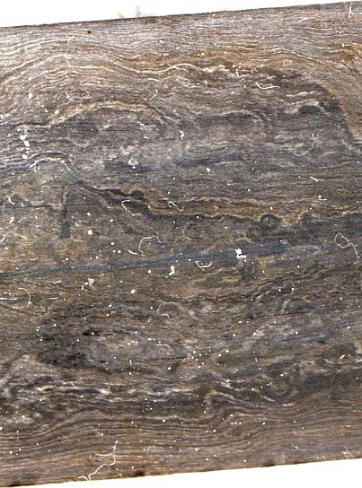

Thank you All,
I tried to take a close up of the blade and here it is. The clean smooth steel in the bottom of the picture is the blade edge. Most of the patterning happens just above this hardened edge.
Thanks Lew for posting the sword.
