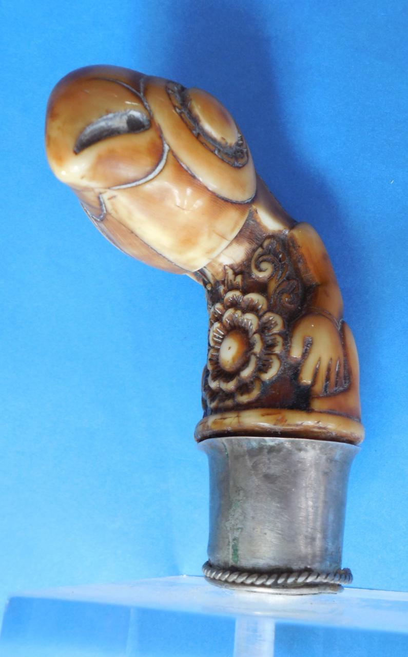

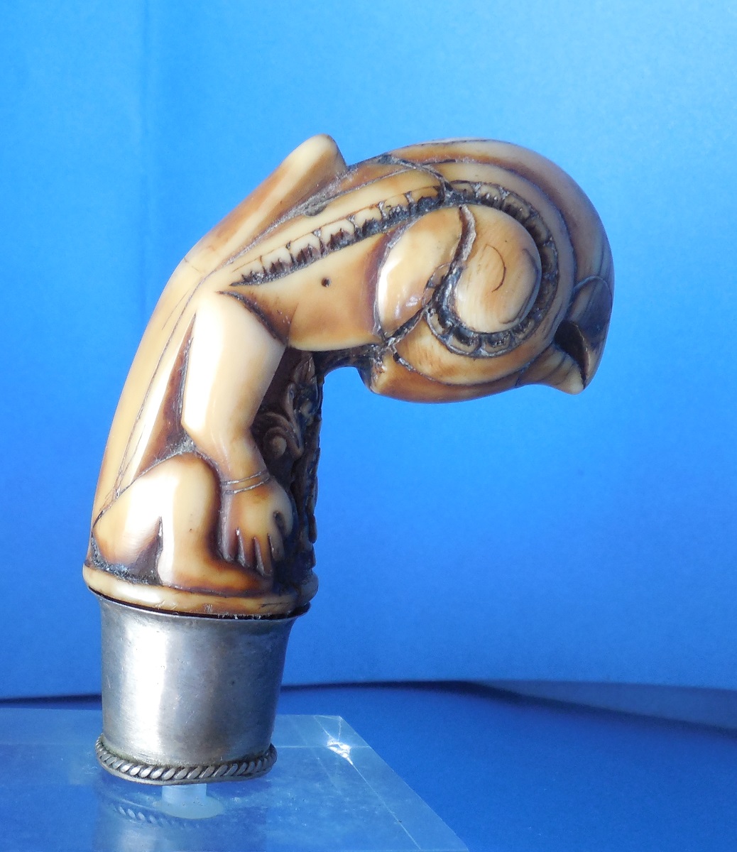

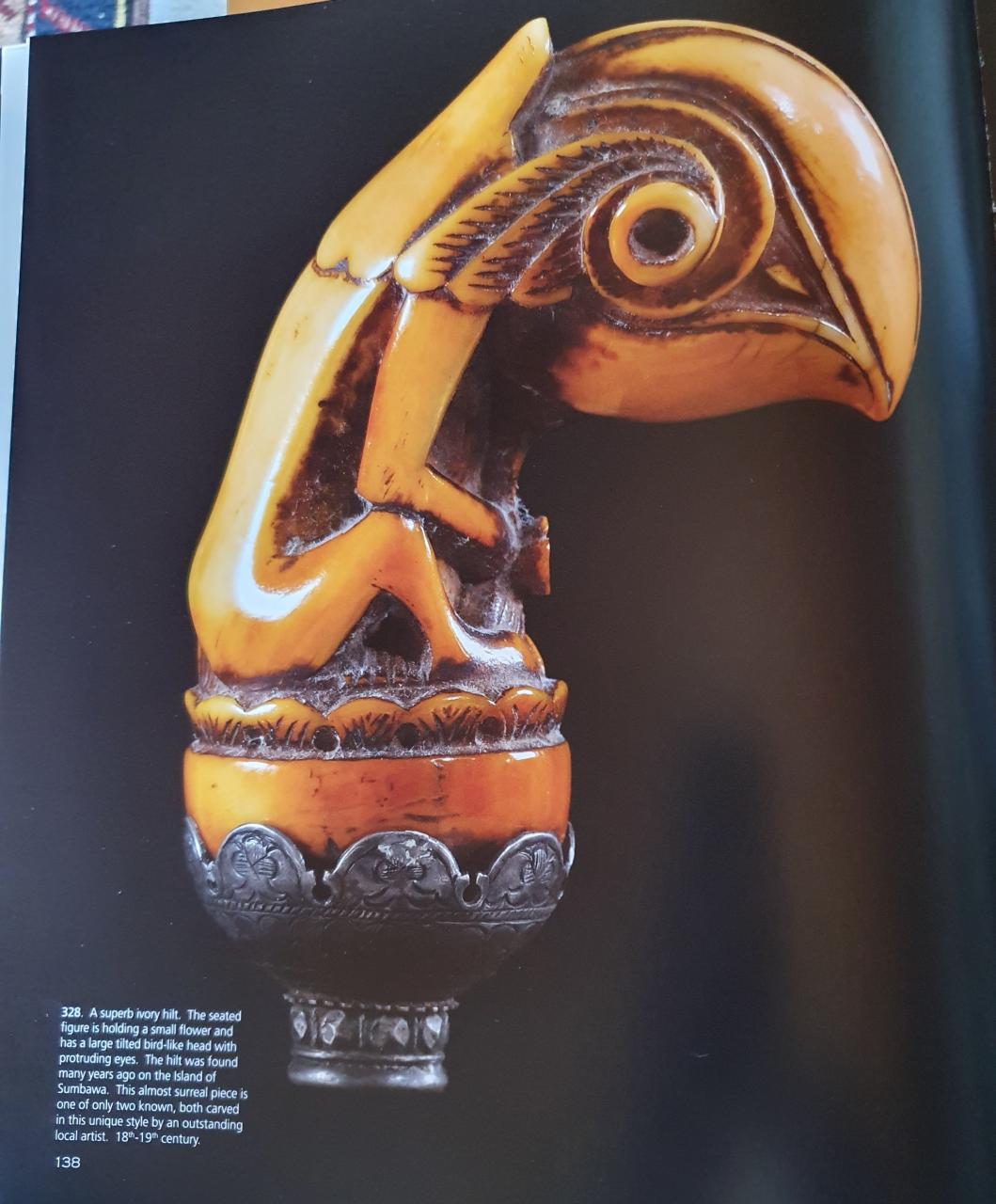

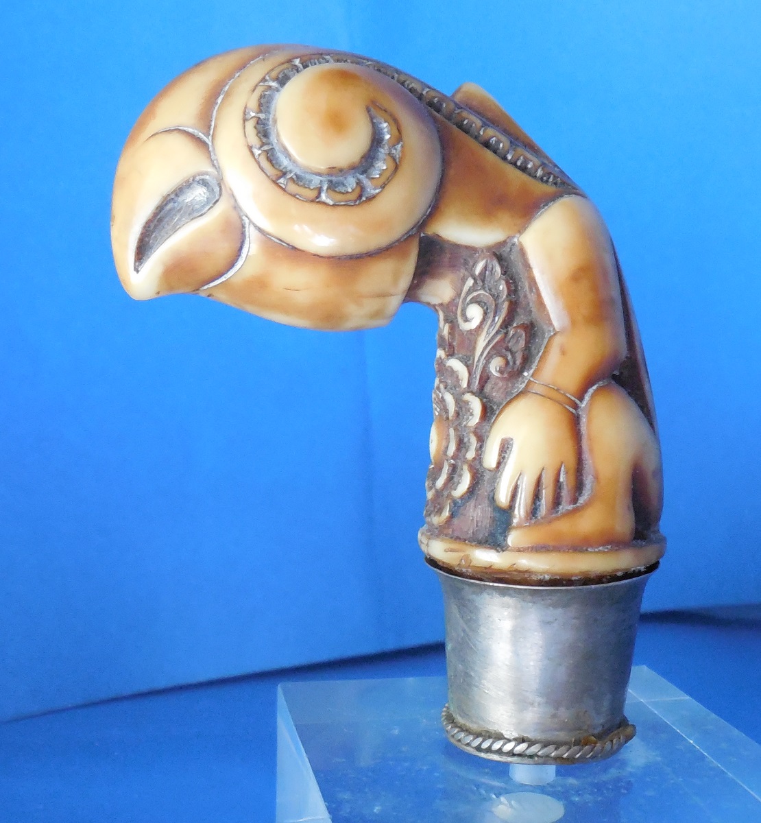

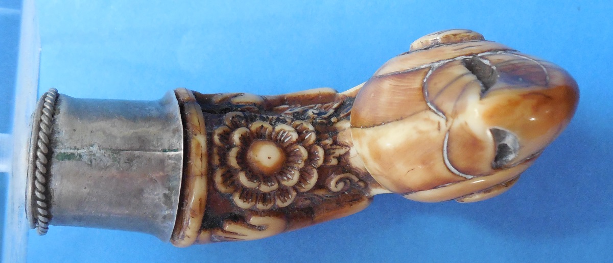

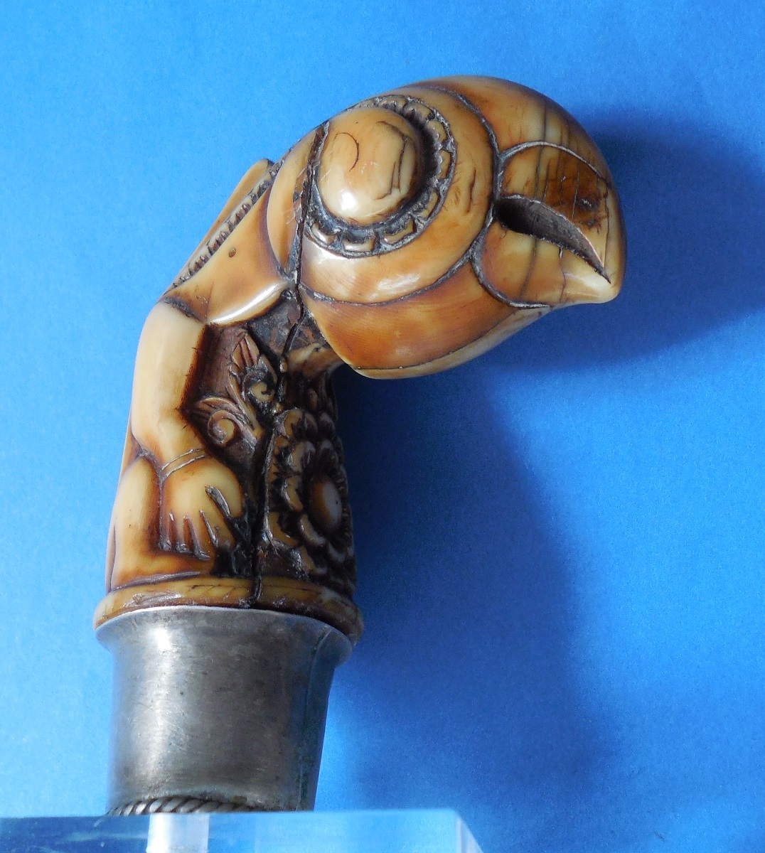

This (sea?)ivory handle is from the collection of a well known collector in Germany. It's IMHO a very nice and unusual handle but is it indeed a keris handle? A comparable handle is shown in Bob Hales book, page 138, pic. 328.
He writes that this is a keris handle from Sumbawa, Bima and that only two handles of this type are known! Anyway, would you agree with the origin? Approx.: 7 cm high.

Here the hilt from Hales!

Detlef,
I think I know the other hilt Hales mentions. Interestingly, the Pendokok on his example annd the Selut on yours isn't much like something from Sumbawa.
Thank you Gustav,
I have the same thoughts regarding the pendokok and selut. But both don't look original to the hilts IMHO. Can you share where the other example belongs to?

BTW, the hilt in question looks like hippo ivory to my eyes.

I do not really understand what is meant by "--- of this type---".
Over the years I have seen & owned keris hilts of this type, but not of the same execution nor material, as the ones shown here.
I am not able to offer a supportable opinion on geographic location of origin.
Is it a keris hilt?
I think probably yes, reason being that I have seen others like it, but as I have said, not the same execution.
It is probably not possible to give a solid opinion on whether or not this hilt was intended as a keris hilt unless one could actually have it in hand and form an opinion on whether or not it works as a keris hilt. It might be a hilt intended for, or adapted for use as, something else.
Are there any patterns of wear visible?
