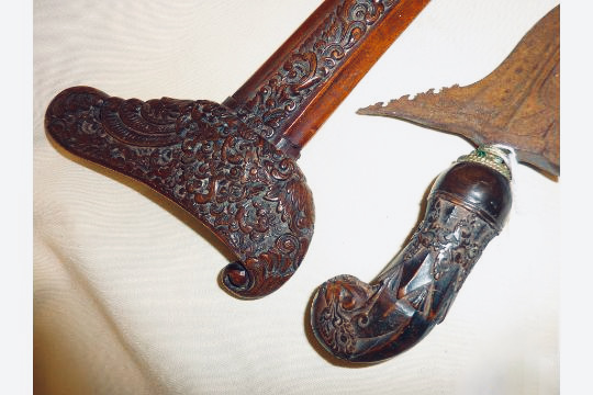

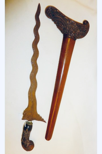

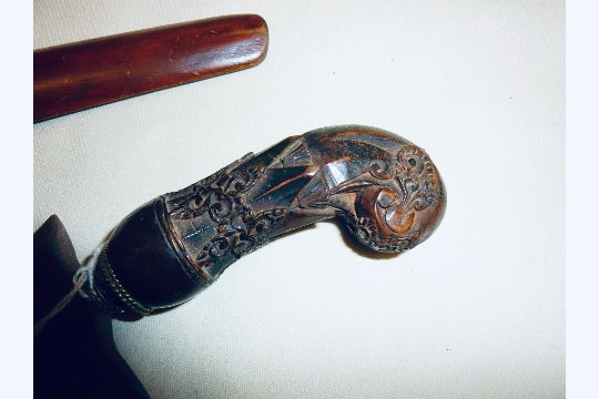

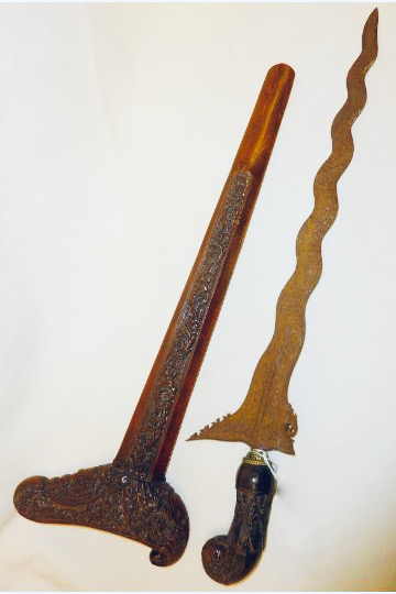

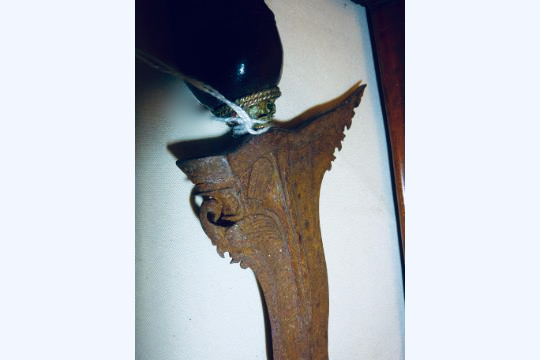

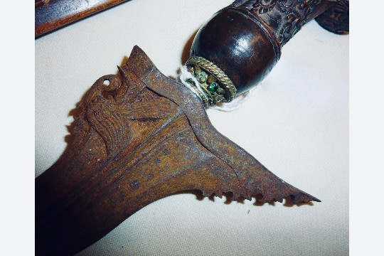

This is a recent acquisition. Keris are not my area of collecting, though I have the inevitable handful of items included as secondary pieces in auction lots, but this one caught my eye.
I'm afraid I only have the poor quality auction photos to share at the moment.
I would of course be interested in any information the knowledgeable might be able to share, but my primary request is for thoughts on how I might sympathetically restore the blade. Normally I would approach it carefully with a little oil and either 0000 steel wool or 800/1000 grit paper, but I suspect that is not the best approach with a pamor blade. Being UK based any products suggested would need to be UK available.
I would be grateful for any knowledge and suggestions shared.

I actually completed the vinegar cleaning of three pamor pedang blades yesterday, I brought these back from Bali 9 or 10 days ago, and they were in heavily rusted condition, it took 4 days of exactly what is in the below cleaning instructions to bring these blades to a condition where they can be stained.

I would add that this is a Maduran blade and sarong and that the hilt is showing in the opposite orientation. Its is normally (or it should be) only friction mounted with some cloth inside you should be able to gently ease it off and then when finished with cleaning put it in the right way.
