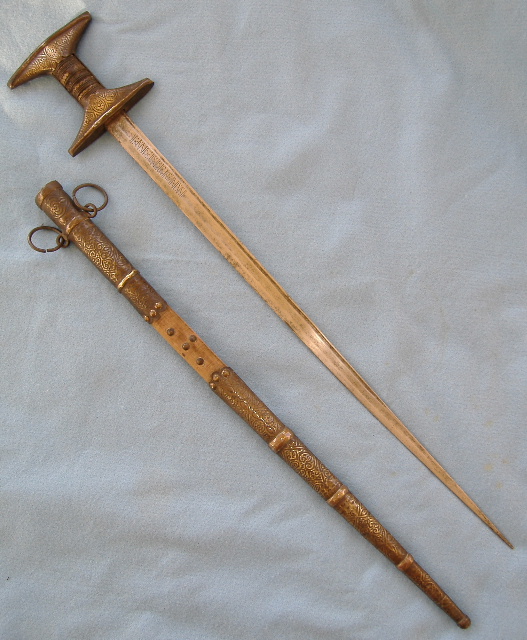

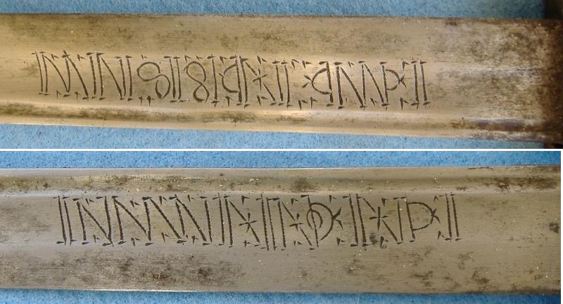

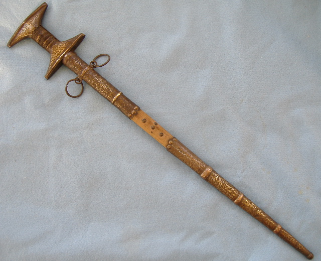

This sword has been attributed to Africa from Morocco to Ethiopia. Personally, I think photographic evidence strongly suggests Morocco, and I believe this form has already been the subject of a previous thread.
But, check out the inscription on this one. This example has the thickest, heaviest blade I have seen on one(though I have seen only 4), and I have never seen an inscription of this nature on anything.
One forumite has already suggested to me privately that it may have been a crude attempt to mimic a European inscription in a practically illiterate manner. I can understand that theory when you consider the prestige of European blades in much of that part of the world.
Any ideas??

Very nice sword! Here is a link to the Berber alphabet, just as an option to consider. To me, there is no resemblence, so most likely it is an imitation of text in Latin:
http://www.omniglot.com/writing/tifinagh.htm

Amazing Charles! Once again the mysterious 'Zanzibar sword' arises. This has been the topic of not only previous threads, but debates and the equally mysterious paper, written by me in 2003 and presented in a talk at the Baltimore dinner. Mark, please help me out here OK, I do not have access to my notes or transcript of the paper.
Anyway, this particular sword came up in a double header fray during the Baltimore event with Tony Tirri who insisted these came from Ethiopia (the other was the notorious BSY which he claimed was from North Africa, and we have remained at odds it seems, ever since).
These have come up many times over the years, and typically I recount my findings which basically note that these 'Zanzibar' swords were captioned as such when Sir Richard Burton used the illustration and description from the earlier work published by Auguste Demmin. I confirmed this by finding a copy of the 1877 book and viewing the entry which called it a Zanzibar sword. Charles Buttin noted the error in his notes which were published in the catalog of his collections in 1933 (posthumously by his son). In that publication he illustrates these and termed it a s'boula, which I discussed with Dominique Buttin several times over several years. Since Charles lived in Morocco for decades, he was well aware of the weaponry there.
These curious H or I shaped hilts seem to have evolved indirectly from the European side arm known as the baselard, though direct evolution or development cannot be effectively supported by examples as far as is known. It does seem plausible that this form of weapon accompanied the many others that entered the North African littoral through trade over many years.
The Ethiopian attribution does have some basis in that there have been from one to several known examples from there (one appeared in a grouping of weapons in a monograph on African weapons many years ago). I addressed this in the paper also by suggesting that these probably came to Ethiopia across trans Saharan trade routes, where they probably entered the armouries of the Amharic rulers. The weapons for these rulers were provided by the Falashas, Jewish tribe in Ethiopia who were also known as blacksmiths there. I believe that there was contact between Jewish artisans in Morocco, who also furbished daggers and weapons and the Falasha, though this idea would need more research to be supported.
From this point, trade likely carried some of these s'boula to the key trade center of Zanzibar, where it seems likely the attribution may have derived.
In reviewing some of the previous threads over the past several years via search, there have been some most interesting examples and discussion brought in.
I agree with Teodor on his observation on the Berber alphabet, and just wanted to add the history lesson to support what you said on Morocco!
All best regards,

Amazing thing
If you invert (mirror) one of the images, you will find that some "characters" look alike .

Default clever
You are quite the whiz with the computer images Fernando. Great work.

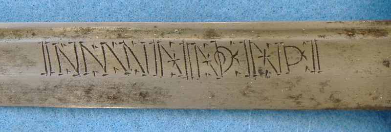

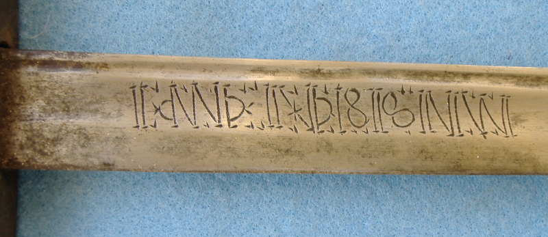

This may be a stretch, but I was browsing through the alphabet site a bit and it looks like the inscription has some features of Loma (Liberia):
https://www.omniglot.com/writing/lomasyllabary.htm

Wow!!! So close! How did you stumble across this writing system? I tried to transliterate this inscription both as posted and inverted. Neither quite worked but it was close. That is a complicated syllabary.
It could just be pretty lines for spiritual power? A nonsense Latinesque inscription to add value? An older/newer version of Loma, or related language? The mystery continues...

Loma script on blades mounted in Morocco sounds fascinating, but unfortunately also totally improbable. The sboula that started the thread is probably from the end of the 19th century or early 20th century, predating the Loma script. Even if you somehow can get past that, why would anyone in Morocco inscribe a blade in some obscure Trans Saharan language and not Arabic?
I still feel that an illiterate smith/engraver putting something that visually imitates older European marks is the most plausible explanation. The vast majority of Sboulas (and Genouis) are from cut down European blades, and any local production apparently needed to at least look like the imports in order to be marketable.

You're probably right that it isn't Loma, but I think we should be a little cautious before we assume that this is simply a meaningless imitation of European scripts. It's certainly a possibility.... but is it possible that Loma was derived from or inspired by an earlier form of writing from the general area that is a better match in symbols, time and space? It seems unlikely that it was just invented out of thin air. Unfortunately searching omniglot is not entirely trivial. Do we have any historical grammatologist around who specialized in 19th century North-West African scripts?

I am inclined to believe that the script on this blade is an imitation of Latin writing mainly because of the use of Sarif (winged) lettering, or an attempt at it. The blade smith stamped in wings that hit and miss on the letters. An interesting marketing ploy to give a product an unqualified provenance of quality, which continues to this day.
