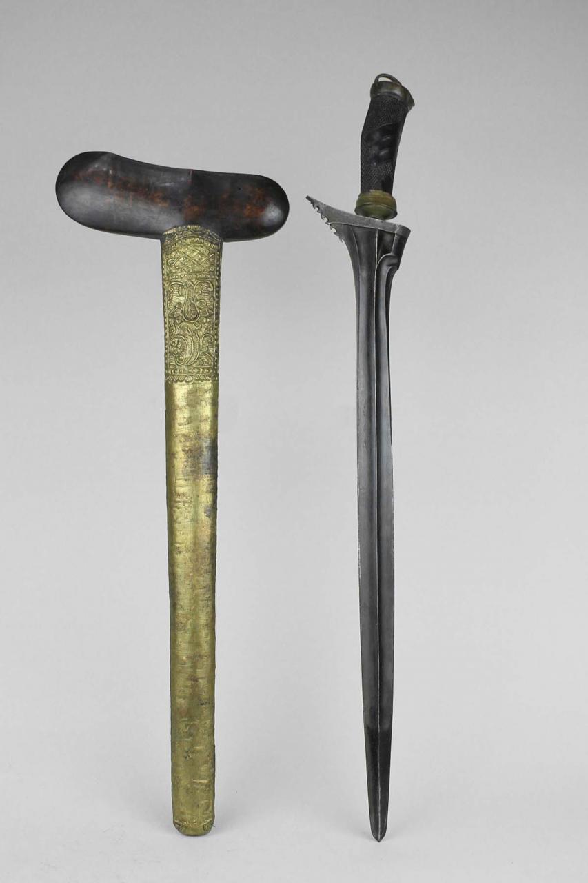

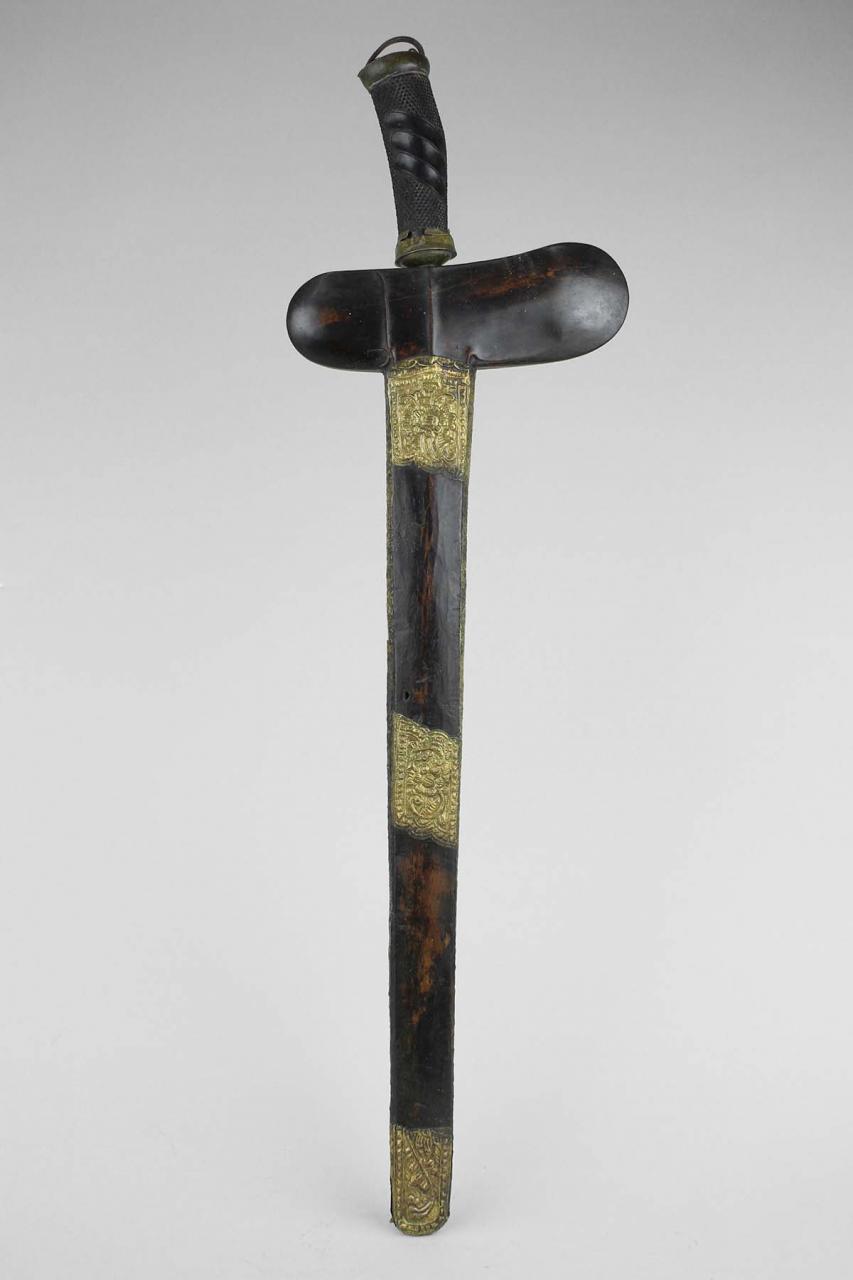

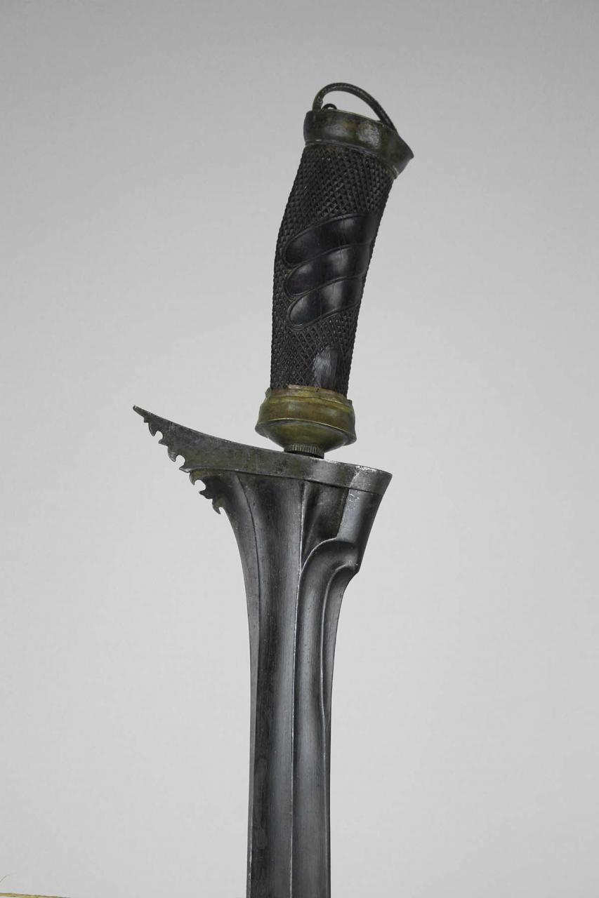

I purchased this large keris from Artzi, not yet arrived. The gerantiman hilt with grip checkering and long 52cm heavy blade seems to be intended for saber grip providing some slashing capacity despite the blumbangan. As with my other Balinese keris, the hollow edge stops short of the tip, leaving it thicker. I've seen it suggested that is reinforcement for piercing, though I am skeptical. It appears pamorless which I understand would be unusual in a Balinese keris. I'm not sure about Lombok. The sale page indicates early 20C but I wonder if it might be a bit older. What dhapur is it? Any comments and observations would be very welcome. Photos are from the seller.

Hullo JeffS!
To me, it's a Manjeuseup Leres (sunbird, straight blade), following a pakem that goes back to at least 15thC.
This may be of interest:
- if the blade length >42cm., it's a sandang walikat (worn over the shoulderblade)
- if the diameter of the tang base >0.72cm., it's a tjorok (doubles as emergency sword)

A beautiful, well made blade. As Amuk pointed out, it follows an archaic form.
You had luck noticing (or being noticed about it) early, that was a good catch.

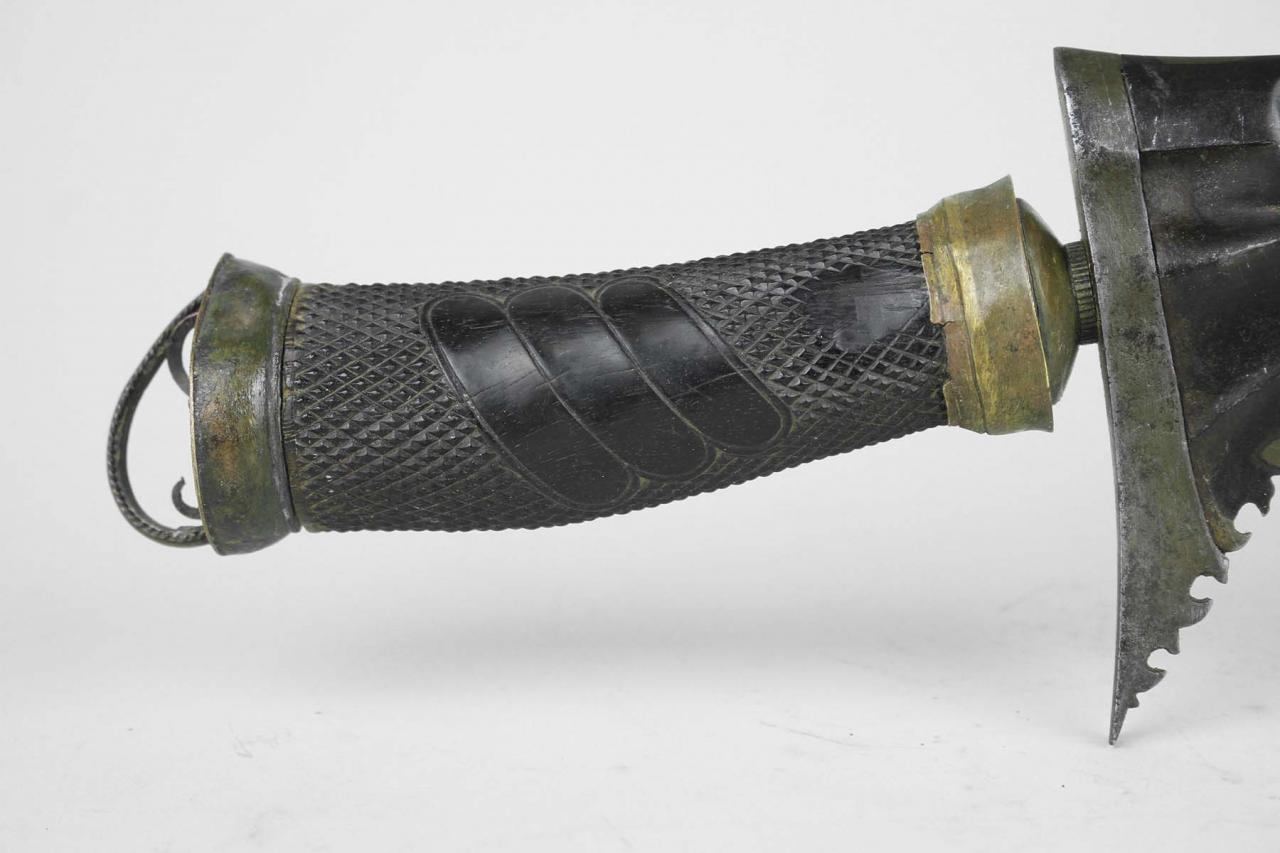

Interesting little depression on the handle; for the thumb perhaps?

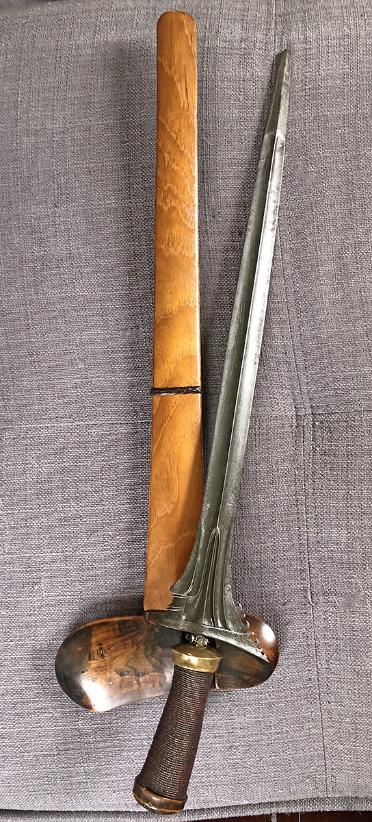

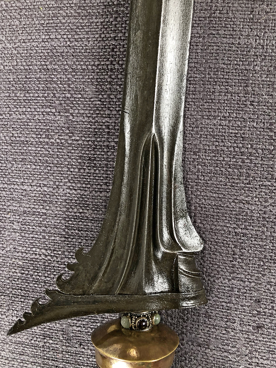

I do have another Bali keris that is pamorless like yours (Rick, you may recognize this old friend ). While the dhapur is somewhat different (unlike yours mine has sogokan, kembang kacang pogok and lambe gajah) this keris does have the same over all profile along the length of the blade that bellies out slightly in the middle and it has a similar termination at the tip.
I could be wrong, but i suspect that pamorless blades like this may well have been produced more specifically as a fighting blade rather than for status.
Please forgive the low quality quick cellphone photos.
I don't think so, Rick: While the edges are worn smooth, the surface of that depression is not really smooth. Thus, this looks like an damage to me that happened during the active life of this keris.
Having said this, I'd estimate the fittings to be from the 20th century; the crosspiece might be a tad older than the rest.
Agreed it appears rough and unfinished. However, being located inline with the blumbangan and the orientation (thumb would be aligned with blade), as well as the thumb-like size and shape, make me wonder if this was a later modification to allow a similar grip as when choked up on the blade (to support thrusting). I am curious how this grip would feel while holding the keris.
I don't know, Kai that depression in the handle looks pretty smooth to me, especially looking at the Seller's pictures, I think I must disagree considering the length of the blade.
