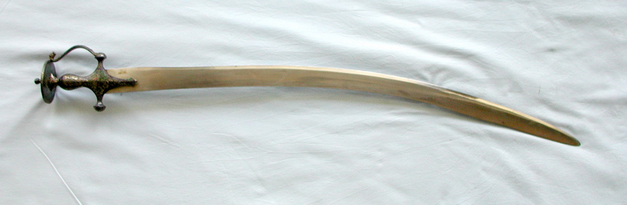

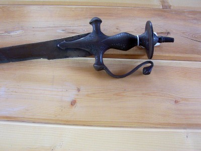

One interesting thing about swords are, that they were inherited, and when sharpened often. Have a look at the attached. At the base it is half a centimetre broader than at the curve. Normally the blade would be as broad at the base as on the curve, but not here. So this indicates to me that this blade may be a lot older than the hilt.
Old 24th January 2009, 08:55 PM   #2
Posts: 10,867
Hi Jens,
Definitely an interesting observation, and the wavering on the blade surely does evidence this blade has experienced a long working life. Whether passed on in families, or simply traded and reworked, it is just a matter of time as the only way to make the blade servicable is the grind to sharpness.
Presumably, this was often a do it yourself project rather than relying on armourers who would have been a bit more skilled at uniformity. Perhaps this would evidence a weapon in use outside the perameters of established forces?
All the best,

Jens, I think we can make such a presumption, but the continuos sharpening is only a circumstantial evidence of a possible and probable change of hilt, not a conclussive one. We cannot infere automaticcaly one fron the other. But your point is very good, tough I think we can find relatively unused blades with the hilts changed all over the world.

Thank you for your answers. I am of course guessing, as I can’t know for sure.
When it comes to the hilt sizes there is something strange. On almost all the hilts on the tulwars, the grips are within 5 mm, from 7.5 cm to 8.0 cm. The smaller hilts must have been made for children; I know of bigger hilts, but they are rare, and sometimes you see the disc has been removed, maybe to give room for a bigger hand.

Good morning Jens,
I think if a hilt has koftgari in good condition and a worn blade, there is a strong likelihood of the blade being rehilted....but for a blade with a munitions grade hilt it would be rather hard to say.
Apart from the old tulwar I have that had been attacked with an angle-grinder, I have never seen a tulwar with severe grind-marks to the edge. Could this mean that a worn blade was sharpened many many times, by removing the least possible amount of metal, and not just a few times by someone removing a lot of 'beef' all at once?
I would think so, as these were often heirlooms as well as weapons, and I would imagine that they were preserved as well as possible and not sharpened away needlessly.
I have a rather old tulwar, with the blade worn down by maybe 25%, but the hilt in this case has most of the koftgari worn away, so the two parts may be original to each other.
I have often wondered when a tulwar blade was considered to be past being useful.
The worn one mentioned above, has the sometimes seen rather thick spine, but the blade is now rather narrow.
I wonder; It has been kept sharp, so was it considered a viable sword to take to a fight?......a secondry weapon?
