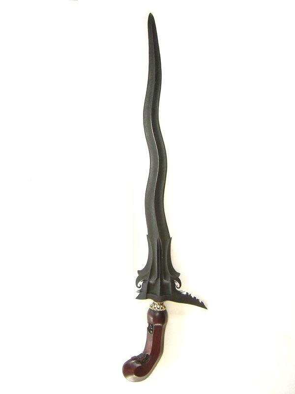

Here`s a pasopati.
Dapur determined by ricikan, which are:- kembang kacang pogok,two lambe gajah ,two sogokan, ri pandhan and gusen.
The wayang connection is only in name.
Arjuna had a magical weapon, that was an arrow, and it was named "pasopati".

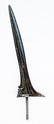

Here's a Pandawa Karna Tinandhing
The ricikan includes, an elaborate ganja kelap lintah with elaborate greneng works. A bungkul, a sogokan depan and belakang, 2 pejetan, 1 lambe gajah on both sides, 2 jalu memet on both sides, 2 belalai gajah (or kembang kacang) and a set of pudak sategal (normally bungkem).
No magical weapon, just the dapur, with a philosophy to commemorate Karna sacrifice.
Karna remains a tragic figure. A brave hero, a courageous spirit who braved impossible odds in his whole life, and died with terrifying courage, valor and honor and to rise to immortality in fame.

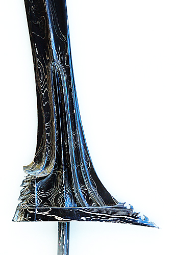

Here's a Karna Tinandhing.
The dapur is a straight bladed type.
The ricikan are similar to the pandawa karna tinandhing, minus the pudak sategal and is using ganja sepang.
From Simatua's Collection...
http://www.kampungnet.com.sg/albums/...5_00.sized.jpg

I supposed that Pasopati is yours. I could noticed clearly the border of gusen and kruwingan, almost to the tip of blade. I guess, the gonjo should be perfect fit with Surakarta? Pamor material, meteorite?
Ria
Ria is offline   Reply With Quote
Old 24th August 2006, 09:01 AM   #6
Posts: 7,229
Yes Pak Ria, my work.
The definition in the pics is not quite good enough to see all the close detail. I intend to put this and some other modern pieces up on my site within a month or so, and I can put bigger pics up there.
The gonjo is Surakarta, but I didn't cut the rondha very well. There are many better examples of Surakarta rondha than appear on this blade.
No, this is not a meteorite blade, it is ordinary commercial nickel from Europe, welded with some unknown ferric material---probably iron from an old bridge.

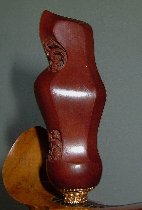

Is this representative of one of the Pandawa brothers ?

Originally Posted by Rick
So at this point we have two Wayang figures represented in dapur .
Are there any more ?
I have heard that there are some figures expressed in Javanese ukiran ; could we see some of those ?
Rick, your example is a representative of Semar.
See the similarities and the profile of the body.
http://www.chicagogamelan.org/wayang/Images/Semar.jpg
