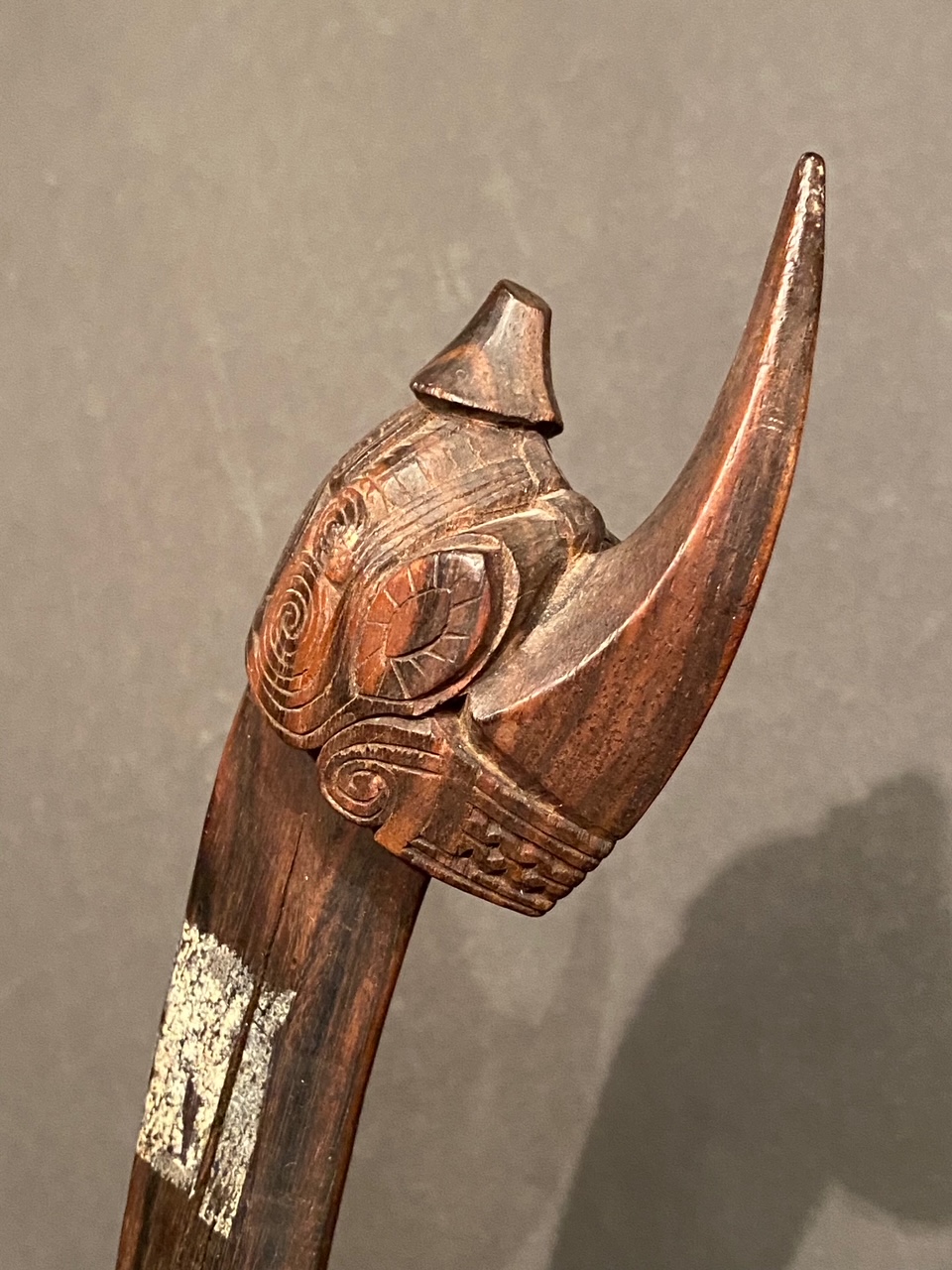

Question Help! Is this Philippine, Maori, Moro, Sundang, Barong

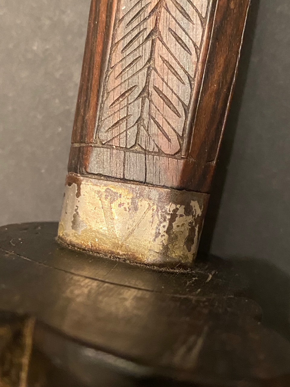

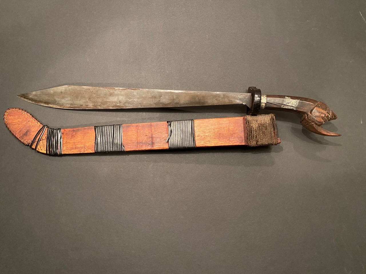

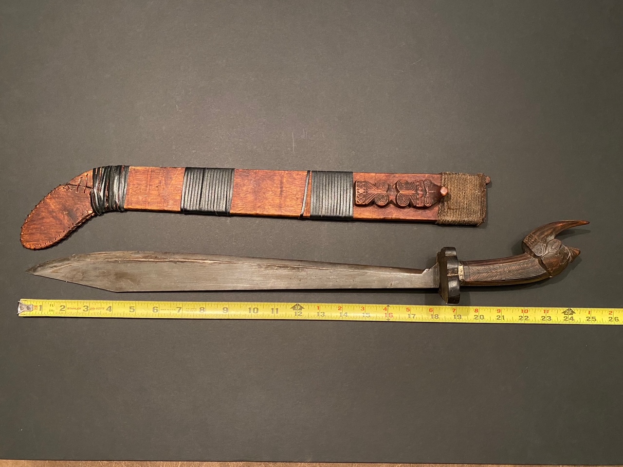

I bought this at a small estate auction from an Air Force veteran who obviously travelled through out the South Pacific and Asia judging from the other items. I know very little about blades as my expertise is in other areas such as firearms and accoutrements. This blade has some interesting carving and I am looking for any help in classifying it and trying to find a place of origin. It obviously has some repairs with copper wire and the leather wrap, but this looks like a decent craftsman made this originally. The incised carved sheath, the ornate handle and pommel, and the braided twine holding the two piece sheath together are out of the ordinary to me. I think the braided twine is possibly hair, but probably some sort of natural fiber. The circular designs on the pommel remind me of a Maori mask. Also if anyone can put a date on this-post WW II or before, or even 19th century. The blade is about 18.5 inches in length with a tapered blade and single cutting surface. There is a Roman numeral V on the hilt which is confusing. There appears to be tape residue on the handle.

That's a talibong, a sinuwak/bakutan profile. Probably Aklanon, from Aklan province, Philippines.
As far as I know, Maori don't have metal weapons, I could be wrong though.

Nice find, that's indeed a talibong.

Thanks for that help. I can’t believe I couldn’t find that on my own. The terminology is quite alien to me though. Any idea of age? Made out of a jeep leaf spring post WW II for tourists or older? Any recommendations on how to restore the braided twine that is missing- a better restoration than the leather? Any idea what the braided twine is made out of?

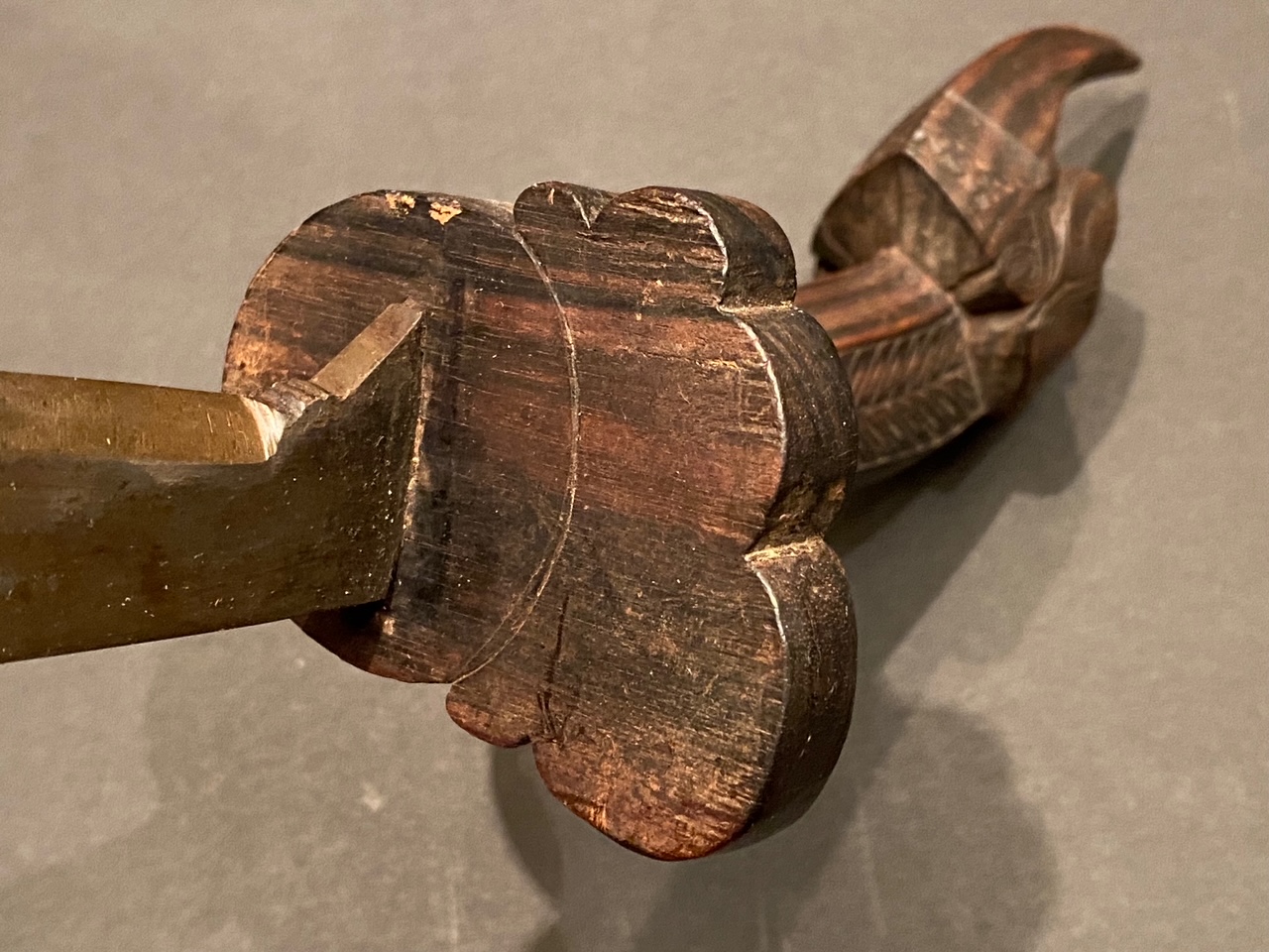

As to age, I'd guess at the WWII period or later:
No wear of the blade (plus grinding marks on the bevel); guard from wood which is not really tough enough functionally; the motifs on the hilt are a bit roughly carved and timber not well cured.

Thanks everyone. That was extremely helpful. It looks like a talibong so now I just need to find out where it was made (Aklan?,) when it was made (not laminated so probably after WW II,) possibly who made it, and was it for use or tourist trade? Any ideas?
