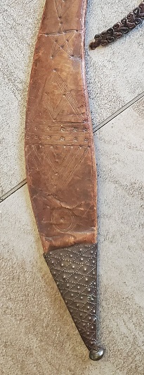

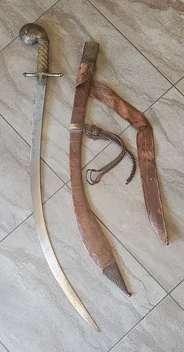

This unusual shamshir was discussed here over 23 years ago, and it was speculated that this anomaly was a genuinely intended weapon (not a tourism souvenir) of late 19th into 20th Sudan. The most compelling suggestion for Sudanese provenance is the flared scabbard tip.
The Ottoman style pistol grip hilt and crossguard and the European type scabbard chape and the ball on the tip (mindful of the thum on janbiyya scabbard tips) are also elements adding to the conundrum of this piece.
The diagonally reticulated design of lozenge form is a decorative motif favored on the kaskara of early 20th c. in 'Ali Dinar' (Darfur) period into later Kassala period, so is also interesting element.
In discussions c. 2000, it was suggested that the composition of the blade appeared to be "Istanbul beyaz' type damascus (as described in Stone as mid 19th c.)There were concerns that the blade might have been forged locally in imitation of that process as though it is of good quality, there are forging flaws. I do not have the sword available presently so just add that pending observations and questions.
I wanted to show this here, and hope for observations and thoughts on the possible character of the sword as far as being for ceremony or perhaps wear as a dress accoutrement.
Has anyone seen anything like this in Sudanese context?

The actual grip is not unusual. This style of dress sword was quite popular with British high ranking officers.

Existence of curved Sudanese swords is documented, even if not as frequent as straight blades. Looks like an Ottoman/Egyptian sword that was redressed in Sudanese style without changing the handle's overall shape. I wonder what's under the brass sheet!

Thank you guys for responding, indeed British colonial officers had a genuine affinity for 'exotica' and there was a notable cottage industry in outfitting which had a strong center in British controlled Aden in Arabia as well as of course in the Anglo-Egyptian Sudan.
This example however has the distinct ring of a weapon intended for status or ceremonial wear for a Sudanese notable, probably of the Condominium period.
It is true that the British favored sabers with the bulbous pommel Ottoman hilt, which was exemplified by the well know 'mameluke' style officers saber. This example with this type of brass hilt in this shape is not at all in the quality and style of those hilts, and while sabers are indeed known in the Sudan this is unusual in the character of the blade.
In discussions of those years ago, it was suggested that the flaws in the forging of the 'Istanbul bayez' damascus seems to have been possibly produced by a Sudanese maker who had 'been making kaskara blades' but perhaps with Ottoman direction.

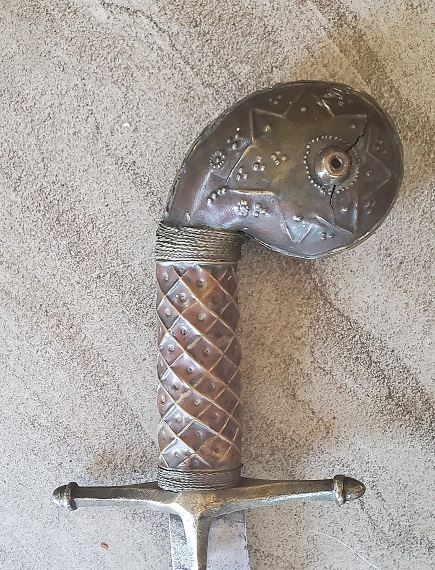

The reticulation in the hilt shows remains of the medium which apparently held some type of decorative fixtures in the spaces since removed. The character of the fashioned brass is atypical for this type of hilt, and recalls certain hilts produced in India on pata for example in 19th c. I would imagine there is a wood basis underneath.

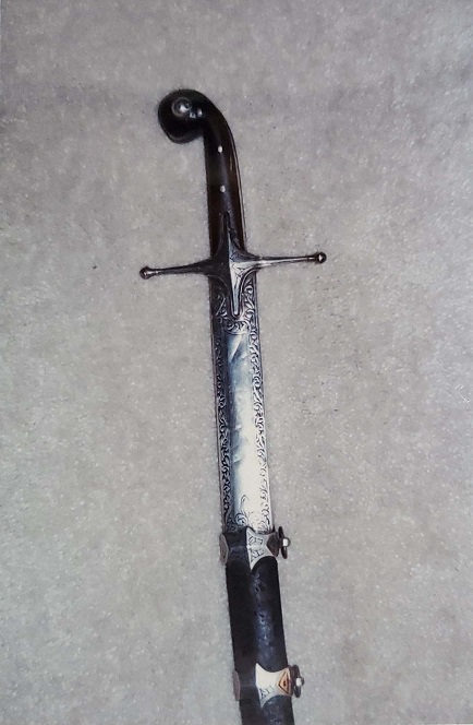

In previous post I had mentioned the 'straight saber' (pallasche) of Arab/Ottoman form as known in Anglo-Egyptian condominium Egypt.
Here is a photo of one from some years ago I saw. It seems remarkably like the one worn by Zebyr Pasha on horseback.

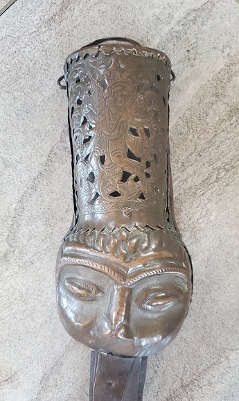

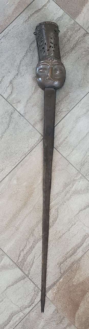

Next is an Indian pata I have had for over 40 years which has interesting history of its own from my acquisition of it (saving that for memoirs
Here is the 'style' of brass work I mentioned with reference to the hilt of my saber (OP). Of further and compelling interest is the blade, which appears to be European with astral motif and remarkably like those found of course in kaskara.
The possibilities of this unusual combination are intriguing, and well illustrate the colonial confluences of the last quarter of 19th c. Great Britain.

Hello Jim, My initial reaction was to consider this as a mixed variant perhaps using Kilij, Shaska or other sword parts including a blade possibly from a Shamshir..
Looking at it again I think Kaskara Hilt, Kaskara Scabbard and adornment to leather with star shape ... and a star shape to the design at Pommel ... with dot clusters in 3 and 5 dot sequences ... and typical of the sort of battle dress/weaponry worn by the warriors primed to not only destroy the enemy but to go to heaven trying... So for ceremonial as well as for battle.
If this was originally a Kaskara it seems the pommel was of no purpose other than decorative and not as a counter ballance but to prevent the sword falling from the hand although I would also expect a wrist strap to have been used.. The curved blade is a little confusing as normally straight it can be carried slung over the back and taking advantage of a usually straight blade and the widened scabbard near the tip.

My guess it was a Slavers Sword, pre-Mahdiya, not related to the Mahdiya 1985-99 or neo-Mahdiya in the c. 1920c. Designed to intimidate and exhibit power to Southern Blacks captives and not to exhibit Sudanese social/cultural solidarity. It doesn't exhibit Sudanese kaskara design themes only to suggest them. The cross-guard is cast bronze like those from Eqypt on non-combat kaskara not forged iron as on "real" kaskara. The metal grip coverings are copper not silver as would signal owner prestige. The scabbard exhibits better design & execution quality than the saber itself.
That's my story and I'm sticking to it.

Peter, thank you for these observations, and this does has composite elements, most notably the Ottoman crossguard, and the grip does seem that it could be kaskara, with the bulbous Ottoman style pommel added.
In discussions years ago, as noted, it was observed that the 'Istanbul bayez' shamshir blade had flaws suggesting possible, if not probable local workmanship perhaps by a maker more aligned with making kaskara. As I suggested earlier, the Ottoman alignment with Zubeir Pasha might have had Ottoman craftsman influences in shops which might have produced this anomaly.
The decorative character of this sword suggests it may have been a sword of status or ceremonial for a ranking figure in Zubeyrs forces.
The outstanding work by Ed Hunley you linked is some of the best research data on Sudanese edged weapons to date.
The motif, in particular the diamond/lozenge pattern is as noted distinctive for regions in Darfur, which aligns with the Zubeir Pasha possibility as his key areas of operation were in Darfur (West Sudan).
It has been suggested that curved or saber blades are not unusual in Sudan, and I am hoping to see examples, particularly of this period ending in the time of Ali Dinar until his death 1914.
