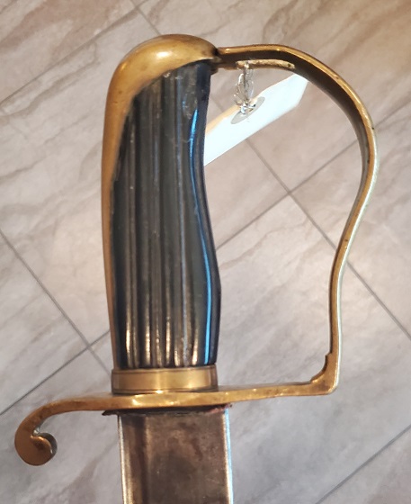

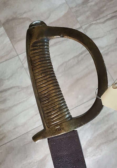

Default Brass hilt briquet type hanger....British cutlass?

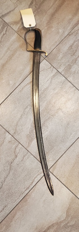

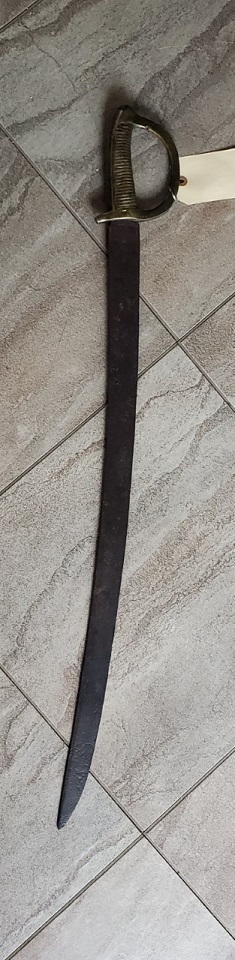

In 2020 I posted a thread on this munitions grade 'briquet' titled "The Lowly Briquet". In the discussion I had brought up the research over the many years Ive had this sword (since 1966) and the only declarations of classification by authors in resources claimed it was a British foot artillery gunners hanger.
One example shown had the name Trotter on the blade and it was seemed c. 1814 foot artillery as noted.
As we have been discussing naval cutlasses on the concurrent thread on the M1804 British cutlass, I did not wish to detract, so thought it would be good to post this on its own with posing this question.
The hallmark cartouche in the brass hilt in my opinion is that of Paul Storr, who was a renowned goldsmith and silversmith who fashioned wares for George III and IV, and first used the PS as his hallmark in 1792.
While these cartouches were typically used on in precious metals, it is known that Francis Thurkle (silver hilts) in 1790s placed his initials even in work regardless of metal used.
There was a distinct penchant for copying French designs in some weapons in the 1790s, and the French 'briquet' was of course well known, and had been seen as a naval cutlass.
As far as has been discovered, there is no reliable record of this briquet type hanger used by British artillery units despite the entries in a number of references showing these as such.
In the 1790s, there were concerns of French invasion even prior to the Napoleonic campaigns, and there were civilian efforts to establish 'home guard' type assemblies. There were also concerns to arm vessels for threat of attack.
As Paul Storr was not yet well established as the renowned silversmith he became in the 1790s, but did have facilities for casting metals (Bezdek notes he was a cutler and hilt maker) perhaps this might have been an early 'ersatz' cutlass for arming British vessels?
While obviously thinking 'outside the box', this is the perfect place for the knowledge base here to come together on this conundrum.

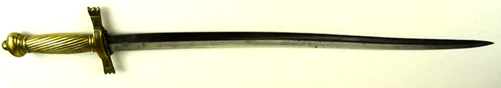

Old 19th November 2022, 08:35 PM   #2
David R
David R's Avatar
Join Date: Jan 2011
Posts: 1,167
I would look across the Channel for this one. Britain did not really go for brass hilts after the 1790's as far as I know..... I am confident of correction if I am wrong.
Old 19th November 2022, 09:04 PM   #3

Hello Jim. I do recall discussing these interesting briquet patterns, including ones with a small anchor stamp. The French were indeed the first to embrace naval cutlasses with a solid brass hilt and Gilkerson (Boarder's Away, my 'bible' and go-to always!) has covered them nicely, showing their development. Likewise, regarding the briguet, which came directly from these French 'sea' patterns, they probably would have ben well-received in desparate times to arm volunteers against invasion. The reason the brass hilts were popular on sea swords was for their anti-rust properties in the briney salt air.
Another deductive thought was that most naval hangers were also popular/carried by infantrymen, so could the briquet (being an infantry-type) make the same crossover to naval usage? I've always wondered about this. If so, I'd wager it would only have been in the scenario you proposed (desparate measures for voluntary forces or militias or merchant-type craft). Still, I know there doesn't appear to be any record to such use in Britain unless someone out there can enlighten us!?
Didn't we also definitely determine that there were briquets (not the French pre-naval brass gripped types, but actual briquets!) with the anchor stamp? Perhaps my memory has become cloudy again!

Thank you Capn!! I hoped you'd enter this foray into the mystery of this anomaly. As you agree this curious old 'briquet' might well have to do with this period of pre-Napoleonic times in England, which seem never to have been well documented.

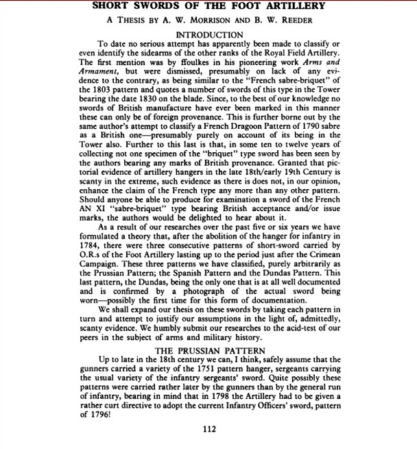

When the early writers on British swords such as Ffoulkes had little clue on these, which later were carried forth in Wilkinson writings (and again by Claude Blair) claiming they were British 'foot artillery hangers......these became the classification Gospel for collectors, at least in degree.
Actually these were never a highly collectible item, and most that were ever seen were of course French, which were well known (hence the colloquial term briquet). It was noted later in an article that no British example of 'briquet' was ever known that had substantiating markings identifying it as such, had ever been seen.
It was that several examples had been seen in the Tower dated 1830 which gave the impression these had been British.
However, as I had explained in that previous thread (thank you for the link!) the cartouche on this example with the distinctive cartouche with initials PS is compelling. It does NOT coincide with any type of marking used in weapons of other countries, including France.
It does however correspond to the early hallmark stamp of Paul Storr from c. 1792+. While this type stamp of course was used only by artisans using precious metals, it is known that in cases some did place stamps with initials regardless of metal used.
In these 'times of concern' where there was a notable civilian movement of ersatz defensive measures, it is noted in one reference that workers and artisans in many trades joined in to produce needed supplies and even weaponry.
It seems quite possible that Paul Storr, already working with other artisans closely aligned with the Royal House, might 'do his part' by creating a number of these hangers for 'the cause' and proudly place his well earned mark as testament to that.
The paucity of examples of these munitions grade weapons is directly related to their commonality overall, and that they were 'in bulk' excellent source for much needed brass metal, and were likely scrapped in huge volume.
A rather grim note on the post war use of the materials and other was recently found when I was researching the battlefields of Waterloo and other actions associated. It is well known that huge numbers of casualties were buried in huge mass graves there, however recent excavations revealed there are virtually no remains to be found archaeologically (save several noted graves of several individuals).
The horrifying fact seems to have been that these huge caches of remains were dug up to be put to use, with bone ground into fertilizer which became in scale a commodity much in the way Egyptian mummies were unceremoniously used.
While most weaponry found on these fields was of course taken as surplus, many more common items became of course smelting fodder, which would include of course these kinds of solid brass hilt swords.
With regard to the anchor stamp, in review of the previous thread on this topic, it seems that was a known Swedish mark used generally and not specific to naval items.

By "Mervyn Milton, The policeman's lot, London 1985, p. 108" one can read, that "the actual briquet never made it across the English Channel. This type of weapon does not appear in the UK. Prey pieces in a new way are not known. The "Police Swords and Hangers" are complex pieces, mostly made at "Parker, Field & Sons, 233 Holborn, London". So the sword in question should come from the continent, where it was in use in lots of countries as nearly all German states, France, Switzerland, Spain, Austria and Belgium.
Thank you Udo, excellent cite and thanks for the source detail. The swords for civil service are another area which is it seems not well covered in research material, so this reference is much appreciated.
It seems there is somewhat a consensus that the so called 'briquet' from the Continent was never part of the armory in Great Britain. It is almost bizarre that I never pursued this beyond simply assuming that Wilkinson and Blair in their books and classified these as 'foot artillery gunner' sword, British, was correct.
I think it can be established that the briquet, as a weapon form generally used in Great Britain indeed never happened, as shown in the Morrison article I added in previous post (thanks to Bryce who found it originally).

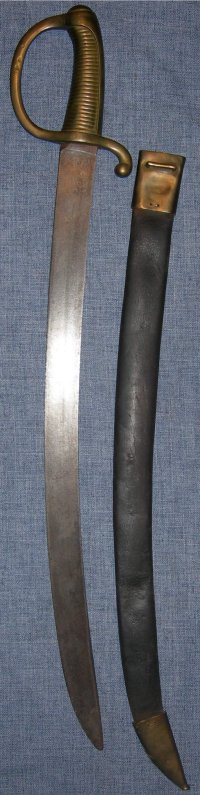

So...What IS a briquet? What ISN'T? Definition please!
Old 20th November 2022, 10:00 PM   #13
Posts: 10,870
These munitions grade hanger/swords were basically infantry/grenadiers weapons in France which were made with cast brass hilts and were well known prior to Napoleonic period and after.
Apparently the term 'briquet' was derisively applied by cavalrymen toward the shorter infantry weapons being compared to the sticks (lighters) called briquets used to start campfires.
It seems these were copied throughout Europe by their infantry units mostly but they seem to have been used in rank and file options as required.
These seem invariably to be the solid cast, ribbed grip brass hilts on varying form short blades.
