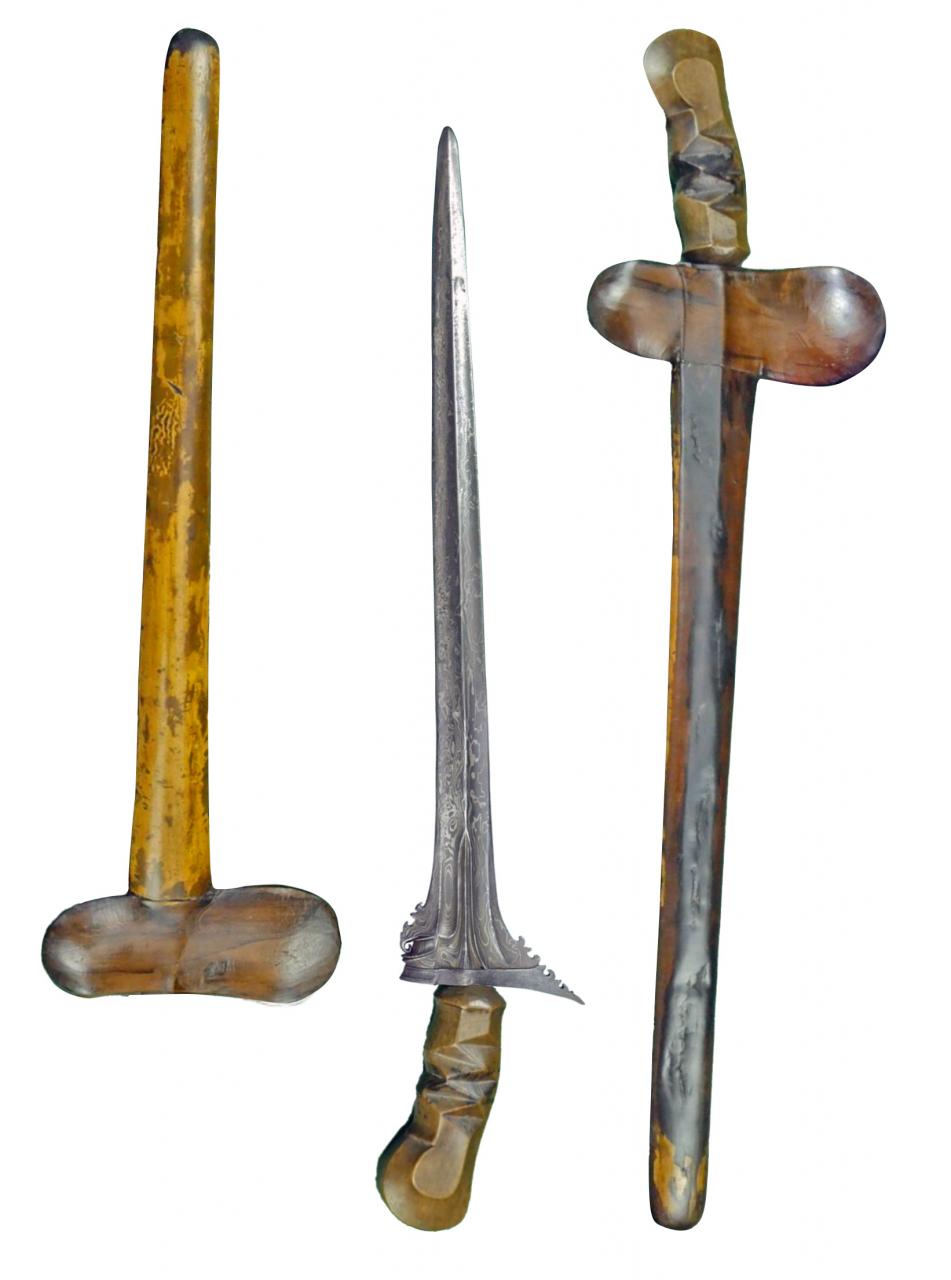

This is a new purchase but it will be several weeks before I get my hands on it. However, I'm impatient and hope to get advice/comments so I can consider options to dress it. I've (poorly) Photoshop'd the image below from the sellers photos which had watermarks. To my eye, this is a classic Bali keris with decent execution, likely late 19C or early 20C based on other examples on this forum. It looks quite serviceable as a weapon with a 45cm blade. I'm liking the warangka, a bit worn with character. I'm uncertain on the age/quality of the bebondolan(?) style hilt. I would like to think it is something a Balinese warrior might carry. Am I way off base? If not, I would love to hear suggestions for dressing it (selut, mendak, hilt) to match this period and function.

Looks like a nice example of a late 19th century Bali keris. The hilt form here is called Cekah Solas. You can find more information on these hilts here:
http://vikingsword.com/vb/showthread...7827#post87827
I would not say you are necessarily off-base on your assumption. I have heard that such hilts were favoured for fighting and this is the kind of basic, unadorned dress you might expect for a soldier's keris i think.

If what I think I can see in the photos is correct, this is a very, very good keris.
The blade style is classic, the garap appears to be detailed and neat, the forge work looks to be better than competent.
The dress is classic.
Old keris of this style of keris in Bali itself have been highly sought after for some years, especially so since the monetary crisis of the late 20th century.
I would not be so inclined to think in terms of Balinese warriors, out of context this can be a pretty misleading thought, similarly, in the Balinese context the keris should not thought of just in weapon terms.
It seems that you might be considering changing the dress, Jeff?
This could be one of the greatest errors in your collecting life if you do.
The only thing I might suggest is the addition of an old wewer (hilt ring), but undamaged old ones are very difficult to obtain.
This keris is perfect & beautiful exactly as it is.

Wow, I have gotten very lucky. Thank you for the advice. Best leave this at that. I would, however, be very interested to hear more regarding Balinese warriors and their use of keris as weapons within the proper context and nuance you mention. I am thinking of older photos with rough looking armed men with a large keris carried on the back. I know I've seen threads with lively keris/weapon discussions. I will go back and read on this and start a new thread if the specific Balinese context is not already well traveled ground here.
I completely agree with Alan that it would be misleading to consider the Bali keris only in terms of weaponry alone. While it is my understanding that the keris was indeed employed as a weapon in Bali, its place within that culture is so much larger than that and i don't think the keris was ever considered a prime weapon of war even if it was fought with at times.
I also agree with Alan that you should not be thinking about changing anything about this classic keris dress. The sheath, though worn, looks to be in pretty good condition, made from select and desirable timoho pelet wood, as is the Cekah Solas hilt. While perhaps not exactly rare, old examples of these hilts are at least less common and it suits this keris quite well. As Alan mentioned, the only thing i would consider changing about this ensemble would be to add a wewer/uwer (hilt ring) to it. While old, undamaged uwer may indeed be more difficult to find, if you look around some you can probably find a fairly decent new one that might fit the bill.I used to see these quite often on eBay.
