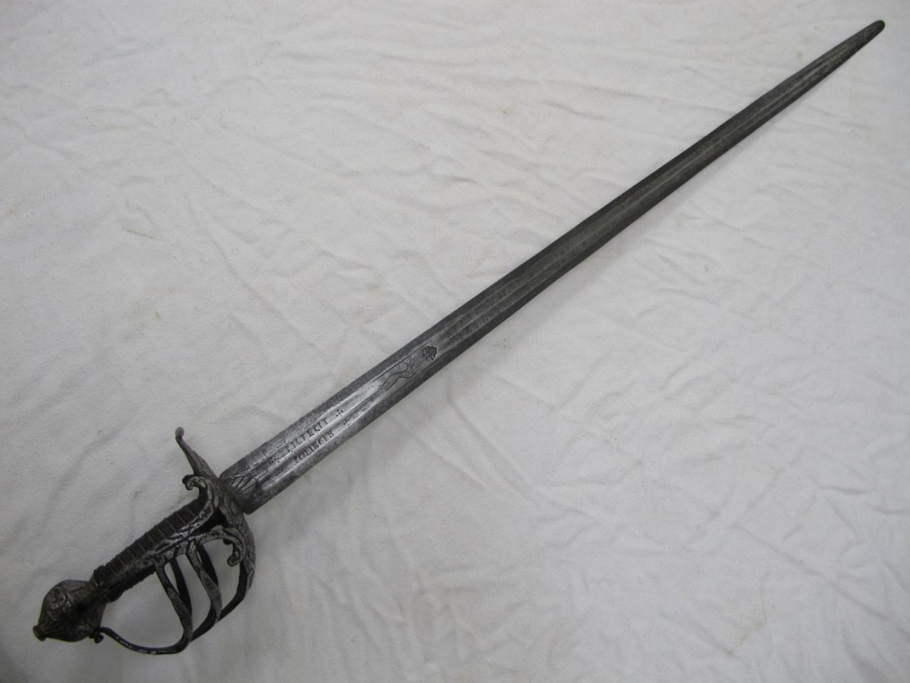

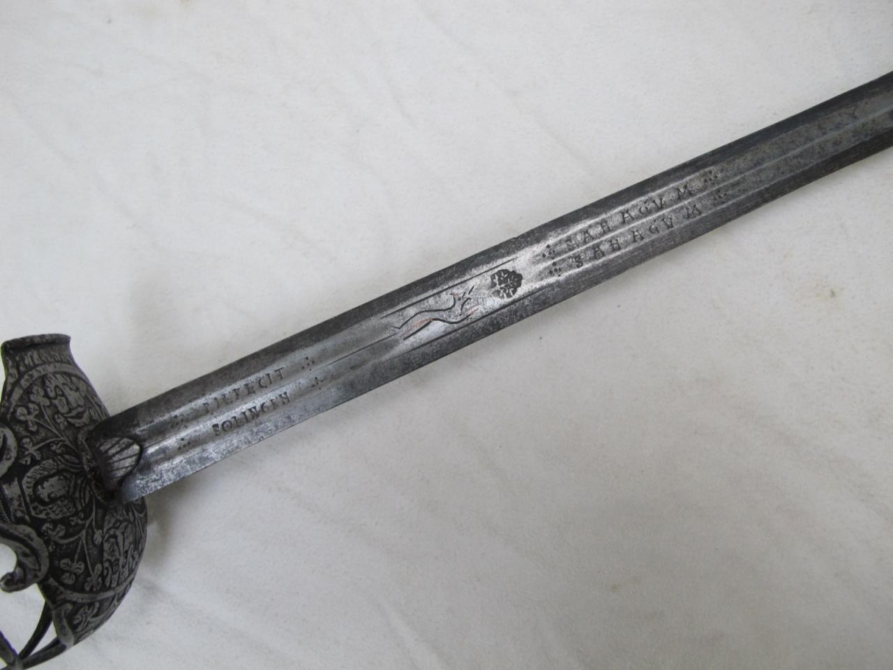

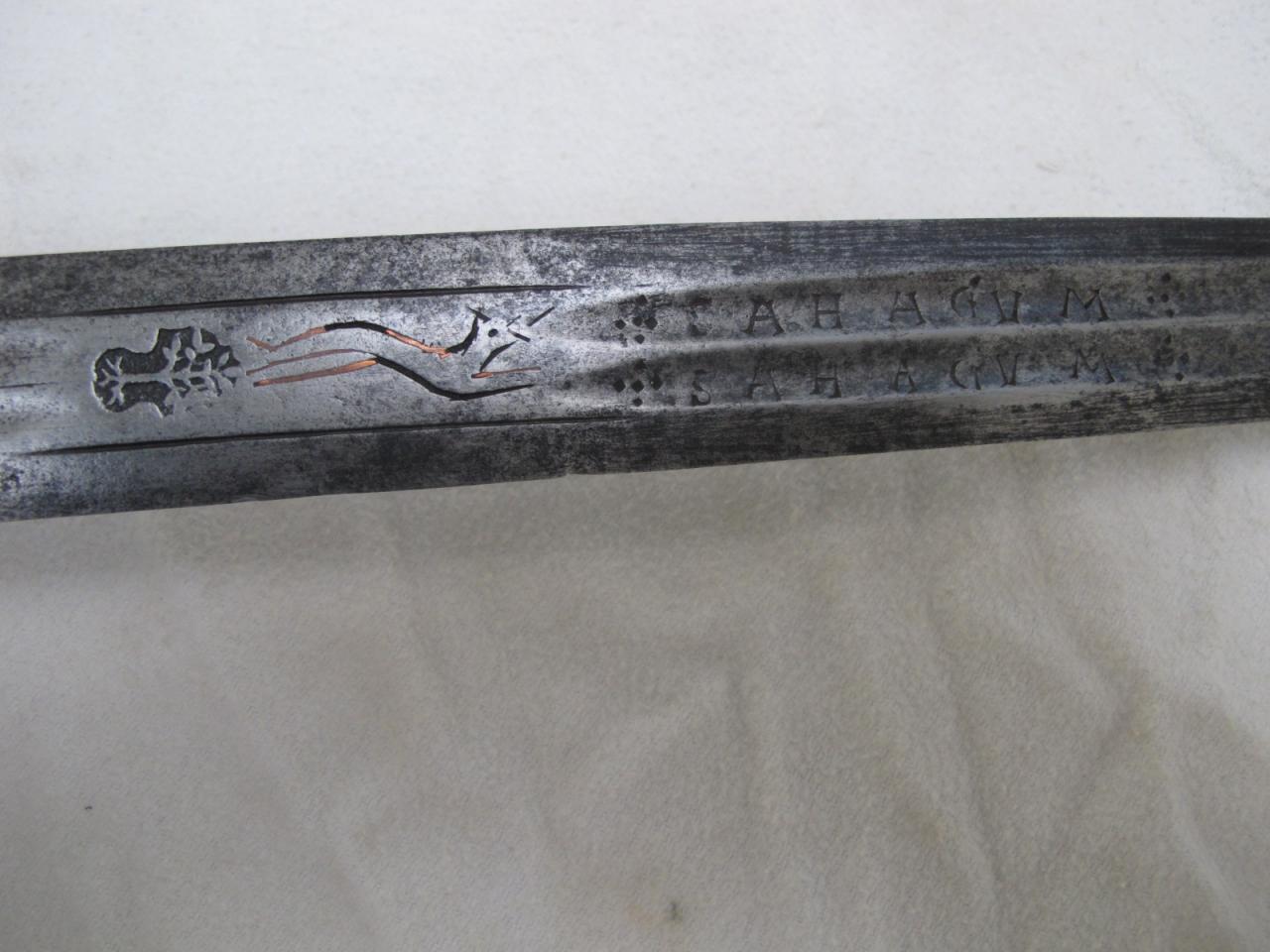

Does anyone recognise this distinctive 'tree with roots' stamp from a Solingen-made blade on a mortuary sword?
The blade is marked:
ME FECIT Running wolf Tree SAHAGVM
SOLINGEN SAHAGVM
From what I can tell ME FECIT SOLINGEN is Latin for "Made in Solingen" and SAHAGVM is a forgery of the signature for the 16th Century sword maker Alonso de Sahagun
It appears that the SAHAGVM (also SAHAGUM or SHAGVOM) name is for Walloon swords, what the Andrea Ferarra name is for Scottish Baskethilts. A search on the name turns up many Walloon swords but only a few English ones.
With its central trunk and exposed roots, I had hoped such a clear mark would be fairly easy to identify; alas, I can't find it in the reference works I have. Has anyone encountered it before?
These photos are from the vendor; the sword is currently on its way to me, so will be able to take more when I have it in hand.

Well, this is really a puzzler!
Going through all the standard references; Wallace Coll., Lenciewicz, Gyngell, Gardner, Kinman there is no record of a 'tree' like this........only in Kinman (p.110) BUT that is a Heinrich Boeker (Boker) of Solingen from 1829 onward...obviously having nothing to do with this sword.
I thought perhaps the Boecker might have earlier family who might have earlier beginnings in Solingen , but so far nothing there either.
I will say that the entire configuration of markings on this blade seem contrary to the usual patterns of Solingen markings. The 'running wolf' is typically upside down in accord with other markings on the blade (as with the Me Fecit and Sahagum). The wolf is not normally with a punzone, usually it is only flanked with numbers or letters in a phrase etc.
It is unusual to the the SAHAGUM doubled .
However, that is not to say there is anything suspect, but that this blade seems to have been marked by someone outside the normal workers who would carry out these blade inscriptions etc.
As this 'mortuary' is from the period in England when swords were produced in Hounslow, then in Oxford as well, possibly German 'type' markings were added to a blade. In these times Benjamin Stone if I recall, used a marking of grapes or a grape vine. Perhaps further research on this line might give a possible answer. and maybe this is a grape vine? The only conflict would be , Stone petitioned the Cutlers company complaining of the spurious use of Spanish or other marks on English blades in 1638....so is this outside that potential?

Thank you for the feedback Jim. It is as you say an unusual configuration, especially the orientation of the wolf and that pannel in between the fullers.
I saw Boeker's mark in Kinman but discounted the connection as his tree is split into two trunks and doesn't show the roots. That the blade is English made is another possibility that just muddies the water. But we can't discount the possibility that all the markings are spurious, after all, if it's good enough for the smiths from Solingen, then why not the smiths from England?

This is certainly an anomaly, and the character of the blade fullers resembles in. degree those of many of the mortuary type swords assembled in these periods during the English civil wars.
There can be no doubt the markings are spurious, in the same way they were applied in Solingen, most of the Hounslow blades were indeed German.
There are references suggesting that even blades from Solingen were marked as 'from Hounslow'. The lettering and configuration of the SAHAGUM as I note are atypical for that application as used in Solingen. It seems that in most cases these 'Sahagum' marked blades typically went into North Europe which is why they are well known on 'walloons'.
There are of course certain Hounslow smiths who did place their names on blades; Kinndt, Hoppie and Hopkins but this was not a consistent case, many of the blades simply had the running wolf.
I have a 'mortuary' with typical ANDREA FERARA blade which is certainly Hounslow c. 1650 as identified in Bezdek (p.281). Attached....pretty rough, and dont have clear pic of Andrea Ferara blade
According to Bezdek the Germans were producing blades for Benjamin Stone after 1631, the year he was awarded the drapes mark by Cutlers Co.
The mark had previously been owned by William Bals who died 1630.
As I say, I do not have image of this mark, and the idea of grape plant or vine is just a suggestion. It would seem that English cutlers were using punzones or marks which do not appear in the usual compendiums. If anyone has Levines Book of Knives (1985?) it seems there are some markings in there.
Whatever the case, I think this is possibly a Hounslow product c. 1630s-40s.
despite the unusual and irregularly executed lettering etc.

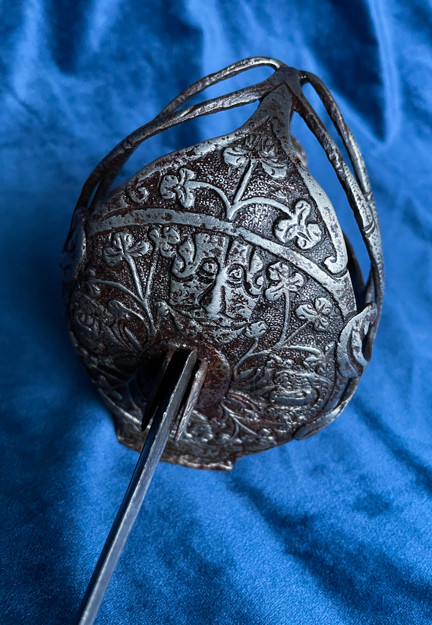

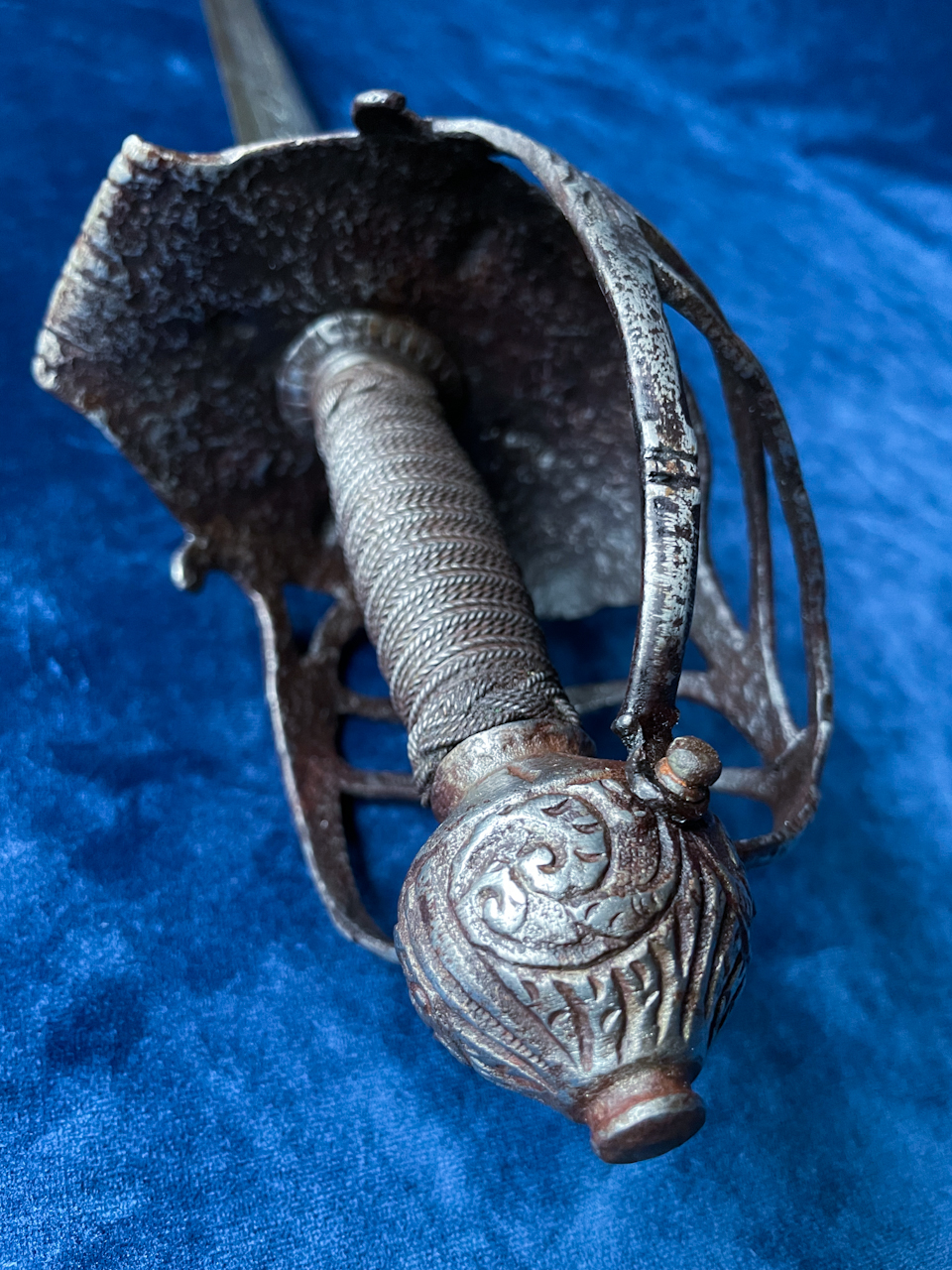

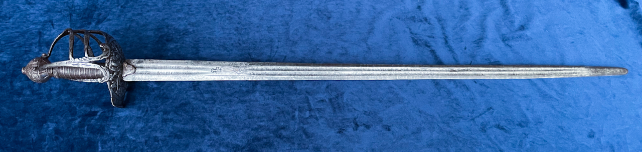

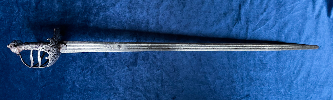

The sword arrived yesterday, so can put up some more photos. My first impression is that it's a lot lighter than I expected, at 860 grams. The blade is 830mm long, but has lost a bit off the point.
It's also quite thin: (Profile / Distal taper)
  • Ricasso: 35.3mm / 5.6mm
  • 200mm: 30.5mm / 4.1mm
  • 400mm: 26.1mm / 3.4mm
  • 600mm: 23.8mm / 2.5mm
  • 800mm: 15.3mm / 1.4mm
Although this profile is similar to the backsword blade on my 1796 HC dress sword:
  • Ricasso: 32.0mm / 6.1mm
  • 200mm: 28.9mm / 4.5mm
  • 400mm: 27.7mm / 3.2mm
  • 600mm: 25.2mm / 2.7mm
  • 800mm: 16.5mm / 1.3mm
I'm guessing that the grip wire was redone at some point, possibly in the 1800s? Although the Turkshead knot looks good so it might be older but that seems unlikely.
All in all an interesting piece, even with the peculiar 'panel' on the blade. Will need to keep an eye open for similar blade profiles to compare.

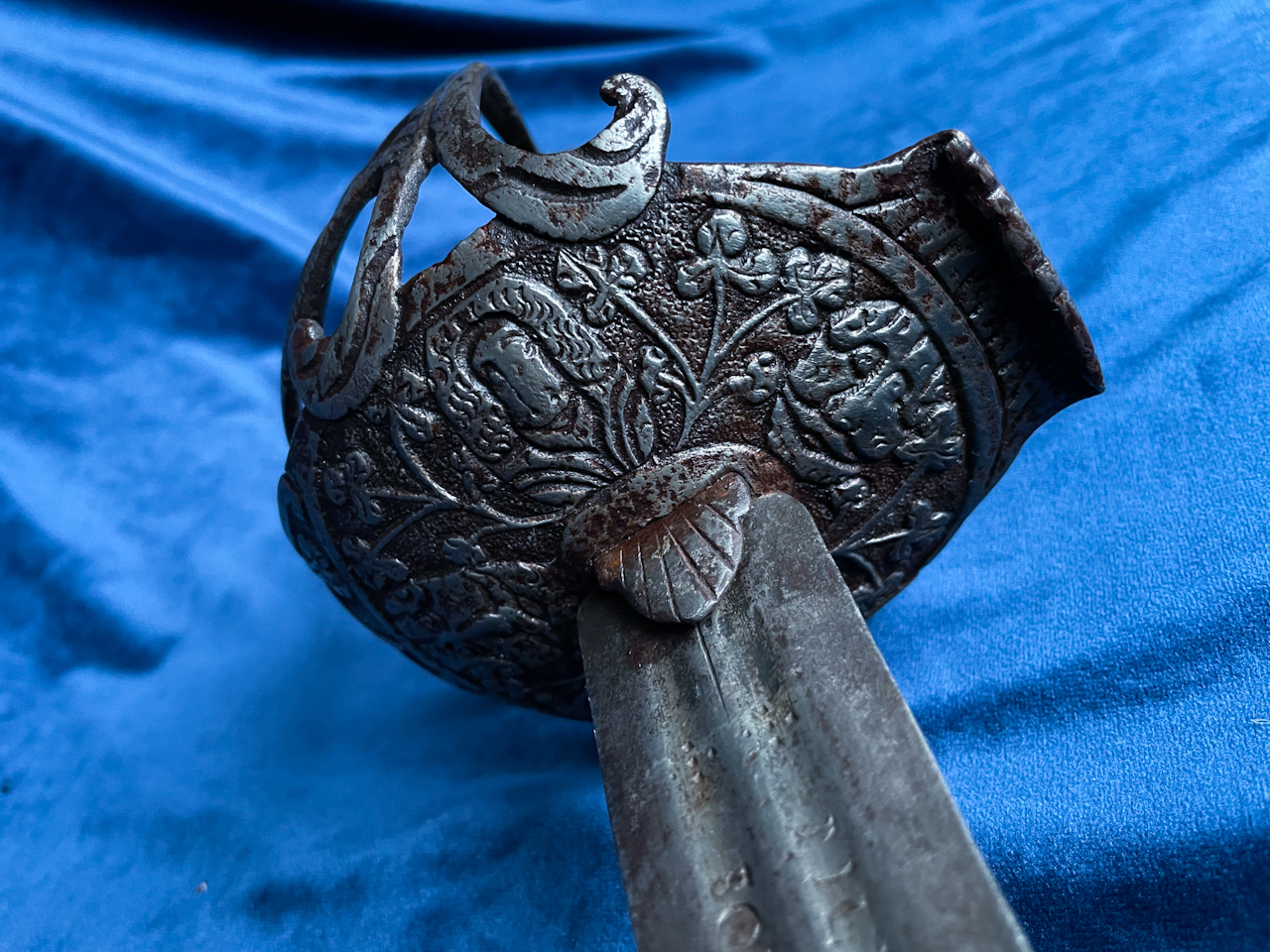

* Drool *
The engraving on the rear of the guard is a green man I assume, but what is engraved on the sides? It almost looks like a flower wearing a wig.
Old 12th October 2022, 11:08 PM   #11
Radboud
Join Date: Sep 2021
Location: New Zealand
Posts: 303
Originally Posted by werecow View Post
* Drool *
It's another head, just the face is a bit worn. These faces are a prominent feature of these hilts and where the name 'Mortuary' sword comes from. Late Victorian collectors theorised that the face was the martyred King Charles II.
But as swords with these decorations were carried by both sides of the English Civil War, and there exist examples that can be dated to before the death of Charles II, this is an unlikely explanation. Possibly another one of those mysteries that can only be resolved with a time machine

Default Face in the flowers
It's a Green Man... or a variation on the theme.
As was said, Charles the first was beheaded as a result of the civil war.
I have Shotley Bridge swords, and have seen others, with that same face... often where the leaves, that are pertinent to the imagery, have worn away with just the face left behind.
BTW, it is a magnificent sword.

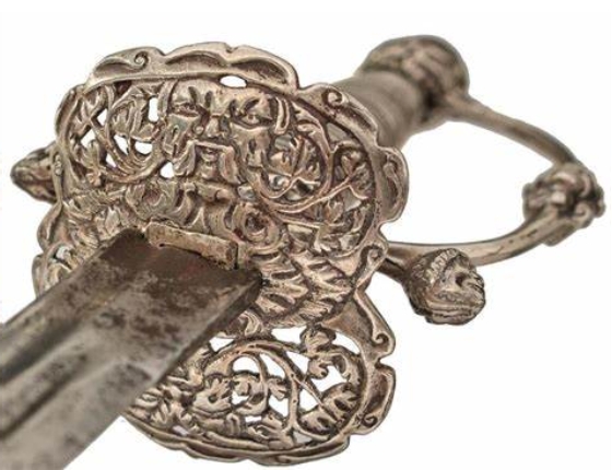

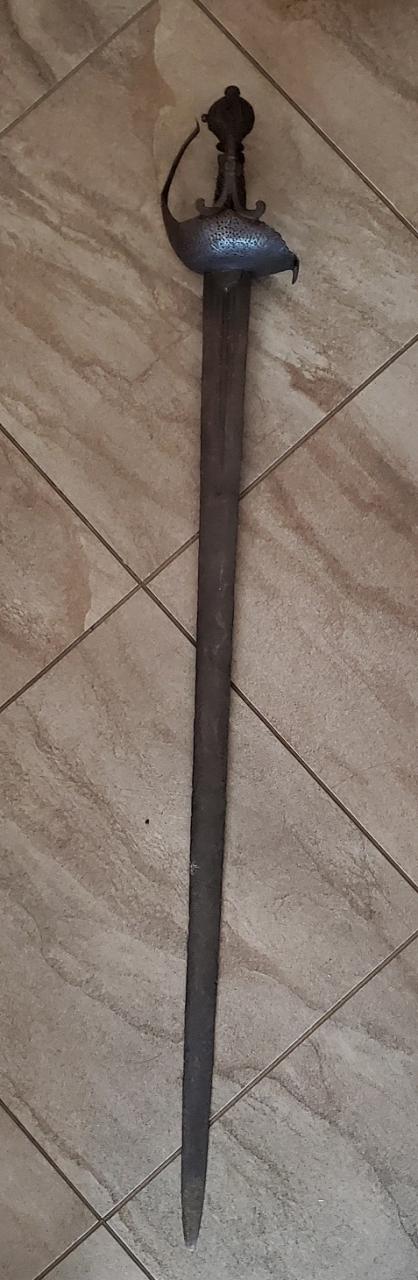

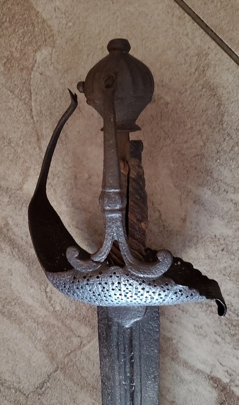

Another found online:
Old 13th October 2022, 08:32 PM   #14
Radboud
Join Date: Sep 2021
Posts: 303
Thank you all for the feedback and the additional examples Jim and Kronckew.
Jim, I'd be interested to hear how the dimensions of the blade on your example compare to mine.

I'm not sure that the face qualifies as a green man, while it has a foliage pattern around it it is not truly part of it. The true green man figure often has leaves for hair and branches emerging from the mouth.
Also worth noting that the green man symbols are a complete enigma we have no record of what they meant to the people who carved them and the "ancient woodland deity" theory was made up out of thin air by a Victorian "researcher".
