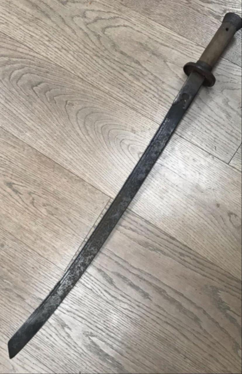

Ming late dynasty Chinese Dao (Saber)

Following Peter Dekker's article this looks most like a "goose quill saber" with a simplified "goose wing" termination. Hopefully Peter and Phillip will weigh in.

Seems unusual to see tunkou on one of these, but clearly this is a hybrid as so often the case with these forms. While I am anxious to see the input from Philip and Peter, I wanted to add my own similar example for perspective.

Hi Antony and others,
I think i know that one...
Honestly, it looks like a Yanchidao (goose wing) saber.
Potentially, fittings are a bit later from blade. Some excavated swords from that type avec been attributed to 14th (Yuan period).
I have discussed that one with Peter and Philip some months or year ago. It could be from late ming/early qing dynasty. At the same period, i had also contacted a chinese author and sword collector that assessed late ming/qing. Still, it could also be a bit later. It's always difficult to know. I think that saying 18th would be a reasonnable guess ?

Could be and also I was told that iron fitting is usually earlier than 19th/20th century. This is one of my favorite. Enjoy the photo.

Blade shape is usually called fengchidao (phoenix wing saber). The type does indeed date back to the Ming if not earlier, as indicated by depiction in art of the era, and a few surviving specimens. The fittings on this one look like later replacements, Qing for sure, judging from their style, probably around the 18th cent.

I was hopping that you can advice me the possible reasons that the groove was so badly done. Many thanks.

Hi Philip
Greeting.
In this photo they don't look all that bad. The whole surface is disfigured by patches of corrosion. In my experience in restoring antique swords, a proper polish will make these fullers look real crisp again. Believe me, I've seen worse on ethnographic weapons of all sorts, when they are sloppily cut to begin with, it's often a lost cause to fix them because too much metal has to be remove to adjust depth and contour.
