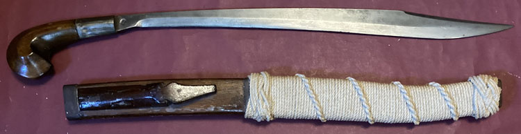

Hi All,
I just got my anniversary present and it is stunningly graceful. Since it is more slender and curvilinear than the typical tenegre, can it still be classified as such?
The 19-5/8" (49.8475cm) chisel ground, clip point blade has a chisel ground false edge to the clip point. Across the flat, the blade is about 5/8" (15.875mm) wide at its narrowest point and about 1-9/16" (3.96875cm) at its widest. The spine is a tad under 1/4" (6.35mm) at the hilt and tapers to about 1/8" (3.175mm) at the clip point.
The hilt is mahogany and appears to be the simplified deity type. The ferrule is brass.
The sheath is mahogany. Three steel bands are visible (one at the throat and one at each end of the cord wrap) but a strong magnet (used with the blade unsheathed) shows that there are two more below the cord wrap. I don't believe the cord wrap is original to the piece. Work of an American seaman perhaps? Somebody also glopped on a thick layer of varnish to the hilt and the sheath (it almost looked as if they had been dipped in it). I got most of it off the hilt and will try to do the same with the sheath.
I don't think the sword is robust enough for military use but would be light enough for comfortable civilian carry. The clip point notwithstanding, without a guard of some type, I wouldn't be too sanguine about using it to thrust with. These shortcomings aside, it is one beautiful piece. I estimate age as just post WWII.

First, let me compliment your significant other on having excellent taste in the gift that you received on your anniversary!
Even though I am that knowledgeable in these matters, to me it is a tenegre. I will also speculate that your sword is at least pre-WW2. I love the knotwork on the scabbard, which was as you speculated probably done by an American Sailor.
Your sword is a true fighting weapon and I would not discount it for being light as many Philippine martial artists like a "fast," weapon that can make multiple quick strikes.

I'd second that motion, Rob: Congrats, very nice piece! Let me know in case you dare to let it pass in many moons...
I could certainly live without the cord wrap which definitely is a later addition out of the originating culture; now part of its history though.
Most of the traditional archipelago blades come without any guard: Limited personal protection equipment. Heavily committed thrusts tend to be rare with swords; if needed, a thrust can be supported by the live hand...

Is that a stamp I see on the blade?

Let me say that my wife got as good as she gave because she is now the very happy owner of the finest 19th century French navaja I have ever seen.
I am glad to know that it is a tenegre and even more pleased with the possibility that it is pre WWII.
I am going to leave the cord wrap in place. It isn't part of the original culture but it is now part of the history of the blade. Also, it is well done and may actually serve to protect the sheath from damage.
I am also happy to know that everybody has a higher opinion of its combat worthiness. Because I am a big fan of sturdy, maybe I am being too harsh.
The mark by the hilt isn't a maker's mark, it's just a forge mark.
This is a really special blade in my collection, both for what it represents as a gift and for the beauty that it has.
