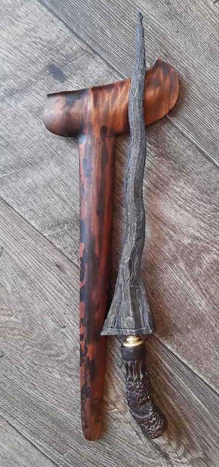

Hello all, I recently acquired this keris but I can't find what dapur it is. Any ideas?

If it did not have luk, what might it be?

Location: Sydney, Australia
Posts: 295
Without luk, I'd say dhapur brojol.

Gandhik?

Gandhik?
Hm yeah I didn't pay enough attention to this.
Looking at it again, I am not sure if you are prompting the question because an opinion of "brojol" doesn't hold water based on something to do with the gandhik of this keris such as
  • its gandhik is long
  • there is no gandhik
I'm leaning towards the former due to the differences in angles marked with red, and the gandhik marked with yellow.
If I'm to refer to the Keraton Surakarta pakem as published by Yayasan Damartaji, I don't know what dhapur this keris would be if it didn't have luk. If this keris can be said to have no gandhik then intuitively and perhaps wrongly I would say dhapur sepang.

Any keris with a longish gandhik has either "kebo" or "mahisa" (maesa) as a part of the name, both words (there are spelling variations) mean "kerbau", "water buffalo", just different language levels.
Have a look at drawing #4 in the pakem.
Incidentally, although this book is probably the best guide we have, there is not universal agreement on everything between its covers.
