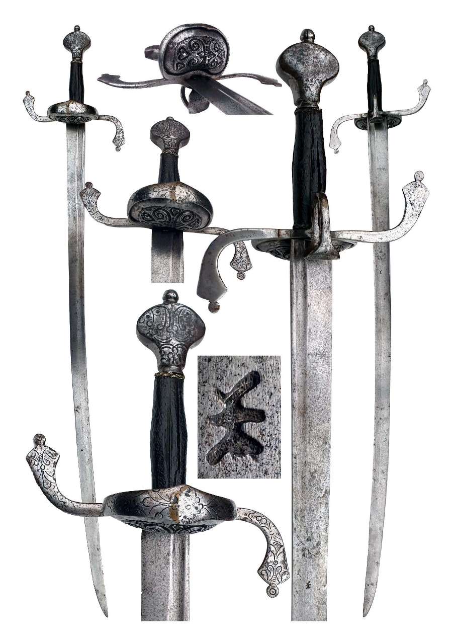

Hi Guys
I am trying to settle on general file descriptions for swords in my collection and a couple could probably be improved. So I thought I would post the ones I am currently reviewing. As I post them I will state what I have called them up to now, but I am open to suggestions that might be more accurate given current thinking.
First example, I called this sword a Sinclair Sabre Type 2 as that is how OAKESHOTT, Ewart European Weapons and Armour Pp 172, Plate 14, Figure 78 described it.
Sword description
Flat renaissance pommel, wide up-and-down quillons and forward ring-guard. The large ring-guard is filled with a plate, decorated, and with a corresponding thumb-guard at the back. The Guard and pommel engraved with floral decoration. Grip has both Turks heads but no wire, only the wood remains. The blade is slightly curved backsword which pre-dates the hilt bare a sword mark in use from circa 1580-1620.
References consulted
BOCCIA L.G., COELHO E.T., EDITRICE B. Armi Bianche Italiane Pp 342, 150 & 151, 346, 347, 387, 394
FORRER R European Sword Pommels pp 18, 155 plate LIII (4)
OAKESHOTT, Ewart European Weapons and Armour Pp 172, Plate 14, Figure 78.
SACH, Jan & KRAUS,Valtr Illustriertes Lexikon der Hieb- und Stichwaffen Pp 104
SEITZ Heribert - Blankwaffen 2 P
I would be interested in an alternative view, if possible, please provide references.
Regards Cathey

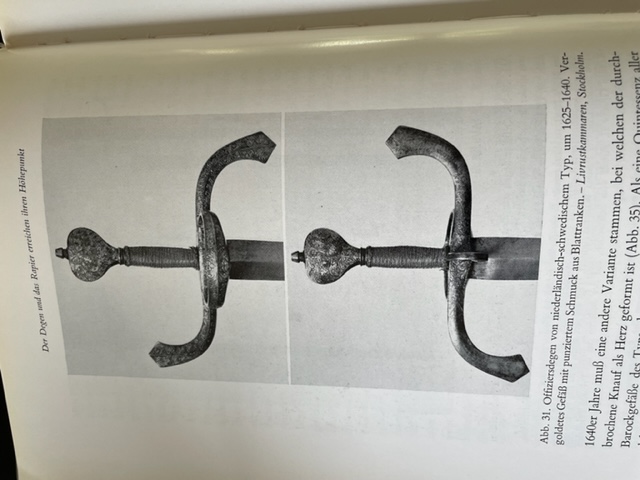

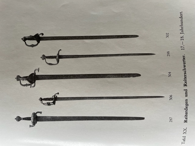

herewith my "alternative" view
it is not a sinclair sabre but a cavalry fighting sword ( reitersabel) of the Dutch-Swedish type. 1630-1660
cf the visser collection part 3 JP Puype Cat 547, schwerter und Dolche / Wegeli nr 287, SeitzII p40

While more of a superficial observation, Im inclined to agree on the cavalry sword classification simply from my personal view of so called 'sinclair saber' category being shorter with stout heavy blades. While cavalry swords of the 17th century seemed to have predominant straight blades, the evolving 'light cavalry' of course were inclined to use saber blades.
The hilt style seems a 'sinclair' saber criteria, with Oakesott adding a secondary option with open hilt and lighter blade.
It seems to be a matter of personal view, while many in discussing arms choose to use Oakshott classifications for standardization in discussion.
I think I'd call it as Jasper has, to me Sinclairs are heavier with basket hilts and more in the dusagge group.

re: Oakeshott
I think Oakeshoot meant the same, a Dutch Swedish broadsword from around 1650 but probably by some similarity in the form of the quillons , naming the type sinclair 2.0
