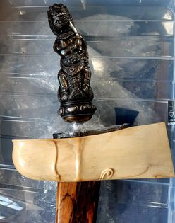

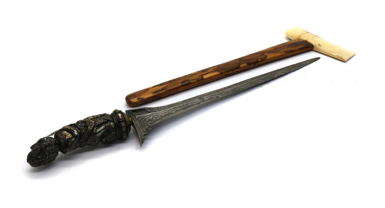

Default A Balinese (?)keris for identification please

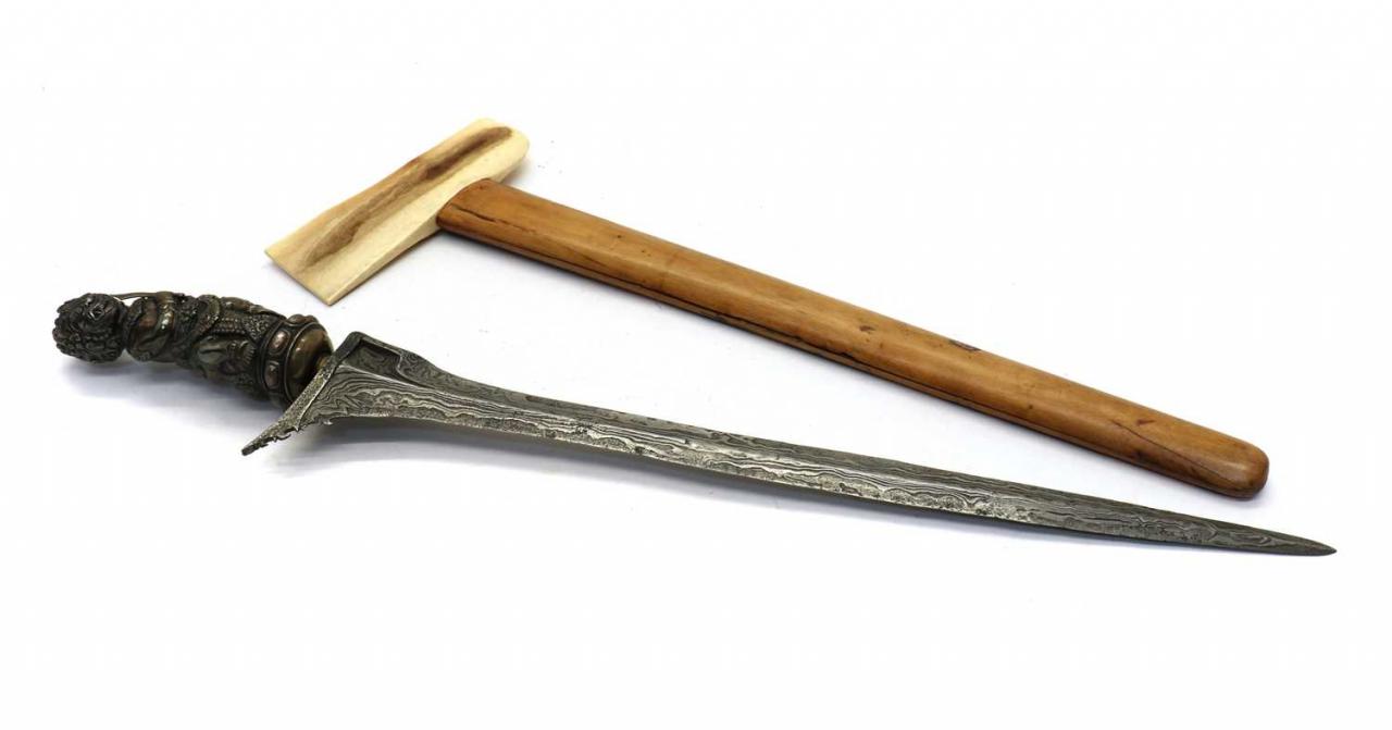

Hello
I would be grateful for your views on age and type of this keris please. Blade length is 44cm. The scabbard is described as ivory and wood. The hulu is silver. The keris is described as Balinese. The dhapur and etching is not typical for a Bali keris but there is a Balinese dhapur Marap that resembles this shape in lacking the elephant trunk and having a straight blade shape and similar fullers. The etching is also noteworthy but it may just be out of stain. Thank you in advance.
SidJ is online now   Reply With Quote

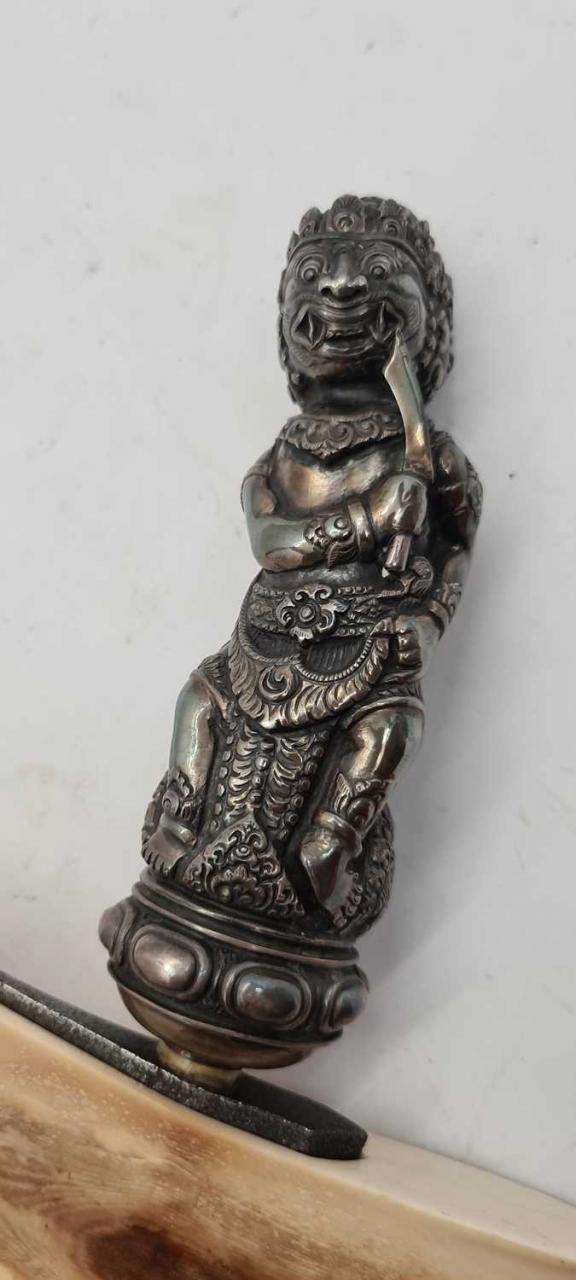

An interesting kris probably from Lombok, the hilt depicts a demon which may be Ravana. The blade would benefit from warangan treating indeed, the ivory warangka in kekandikan style is discolored on the back side because the maker used the outer surface of the tusk. I would estimate the age to first half of 20th century but the hilt is probably more recent.
PS: The top part of the warangka may be from bone (the pics are not clear).

Posts: 7,228
Sid, may I ask where you got the dhapur name "marap" from?
I know of a Balinese dhapur "marak", but I do not know "marap".
The blade pre-dates 1900, but it is very difficult to date Balinese blades with any degree of certainty.

Hi Alan
Apologies. You are right. I meant 'Marak'. The reference I have is pg 266 of Keris Bali Bersejarah. Thanks for your thoughts re the age of the blade. I had thought that the hilt was also pre 1900s given the detail of the work and the patina of the silver.

Posts: 7,402
The silver patina is not a great indicator of age. However the style of work is more so and I would think that the metal work fits more the 1940s - 1970s.

Thanks Sid, yes, I guess "marak" will pass with a push.
I don't know the Bali dhapurs, and I've gone to the Neka book too, the characteristics that dhapur marak should have are given as:-
gandhik polos berukir, alis, sogokan arep, reringgitan
I find this a bit confusing because "gandhik polos berukir" means a "plain gandhik that is carved" to my way of thinking the gandhik can be either plain or carved, but it cannot be both.
"alis" is OK, but "tikel alis" would be closer to the mark
"sogokan arep" would be more clear if it were to be "sogokan ngarep" which means "sogokan in front", but I guess that we can assume he means the same thing
"reringgitan" means greneng --- I have no idea what language this is, but the explanation is given under an illustration.
Anyway, I reckon this keris is probably near enough to marak, which I know as a Javanese dhapur, not Balinese. I cannot see a tikel alis in this keris under discussion, the sogokan is maybe there, the gandhik is not carved.
But maybe this keris does pass as marak.
Blade age is pre-1900, the dress probably dates from the 1960's-1970's.
The top of the wrongko(atasan) might not be ivory, as Jean has said, its a bit hard to judge from the photo, but if it is bone it would need to come from something pretty big.

I was thinking if the warangka could be moose antler. There are already Balinese craftsmen using moose antler for warangka. I kept some moose antler material made Balinese hulu.

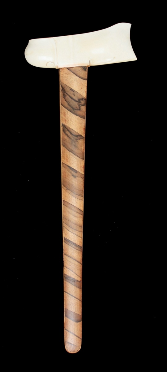

Hello Sidj,
Please show us detailed pictures of the top part of the warangka (front, rear, and top sides, taken at a right angle) for better identification of the materials.

I am not yet in possession of the keris. It has been described by the auction house as ivory. I know that mistakes can be made though. I will post images when I have it in hand. Apart from the dark patch, ivory seems plausible to me. Of course, it could also be some type of bone. I will be able to tell once I get it.

Thank you and yes, ivory materials is very possible but the small pits on the reverse side may indicate bone. By the way the hilt is placed in the reverse position.

What if any are the implications of the atasan being ivory vs it being bone? Can we draw any inferences if it is one or the other? I presume bone is less prestigious than ivory but could this also enable a reassessment of the date of manufacture from the 1970s to earlier in time? Thanks in advance.
Old 27th May 2022, 05:34 PM   #15
Jean
Join Date: Jun 2009
Posts: 1,740
Yes, an ivory atasan is much more prestigious and expensive than a bone one.
Bone would often decay quickly (more or less depending on the type of bone and the selected piece) so it generally looks older than an ivory one of the same age, except if the ivory piece has not been properly selected .

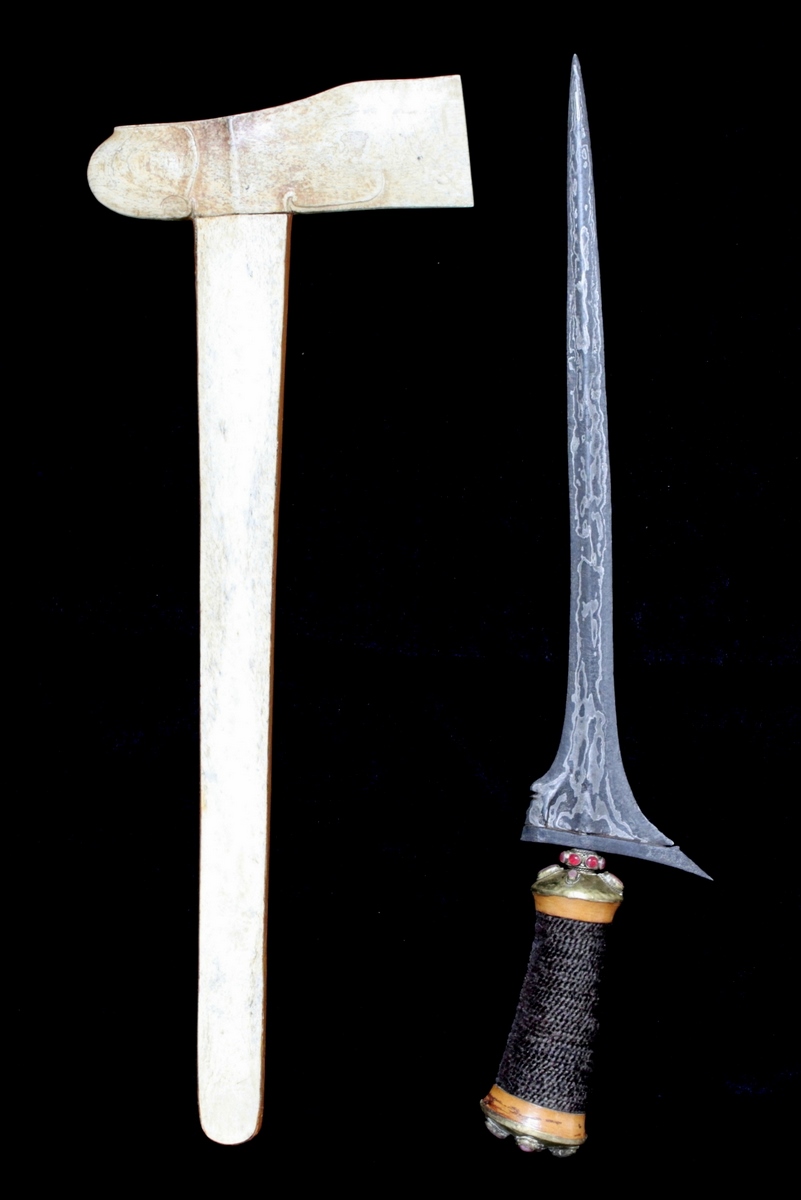

See specimens of an ivory atasan (left), and a whale bone one.

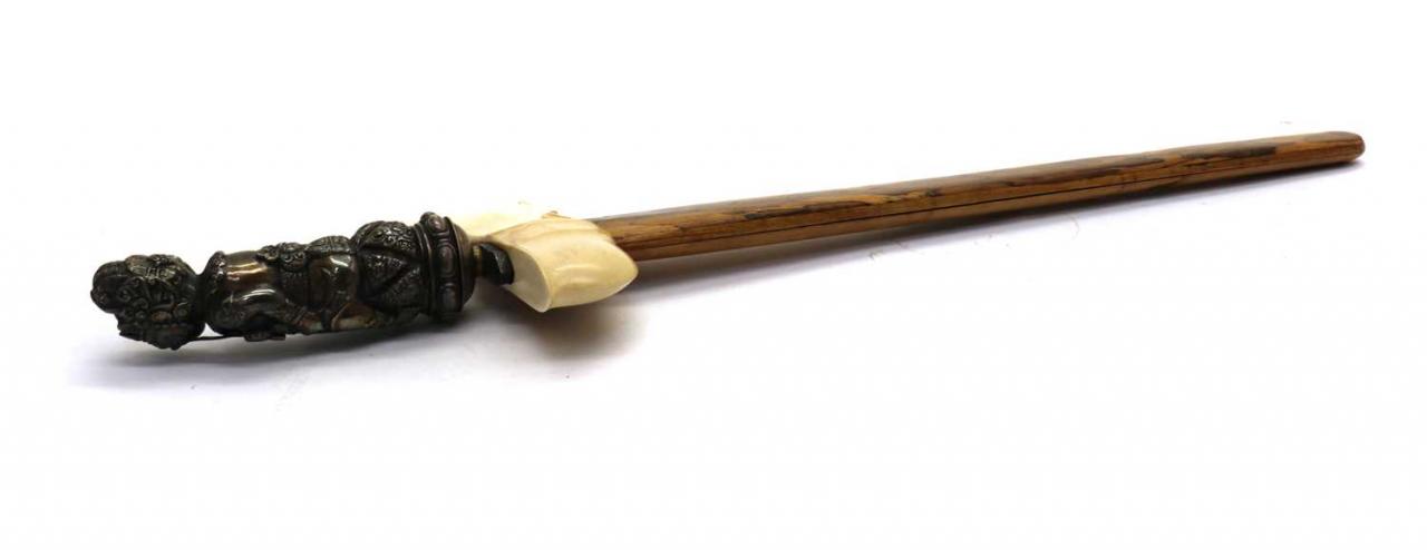

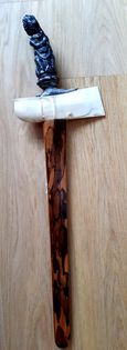

I have now received the keris and having checked it carefully I can confirm the Atasan is made of ivory and not bone. I am unsure if this necessitates any reappraisal of the age of the dress or not.

Personally i never thought it was bone, but i could not see any evidence of Elephant ivory (Schreger lines). Now that you have it in hand can you tell what type of ivory it might be? I'm not sure how much adjustment there would be to the age of the dress. It does seem newer than the blade and 20th century. Likely post-WWII, but it is still hard to tell from the seller's photos. The atasan does seem a little stiff in it's form which might point more to a later date than earlier. But these photos are all from odd angles. Maybe you could post some new images now that it is in your possession.

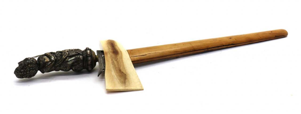

Pics of the keris

I can see Schreger lines and therefore conclude it is elephant ivory

Thanks Sid. I saw these pics on the FB thread. I could see the Schreger lines there. Clearly elephant ivory. You might need a larger imager to convince the doubters here though.

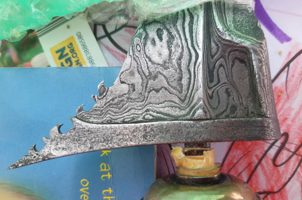

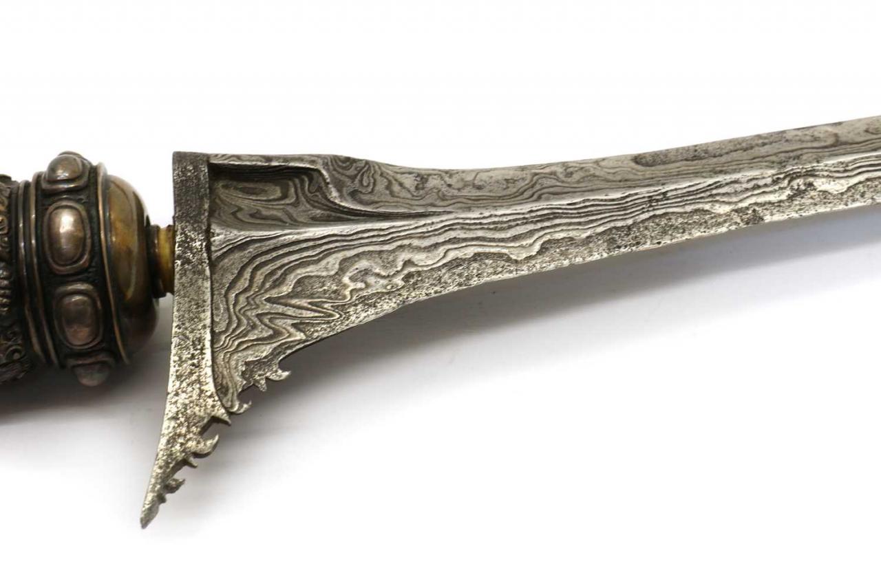

Interesting to see a Bali style Keris with defined Blumbangan but without Kruwingan and Tikel Alis. An unusually plain appearance.
SidJ, is there a possibiity to post a good picture of the base of blade with Gandhik on the left? Thank you very much!
And, is the blade alone indeed 44 cm long?

Gustav see pic
