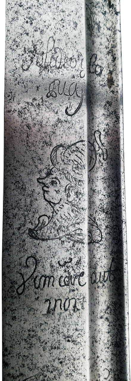

The first sword is Circa 1640-60 Iron Animal head pommel with pieced guard on one side and thumb ring on the other. The blade is slightly curved 34” 86.5 cm long and has an etching of a man’s head with some text in what could be Latin above and below. If any one can tell what this is I would also be most appreciative. I have gone through all of my references on marks and blade engravings and found nothing that matches this one.

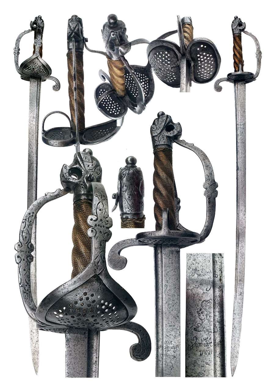

I take this as a typical Swiss sword. The lions- or dogs head is absolutely typical for Swiss arms at that time and one can find them in many auction catalogues or Swiss collections today. The script on one side of the blade reads "CUM CORE AUT MORI" and should be in English "with the core or die". The script on the other side I cannot read, sorry!Of course it it also possible that this sword has been made in southern Germany or Austria, the frontiers are fluent, but its type is iMO absolutely Swiss.

Sorry, I forgot the pictures, here they are

Thankyou for this, I am really struggling with the flowery cursive writing. Yes I agree Switzerland is most likely. I am still not sure what to call it though, a swiss sabre, horsemans sword or campaign sword?. I am still waiting for my copy of Europäische Hieb - und Stich-Waffen ~Heinrich Müller ,Hartmut Kölling to arrive which is finally in Melbourne.

Text on the blade is:
VINCERE AUT MORI= either to conquer or to die.
SOLI DEO GLORIA = Glory to God alone
multiple examples of above can be found in the Bern historical museum.

Thank you Jasper, I was sitting on my eyes.............

Hi Corrado, it is that I know these Texts on "Reiterschwerter" because it is always not easy to decipher best, jasper

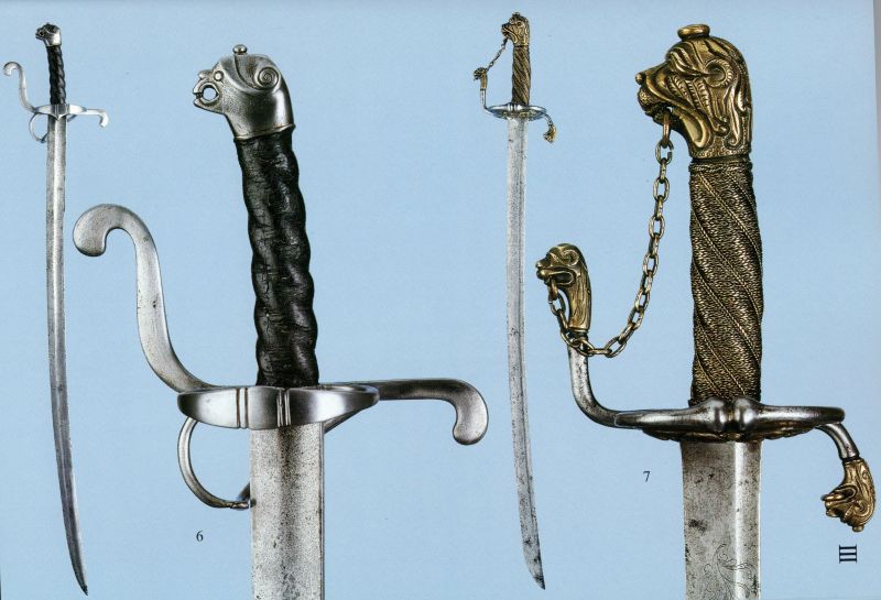

Posts: 1,268
@cornelistromp
here is the catalogue where I found the photos.
Best regards
Udo

Originally Posted by corrado26 View Post
@cornelistromp
Best regards
Udo
Udo, thanks a lot, best Jasper
