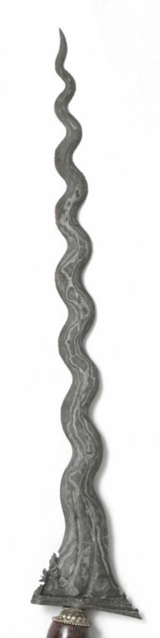

. Some wavy blades have very deep luk, similar to the one shown on the attached pic.
