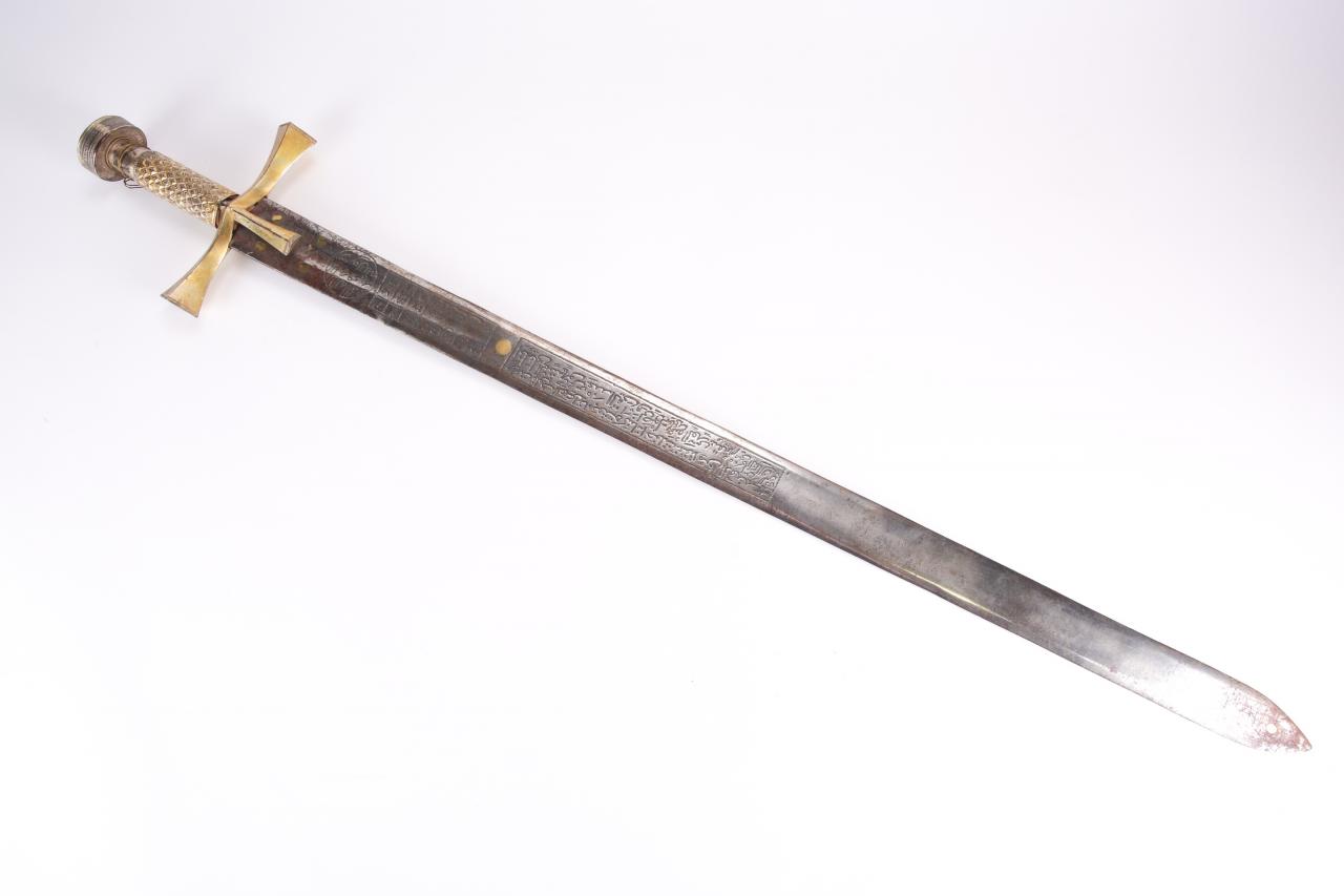

Default Ali Dinar(?) Kaskara

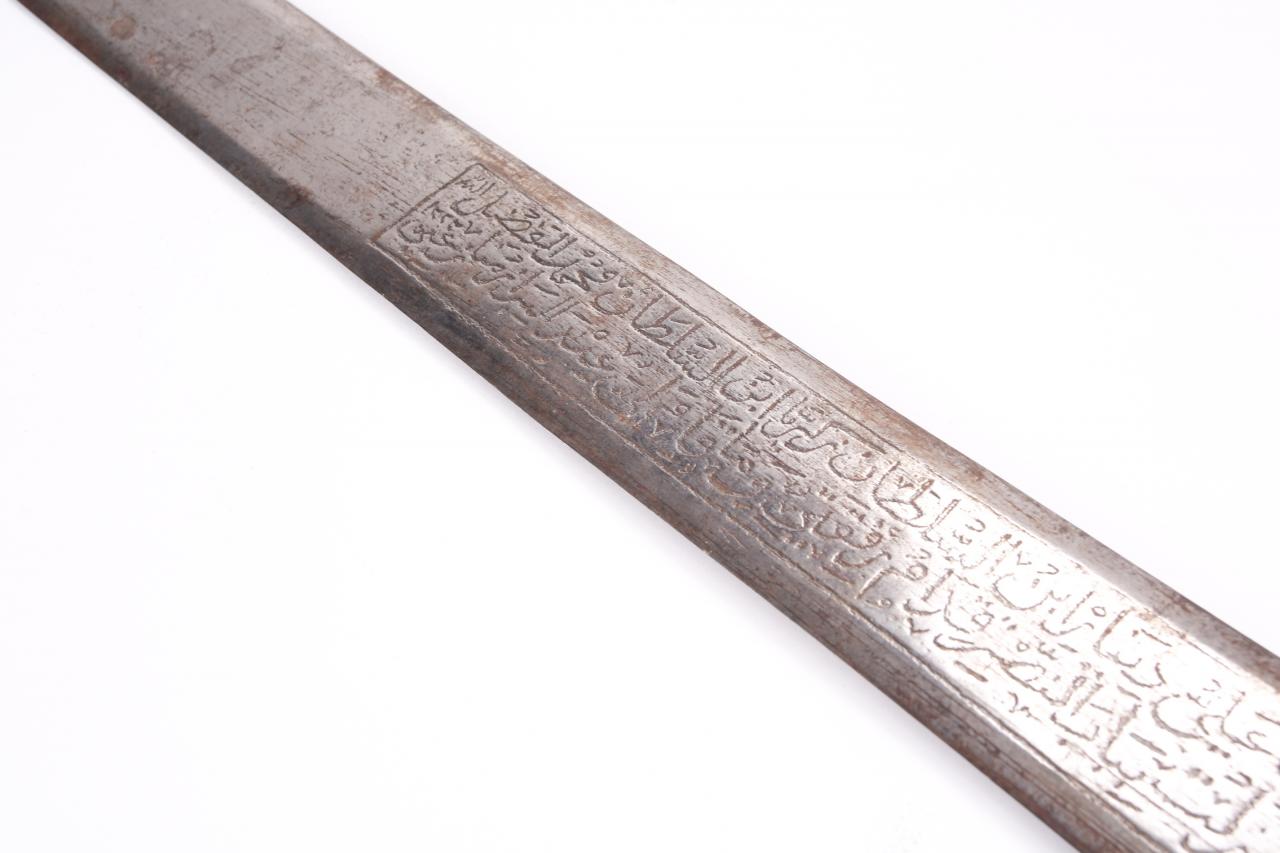

This recently sold at auction in the UK for £8,200.00. With premium that's nearly £10,500.00.
Old 30th October 2021, 06:44 PM   #2
My run-of-the-mill one cost considerably less - well under $100 with scabbard. Unless this belonged to the Mahdi, I think somebody with more money than sense got carried away during the bidding. Maybe the etchings will reveal a worthy provenance that justifies the cost!
Old 1st November 2021, 08:09 PM   #3
TVV
TVV's Avatar
Location: Bay Area
Posts: 1,770

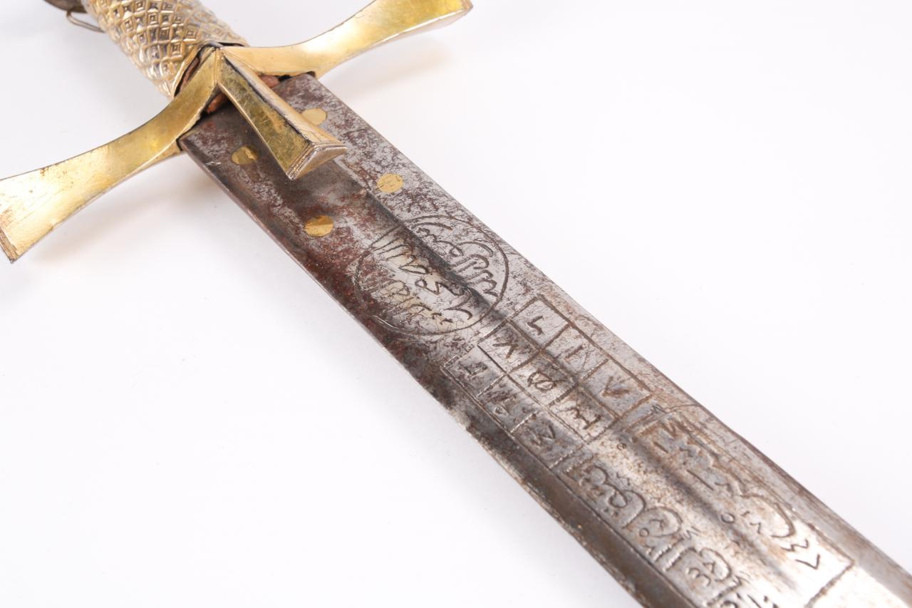

To be fair, this is a very nice kaskara, with a silver gilt pommel and a very high quality crossguard that also looks like it has been gilded. The blade looks like a 19th century European import and the brass (?) dot inserts are unusual. It is definitely a sword that belonged to someone of high status and could have been one of the many swords Ali Dinar owned.
To get to a high price at auction you need to have at least 2 people bidding on a sword, so more than 1 person must have put a lot of value on this particular kaskara.

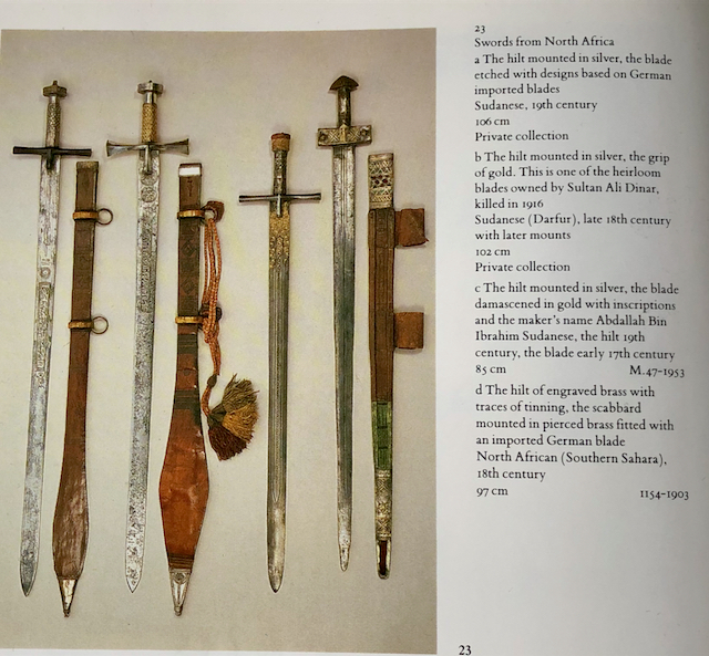

This sword has a remarkable resemblance to one in the late Tony North's book on Islamic arms (the monograph) and was attributed to Ali Dinar. When I asked him about it (this was some years ago) as I was doing research on another kaskara attributed to Ali Dinar, he indicated the photo in a grouping of four swords from Sudan, and this particular sword now belonged to a guy in Malaysia as he thought.
This was about 16 or 17 years ago. Possibly the sword has now come out of an associated estate. If anyone has that book the photo of four swords is in it (I dont have my copy at the moment).
As noted by Teodor, Ali Dinar had numbers of swords in his armory, so quite possible this is one considering its notable quality, inscription and gilt decoration.

I liked the look of this kaskara except for the goldish/brass dots which I thought looked crude and unappealing to the point that I wondered if they were a later edition to ''flash'' up the blade or to differentiate it from the many similar.

According to the auctioneer the dots are a 'gold alloy'.
regarding the posts about only needing 2 bidders(I also collect ancient coins) a Naxos tetradrachm recently achieved approximately $740,000NZD at auction(I only kept a note after converting to NZ dollars),the coin is rare but the sale price is insane
regards
Andrew Freeston
Gold or gold metal filled dots have certain significance on Islamic blades as described in Yucel ("Islamic Swords and Swordsmiths", 2001). These appeared in varied groupings and numbers, however seem to have usually been situated toward to blade tip. I have seen certain cases where some kaskara, otherwise quite plain, have had such 'dots' near the blade tip, but were most likely brass filled.
In Islamic symbolism and allegory it seems numbers are key, so it is hard to say what specifically these dots might mean, but they are likely placed there to augment the inscriptions and invocations on the blade.
The five dots can mean the Five Pillars of Islam.
The second interpretation of the five points is the family of Muhammad: Muhammad himself, his daughter Fatimah, his son-in-law Ali, his grandchildren Hasan and Husayn.
In favor of the second version, I think it will be that a separately located point is larger than the others (Probably a langet prevented it from being placed in the center of a square of four points).
Perhaps translating text between dots can help (excluding the "magic square").

On one of the photos there appear to be two more dots towards the tip of the blade, so it might be 7 instead of 5 dots altogether. A reference to the seven sleepers? We probably will not know for sure, but it is fun to speculate.

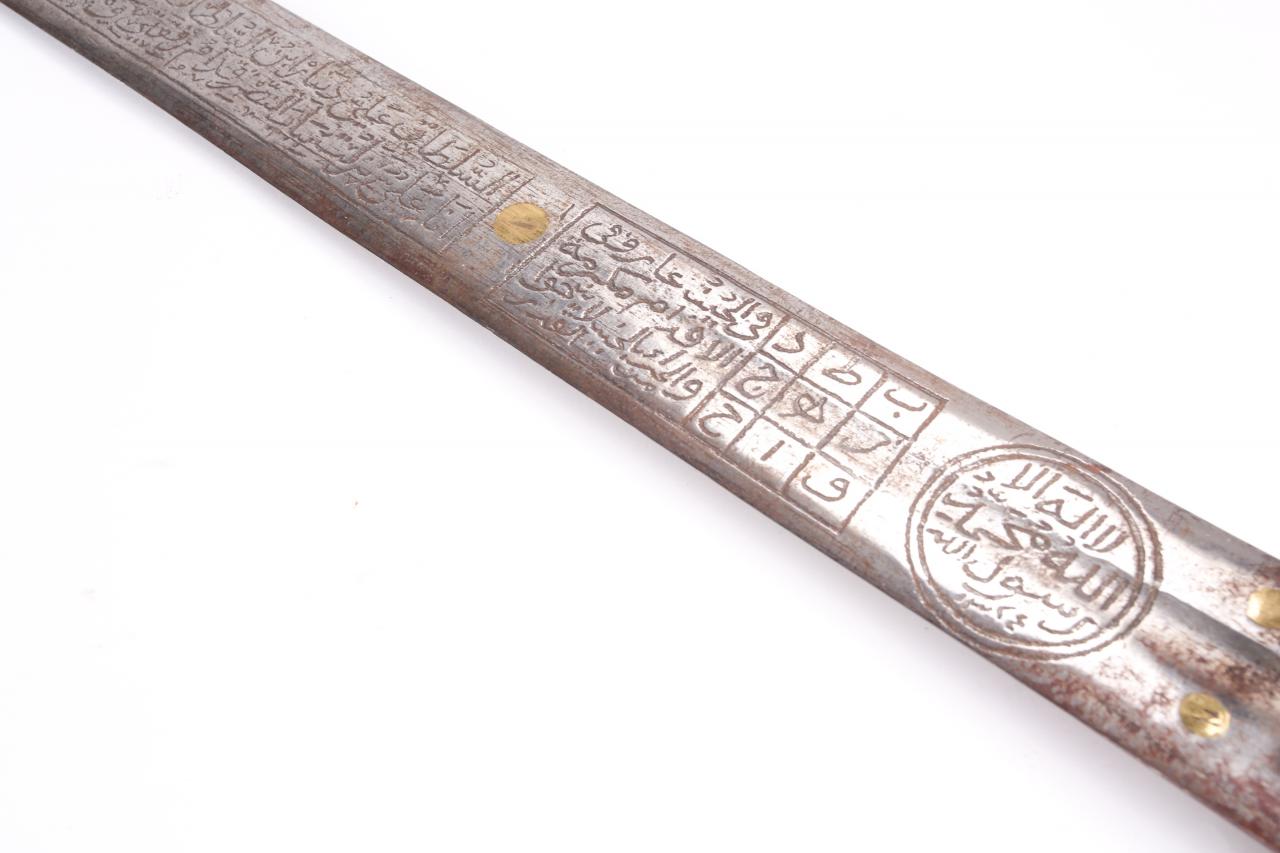

Teodor
Thank you, Teodor. I didn't see these two dots before.
Without these dots, I had another beautiful interpretation of the five dots:
the hand of the owner of the sword is led by Muhammad himself, followed by his family and only then by the humble owner of the sword, modestly fulfilling the will of the Prophet.
But now I'm at a loss. Who are the two at the tip of the blade?

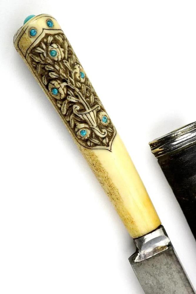

But look at the photo below. Recently, Marius showed his Ottoman kard.
On its handle is a Tree of Immortality with the same arrangement of five dots. And two separately outside the composition.
I think they should also be considered separately on the sword blade.

Just adding the picture Jim mentioned in post #4 from Tony North's book, 'Islamic Arms' p30.

That was "Introduction to Islamic Arms " (1999).
I recall talking with Tony North while I was researching Ali Dinar kaskaras as I had come across one said to be from his armory, and asked about the one in this sword grouping. He said he believed it was then owned by a collector in SE Asia or Thailand? but had lost track of where.

You're welcome. I have the HMSO 1985 print which only has 'Islamic Arms' on the cover - but you're right, inside the title plate says 'An Introduction to Islamic Arms'.
If anyone wants to read the book you can borrow a digital copy by the hour for free from The Internet Archive by setting up a free account.
