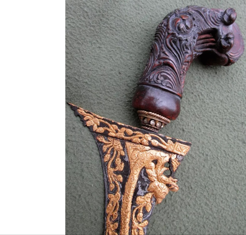

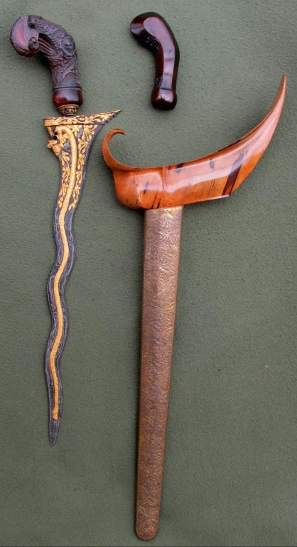

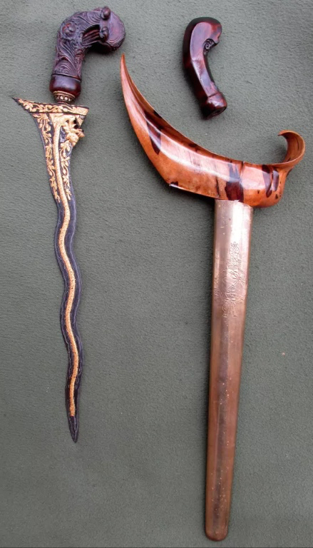

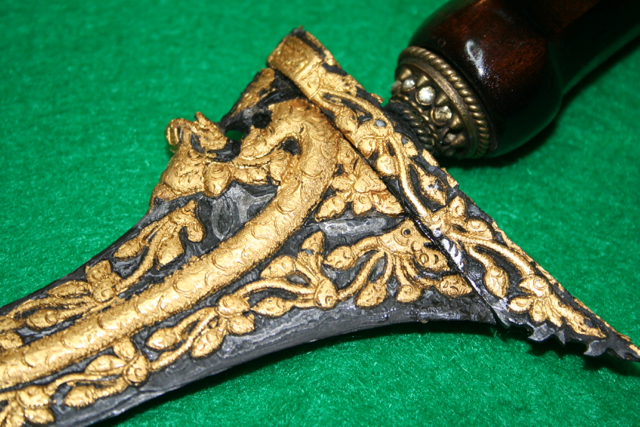

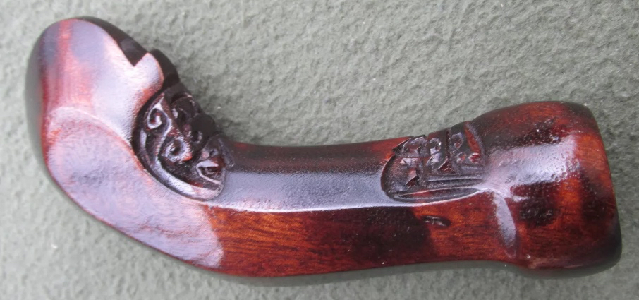

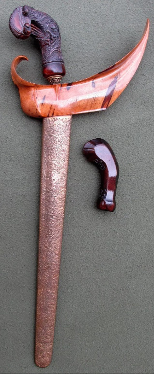

I would like to solicit comments and opinions about this Keris. I believe it is from Java. Is this a tourist souvenir? Any ideas about it's age? It came with two hilts. I am curious if the fancy hilt is appropriate for this knife or if I should stick with the more plain one. I believe the fancy one was purchased separately. TIA!
Harry
harrywagner is offline
Old 13th December 2015, 07:40 PM   #2
Henk
Henk's Avatar
Posts: 1,209
Very nice keris. Certainly not tourist stuff.
I believe the naga is done with gold because the copper stuff looks different.

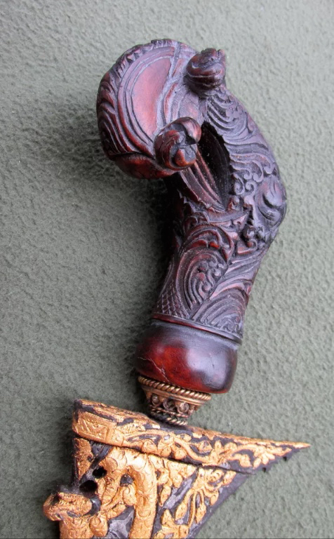

Stay with the plain ukiran. The other one is a madura ukiran. The keris is in javanese dress.
The keris itself is maybe not very old but a lovely piece in my opnion.
Well done!!

Thank you! That helps me a great deal. I like it also and am reasonably certain the gilding is gold. My fingernail has no effect on it and the blade is heavier than the other three Keris I have, which I attribute to the gold. I would not have been a bit surprised to discover it was a tourist item, and am thrilled that it is not. I'll swap out the hilt for the more traditional one and park the one from Madura on my desk. Thanks again. Much appreciated.

I agree with Henk.

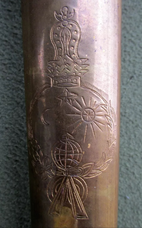

However, that mendak really should be replaced, it ruins the whole presentation. This type of mendak is very low quality and detracts from an otherwise pretty OK keris.

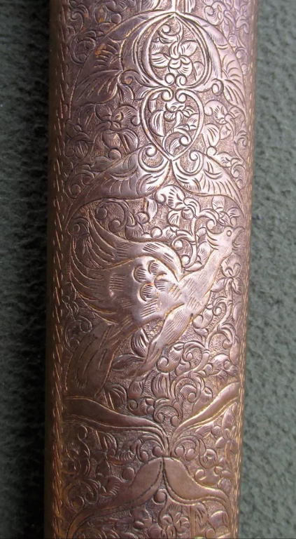

What is the material in the pendok?
The crest on the back of the pendok is the crest of the Surakarta Karaton.
The posted photo shows a nice quality mendak, not highest quality, but good middle quality, heavy silver and natural stones. Something like this would make a world of difference to the presentation of this keris. The hilt is tayuman baru, maker was Sutejo.

Thank you! I was hoping someone would recognize that crest. I believe the pendok is brass. I know little about the piece. I bought it, and another I posted previously, on faith alone. i am relieved it is not a tourist piece. My "wall of shame" is getting pretty crowded. Thanks again. I appreciate the help.

Yes Harry, i wouldn't call this a tourist keris piece, however i wouldn't make any assumptions based on the crest that it is a Keraton piece either. Seems a contemporary piece to me, but created with at least some integrity. I like the repousse work on the pendok and that's nice pelet wood used for the sheath. Definitely swap back to the simpler planar hilt and see if you can find a nice mendak and this one can avoid the "Wall of Shame" for sure.

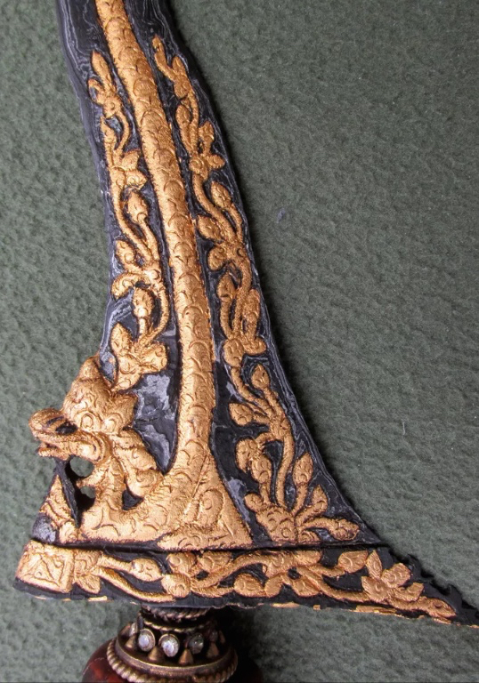

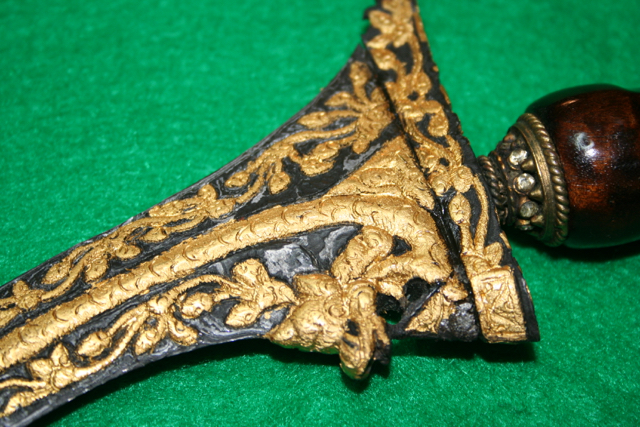

Harry, one of the things I do when I appraise a keris is to examine it very closely using a 3X loupe under good natural light. You can see a lot that you cannot otherwise see.
I suggest you have a close look at the gold that has been applied to the surface of this blade.
There are several different ways to attach gold to the surface of a blade, it is probable that the gold on your blade is a very, very thin layer of foil that has been attached in a similar way to koftgari. Sometimes a little bit of adhesive might be used where where the foil will not stick.
The total weight of the gold will be very small.
This keris is a bit heavier than your others because it is a current era keris, and the raised areas of carved steel, needed to support the gold add to the weight.

I am sure you are right. It is difficult for me to tell looking at it under magnification, but I can take some gold off with edge of a dime. I have to be a little vigorous but it does come off, so it probably is pretty thin. Here are some macro photos that might help. Many thanks for your help!

Yes, gold paint can be used, but this is the worst and cheapest of jobs.
In Jogja back in the 1960's and through into the '70's they glued the foil on.
Another way is to apply brass, carve the brass and gold plate it.
Another way is to use fire gilding.
Then we have genuine kinatah work, which has a range of qualities.
Above this, and used mainly on the gonjo, lumps of gold are set in place by use of undercut holes cut into the steel, the gold is then carved.
More than one way to skin a cat, and finished they all look pretty much the same in photos.
