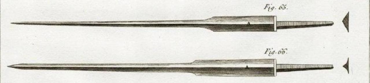

Has anyone seen flat bladed colichemardes retaining a smith's marking and if so could they let me see them?
Curiously, Diderot does not show this style; and equally, does not show the style with the rolled lower groove that would eventually predominate. See attached for what is shown:
