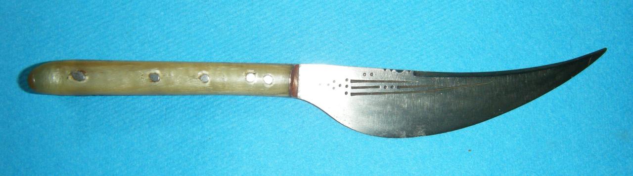

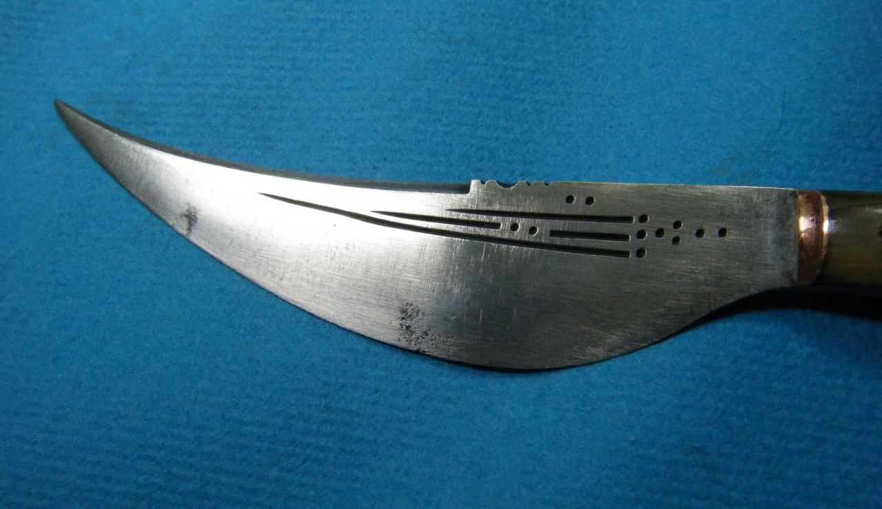

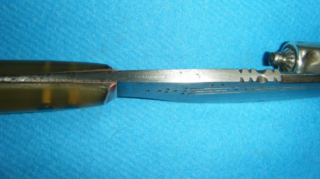

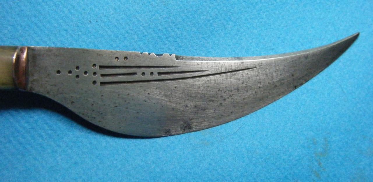

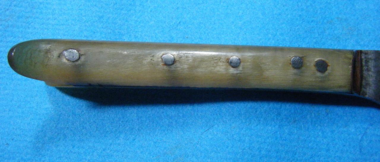

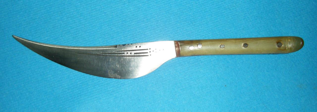

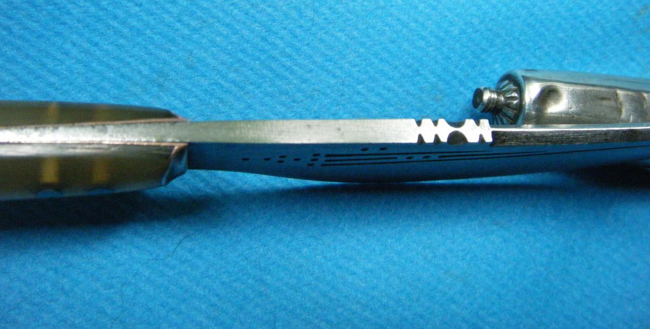

I've won this little knife in a lot, my main interest was for an other knife, but after a little bit of TLC it's a small beauty, very well made, cow or goat horn scales, fine copper bolster and a very well worked blade.
I am not able to pinpoint the exact origin. Greek, Black Sea, Bulgarian, Balkan? I don't think I have seen a similar knife before.

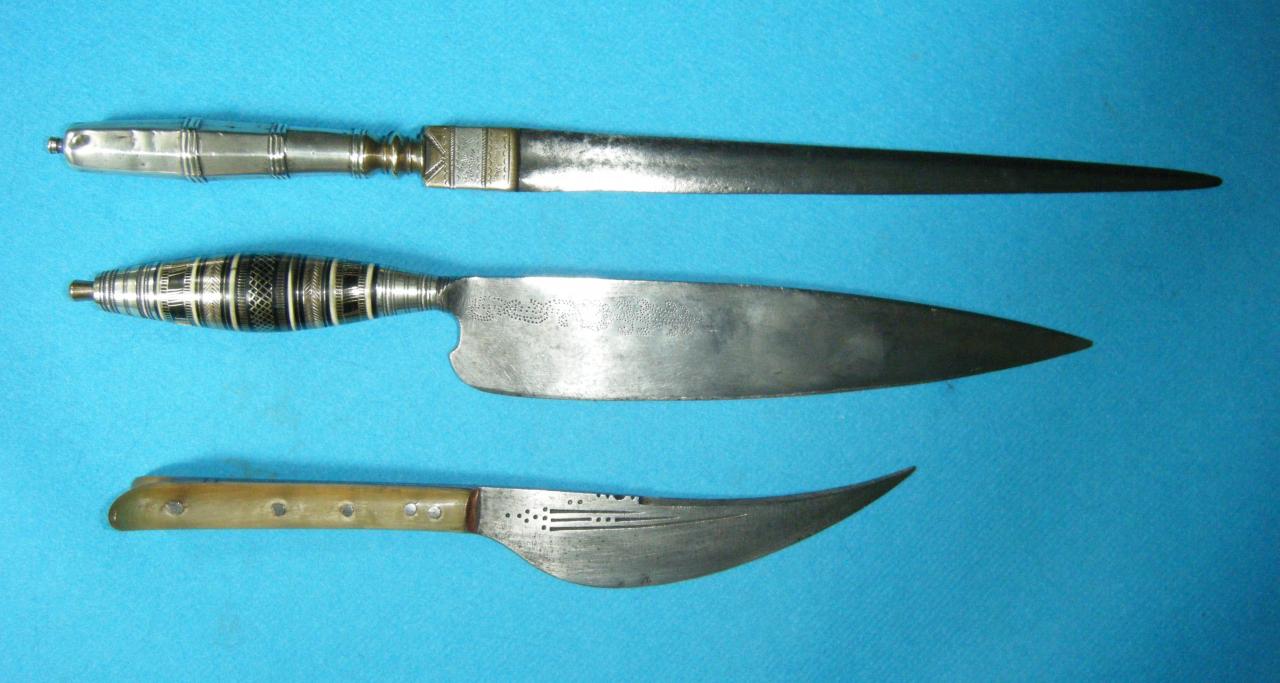

It's 21,5 cm overall, blade 12 cm, blade is 3,5 mm thick short after handle scales, weight: 63 gram. Last picture shows it together with a Faca de Ponta and a Canary Island knife from the same auction for size comparison.
Is someone able to tell me more about this knife? All comments are very welcome.

Posts: 105

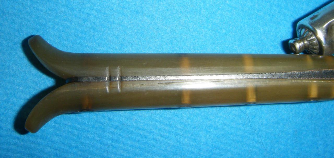

Sajen, my humble guess of its origin would be the area near Northeast Turkey. The bifurcated horn pommel and blade decoration reminds me of the laz bichaq swords (Black Sea Yataghan). Interesting little knife though!
-Geoff

Really like the Faca de Ponta! Nice catch!

Thank you Stefan! I will show it by time with some other 19th century Faca de Ponta.

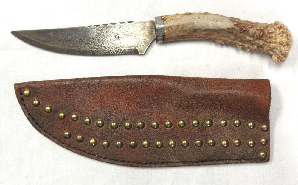

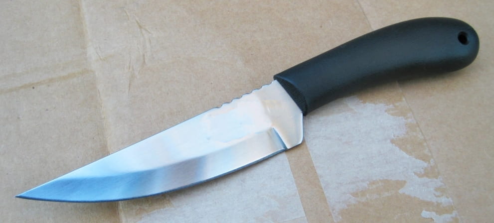

Reminds me of the Roach belly trade knives popular in the18c N. Americas. It is naturally, not from there - i'd go along with Turkish asia minor. Nice knife. (In this context, the 'Roach' is a rounded belly fish, not the insect.)

Thank you Wayne! I think that the Trapper knife will be bigger!?
I guess that my one is from the Black Sea area but it's just my guess.
Old 30th December 2021, 02:01 PM   #12
Mine has an 11.5 cm. blade

Posts: 1,918
Like Geoff suggested, clearly a knife version of a Laz bichaq.
The overall shape of the blade, the engravings on the blade and the bifurcated horn hilt are all consistent with the attribution to the Laz people.

Old 30th December 2021, 08:55 PM   #15
Thank you Marius! I was unsure but your clear statement convinced me.
