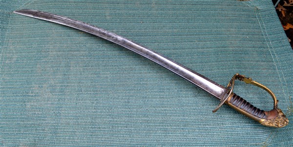

Default British M1803 Flank Officer's Sword with Modification?
Pictured is the classic M1803 Flank Officer's Sword, however, its blade is only 26" long from the tip to the top of the guard and 27.25" long along the spine; the problem is that the blade should measure 32 & 3/16" long.The 1796 British Regulations stated that the sword had to be at least 30" long and no less than 1" wide. The M1803 is a magnificent sword with a blade and tip made for slashing, so at first, I thought that maybe the tip had been broken and it had been armory repurposed for some auxiliary native troops, however after scouring the internet, I found 3 examples that had been shortened, professionally as mine was after the fuller. I then read accounts of actions where the sword was excellent for slashing, but it was lacking in the thrusting department. I further read that in1822 the M1803 was replaced with a straighter sword that was better for thrusting and in line with British Sword Training. Another source stated that this sword was adopted by the Royal Marines and some Royal Navy Officers and as such, I can see the effectiveness of a shorter sword repointed for thrusting.
So, after my convoluted rambling, does anyone know whether these swords were officially shortened, en masse by the British Army, used by the Royal Marines, or if I just have a repointed sword with a broken tip?

Hi Drack,
That is a neat 1803 you have there, does it have a maker's name or cutler on it?
To answer your first question, the tip of your sword wouldn't have been officially shortened. These were never government property and private purchases by the officers so if it had been shortened, then it would have been done by a past owner.

Thank you very much for your very detailed and informative answer. Sorry, I can not find any maker's names, and the mottos " Dieu et non Droi," & "Honi Soit qui mal y pense," are very faint.
It makes sense that since each officer was responsible for his own gear, then there could be a fair amount of personal variation within the regulations, however, what struck me upon searching the web and finding numerous M1803 swords, was the fact that 3 examples were shortened at the end of the fuller in a similar tip configuration. It just didn't seem random.
Also, were these swords ever used by the Royal Marines as one internet source stated?

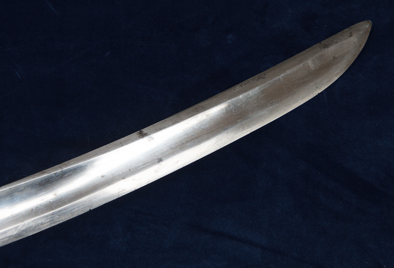

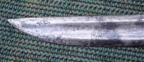

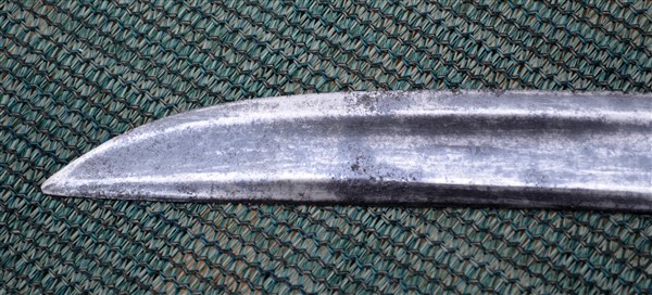

I see nothing to indicate that the blade has been shortened. The corrosion on the tip matches the rest of the blade. The point is done correctly and has corresponding fasle edge. It appears to have been made this way most likely for an officer of shorter stature. I would be interested in grip measurements as it appears to have corresponding size to the blade but with photos you can't be sure.

The reason why I thought that the blade had been shortened was that the tip lacked its distinctive slashing configuration & was seemingly made more into a thrusting sword.

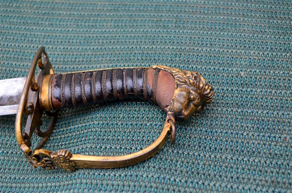

The handle measures 5.75".

The tip is a slashing type just not quite a hatchet point. If it was a thrusting tip the back of the blade would be ground down somewhat like what the British did to their 1796 HC swords. These swords as another member pointed out vary greatly, no pun intended.

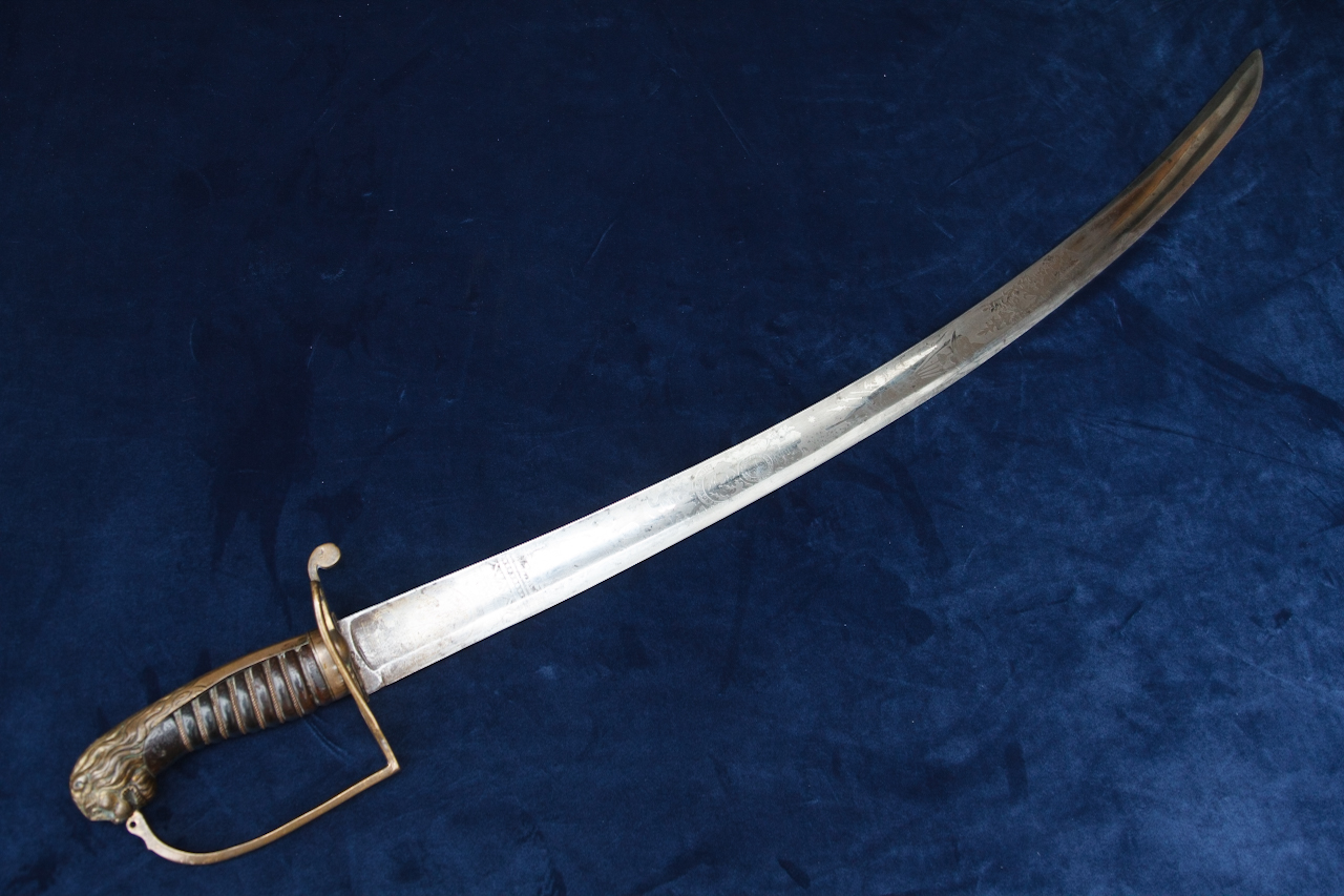

Like Will says, that style of tip is fairly common on British swords of the time. It creates a light but stiff blade.
My non-regulation grenadier officer’s sabre has the same style on a 830mm blade. And I’ve seen it on 1788 Pattern cavalry swords, hangers and flank officer sabres.

A picture is worth a thousand words; it is nice to see another sword here on the thread with a similar tip to confirm my suspicions(and to allay my fears), that this purposely period done and not a backyard conversion for a broken tip.
