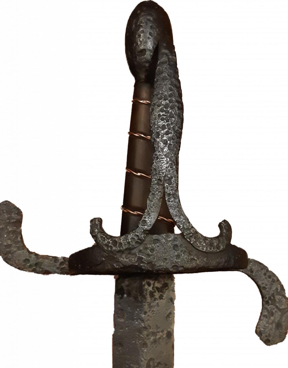

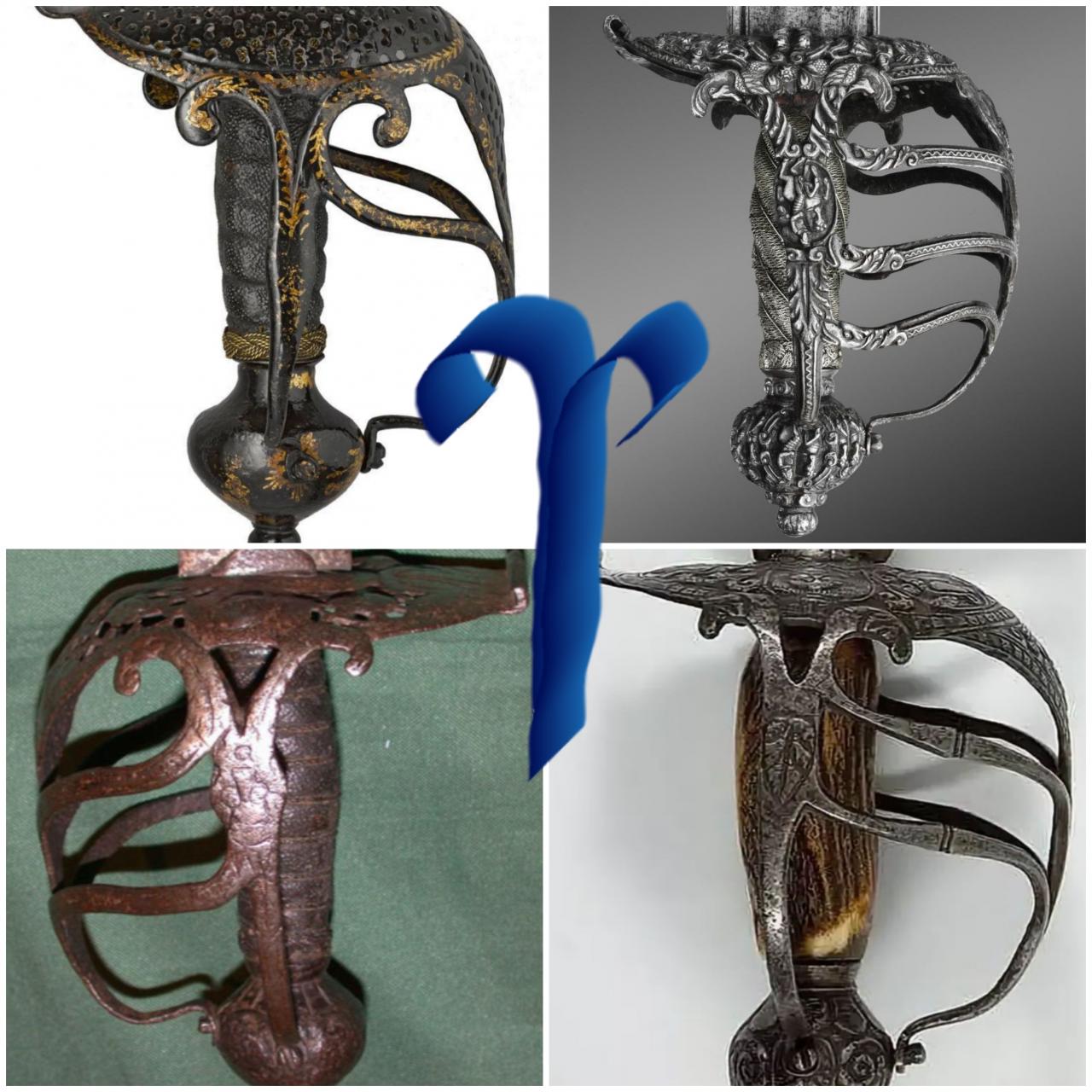

good afternoon, on some swords of this type there is such a sign on the defense, which is the main decorative element in the design of the hilt, or an independent element,
question: is there an understanding of what this symbol means?
in the collage, the top two hilts are attributed to Cromwell. collected from the Internet.
with respect, and I wish you all good health

I'm not sure which element you are referring too. In English, C19th collectors named these 'mortuary ' swords because some of the typical faces, often with the mid C17th 'van dyke' moustache, supposedly commemorated Charles I, but that isn't true. Mine has a range of faces, one of which looks like a woman and another more like Jesus than Charles I!
If you mean the small side branches with the curled ends, then they are also typical of the style.
The black/gold one is supposedly carried by Cromwell in Ireland, but the provenance is unlikely.

I believe Elmereya was referencing the 'ribbon-like' feature of the basket guard, as per the blue 'ribbon' drawn in the middle of the four example pictures. I never picked up on the fact that this feature is oft repeated on these swords, and look forward to seeing what interpretations this forum may yield. My first thought was that perhaps a ribbon of this shape was worn as part of the grieving process - but then I recalled that the term 'mortuary' swords is a collectors' phrase, and that these were not actually swords of mourning.

thanks for your attention to the topic, yes, I'm talking about this element in the form of an anchor,

Elmereya, I very much applaud your interest in the often subtle symbolism which may exist in the hilt elements in many well known sword forms. These kinds of symbolism do seem to exist in some cases, but there is typically a great deal of consternation toward ideas suggesting them.
Your suggestion regarding the anchor etc. is interesting, but in this case I am afraid unlikely in the context you suggest. Noting that, I would never consider such thinking far fetched or other, in fact, often this kind of thinking has led to interesting understanding of weapon forms and styling.
These scrolled ends are virtually characteristic of these types of hilts in English swords typically termed 'mortuary' for the conception that the facial figures represented Charles I who was executed in 1649. The scrolls often on the side knuckle guards, do not occur on many of the variations, and these type swords were used by both Royalist and Parliament sides in the Civil Wars.
Mazansky (2005) has an entire chapter (11) illustrating a wide scope of these hilts, which offer good view of the variations. The book however, does not speak to symbolism or such matters as its intent was to put together a typology and categorization of the basket hilt sword.
Norman ("The Rapier and Small Sword 1460-1820", 1980) offers notes on hilt styles as well, but again offers no suggestions on symbolism.
What I have discovered is that in many cases, if not most, hilt elements and structure are more inclined to aesthetic inclinations. For example, on Scottish basket hilts, many which have the large 'S' incorporated into the guards.
While many thought these indicated 'Stirling', some 'Scottish' (?) but this did not hold true as many were from Glasgow.
The element termed 'rams head' in these hilts also has no shown indications of any particular symbolism, the term simply descriptive of the shape.
The piercings often seen in the shields of these hilts have a degree of symbolism however with Jacobite symbolism.
On the c.1780s spadroon hangers in England which had a five ball grouping on guard and knuckleguard, I had thinking similar to yours and suggested a possible Masonic connection due to the numeric consistency. When I approached the author of a well known book on British swords, he regarded the notion as fanciful and this was simply aesthetic decoration. This of course remained unproven, but the idea seemed quite plausible.
With the scrolls on these British hilts , there was a propensity toward neo classic themes and styling, often having cherubic faces, acanthus leaf vegetal motif, and these scrolls resemble Ionic capitals, so perhaps this aesthetic might be toward the decor.

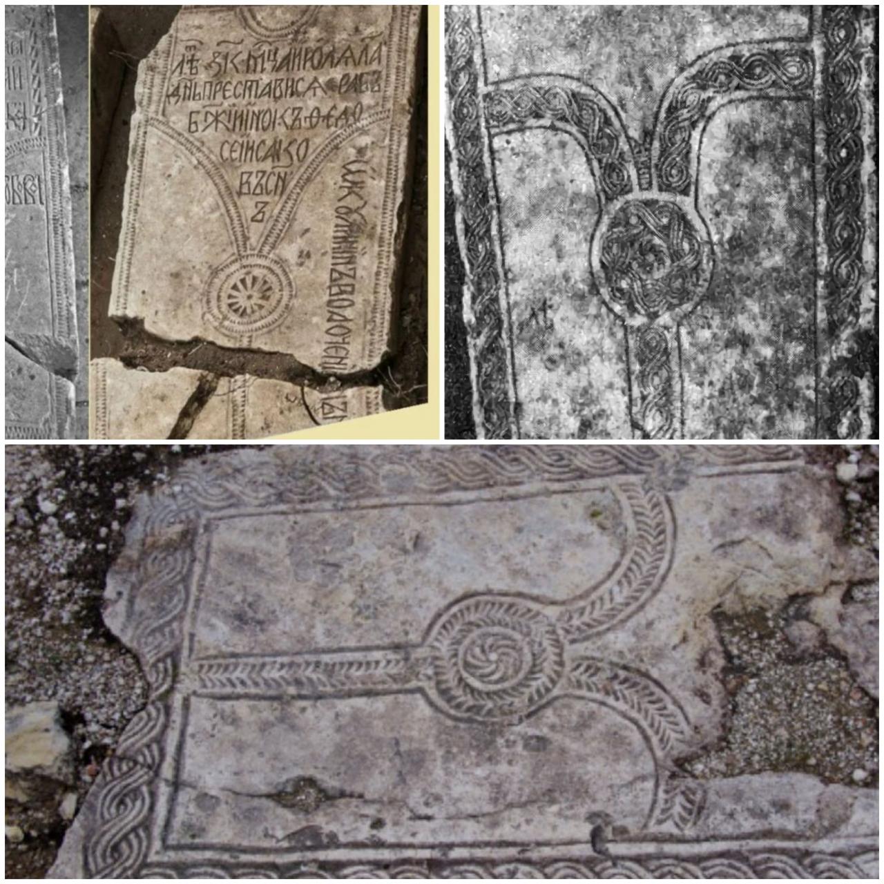

Yes, yes, this is exactly what it is, of course and probably, the further back in time the object and the more symbolic and not entirely obligatory or not very important a certain symbol was during its existence, the less initial information about it reaches the present, it probably works something like that, although only some 400 years ...
this means that researchers will have something to do in the future.
Here, for example, too, a similar, if not identical, symbol on gravestones from central Russia, dating from the 15-16th century,.
there are many of them, they were laid in the foundations of temples built at the beginning of the 18th century, paths in monasteries were laid out with them, and they are found even in the laying of church fences. that is, until the beginning of the 17th century, for more than one century, the symbol was known and respected by everyone, and then abruptly and immediately - since no one knows or remembers anything, ... modern official historians (in Russia) have no reasonable official explanation, and after all, too, some 500 years in total, but alas.
it just goes to the topic of a similar symbol.

Of course, I'm not talking about the fact that the element on the sword and the symbol on the stone are one and the same.
just showed such artifacts, which, unfortunately, are forgotten ..
Sincerely.

We crossed posts! Great images on the stones, and pretty compelling evidence. Nicely done!!!!
