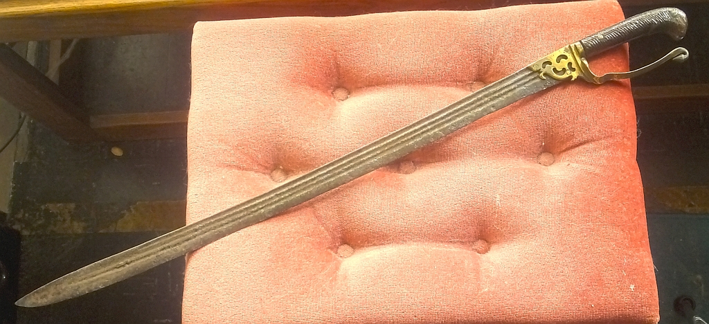

Does indeed remind me more of mine, tho your example has more decorative grip rivets...

(cont.)...Than a khanjarli

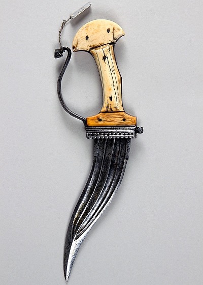

The area that would show the pommel may be a khanjhar, as these often had elaborately styled pommels.....but in this area of the image, there seem to be two surfaces in the area of the pommel.
I see why you are asking for a more reliable image of a 'khanjharli' in context, and that the identification with this photo of Sikh warrior suggesting that weapon seems misplaced. No small wonder with the 'name games' with these weapons and errors beginning with Egerton (1885).
