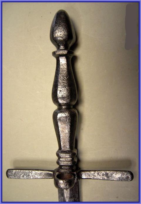

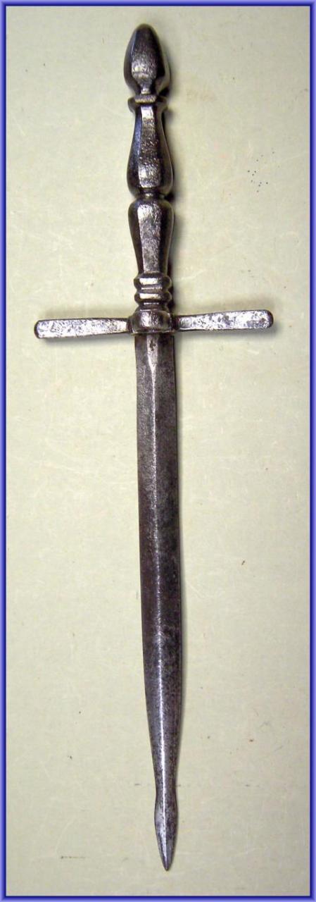

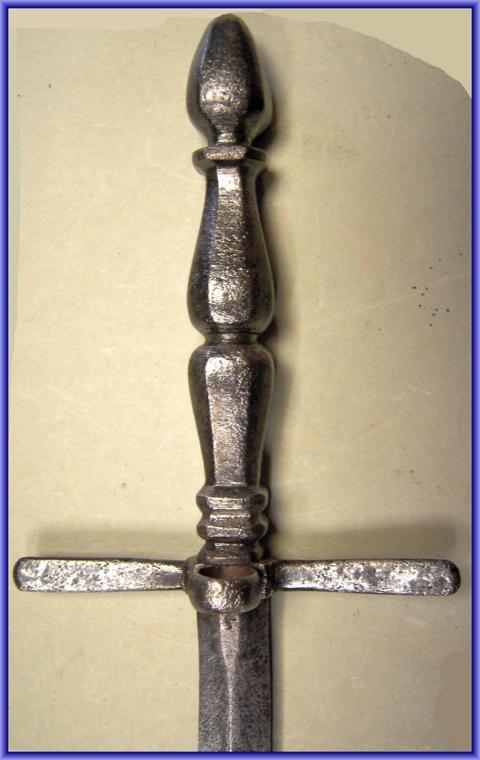

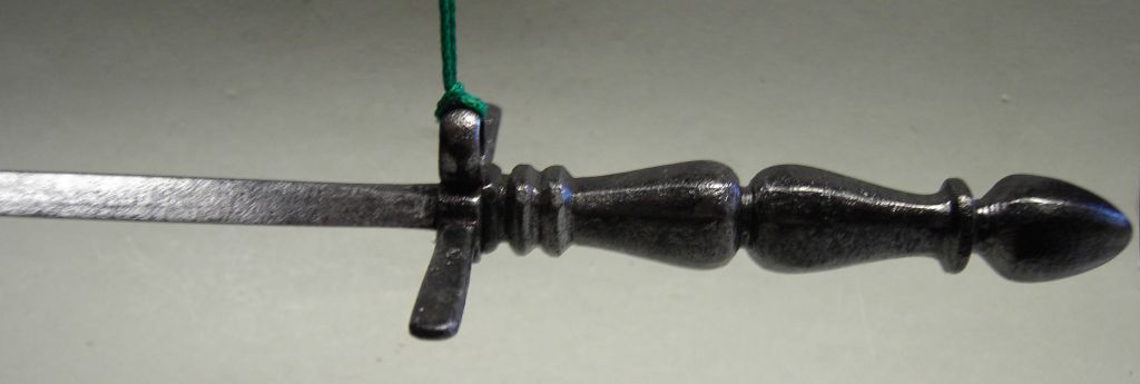

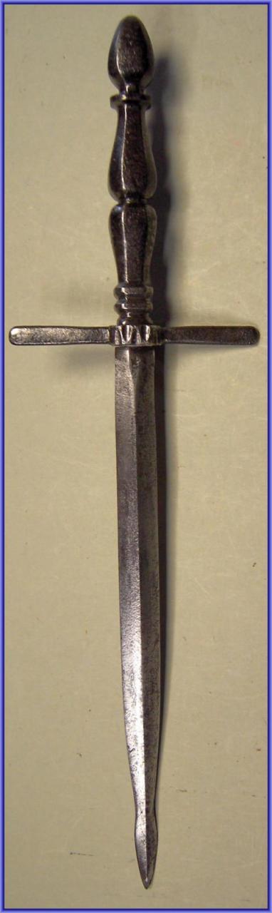

Left Hand Dagger? That's the question. Got it today and like it but would like to know what others think about its age and origin. Total length 357 mm, length of blade 230 mm. Interesting is the recess shortly before the tip of the blade and what was its purpose.
Old 29th September 2021, 07:32 PM   #2
Interesting piece. Whether it is a left hand dagger, the ring says yes. Is the blade tip 'bulky' all round, like in hand weapons made to perforate ... mail or armour ?
We know the primary purpose of the left hand dagger being that of parrying the adversary blows, it also serves as a stabbing weapon as a resource in a sword fight.
The guard rather atypical and so is the grip. I wonder whether some of our members are familiar with this dagger shape.

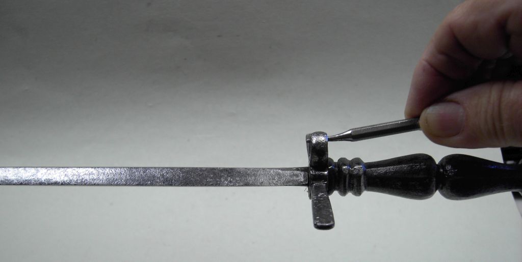

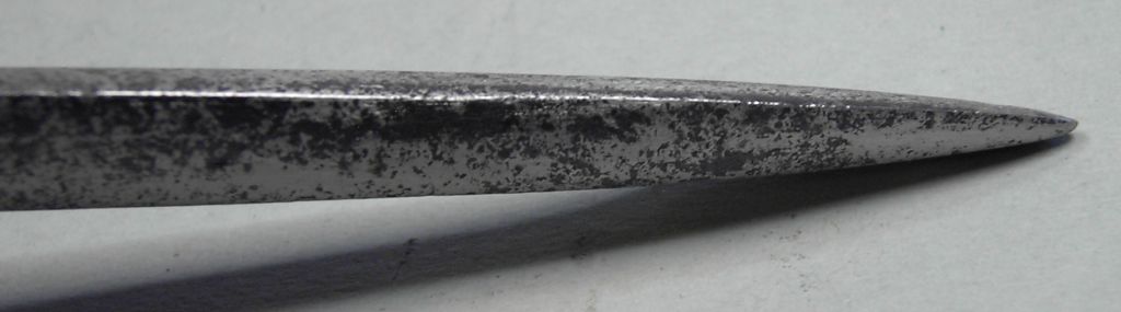

Some additional fotos of the dagger's tip of both sides and fotos which demonstrate that the dagger is very well balanced.

Old 30th September 2021, 11:01 AM   #4
Interesting; the recess occurs in the edge sides but not on the ridges.

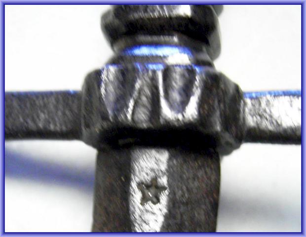

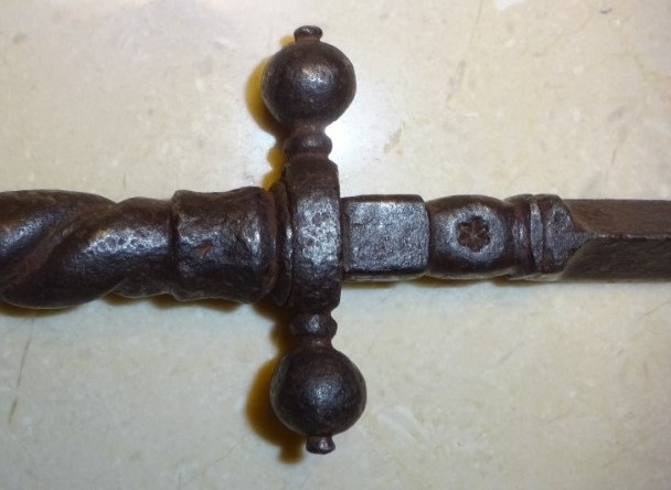

It seems most of these had fluted cylindrical grips, a lot of those German with the ringed guard like this, but the styling on this hilt is most unusual. The blade with what seems almost like an armor piercing point is as well. The ring indicates this was a fencing dagger, as a guard to protect knuckles if an errant blade slipped in a parry.

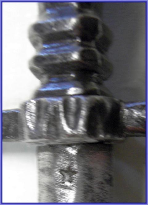

That 'star' ,mark on the guard it seems I have seen somewhere, but the only mark like it in a stand alone situation is from a non illustrated knife in "Knives and Scabbards", (Cowgill, de Neergaard, Griffiths, 1987, #174) stating it is early 15th c. Naturally this is a bit early for this dagger, but thought it worthy of mention.....the region unfortunately not stated but mostly from British excavations.

Default The star mark
The Toledan Almaus, father and son, used a star for mark and so is a star in my centoventi; but both are distinct in shape with the one in Udo's example.
Old 1st October 2021, 05:07 PM   #12
Posts: 10,857
I agree on the note this is not a stilletto, especially not Italian and not the gunners stiletto, with narrow blade as Fernando describes to insert in touch hole if emplacement overrun...to 'spike' the cannon.
The flared tip, seemingly armor or otherwise piercing enabling.....this was not just for armor, but heavily padded textiles often worn.
Fernando, the 'star' on the example shown is a 'pentagram' with five points, not the asterisk type used in Toledo. If the five point star existed over a century before, it does seem possible of course to have still been in use somewhere.
The classical styling of the hilt does suggest Italy or Spain as context, but hard to say for sure. An anomaly to be sure!
