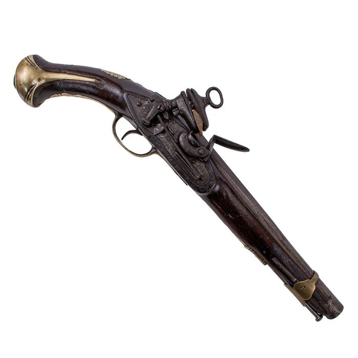

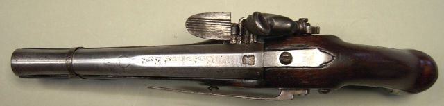

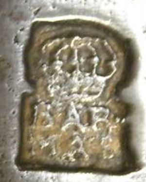

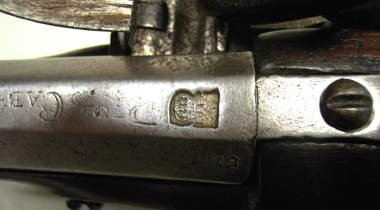

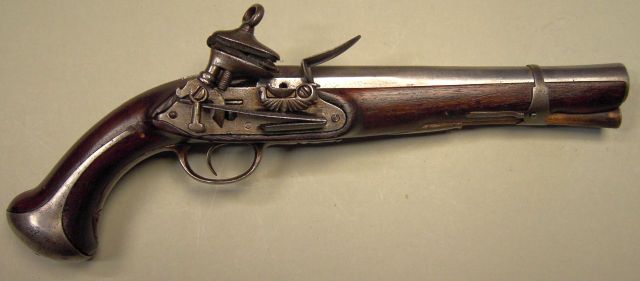

Just to show you a new addition to my collection and to ask your comments. It is as I know a miquelet pistol for the Spanish light cavalry or husars M 1789. A letter "C" at the lockplate says that it was supposedly made in Catalonia, probably at Ripoll. On its barrel besides a regimental signature there is a crowned mark with the letters "BAR/MAS" that I cannot identify - perhaps Bartolomeo Mas?. May be that somebody is able to help.

I am looking in a book at a 1800 Husar pistol, with a 1789 lock. With the barrel with a crowned C for Cataluña, inscribed R. CBA.D HUSS. ESPS..But the punzon in this one is DOM-MAS (Doménech Mas, Ripoll). Could it be family ?

Ramiro Larrañaga "Sintesis Historica de la Armeria Vasca", pagina 263
"MAS Domingo - Catalan Fines del XVII y prinmcipios del XVIII. Unos sesenta armeros de este apellido aparecen en Ripoll entre los siglos XVIII y XIX"

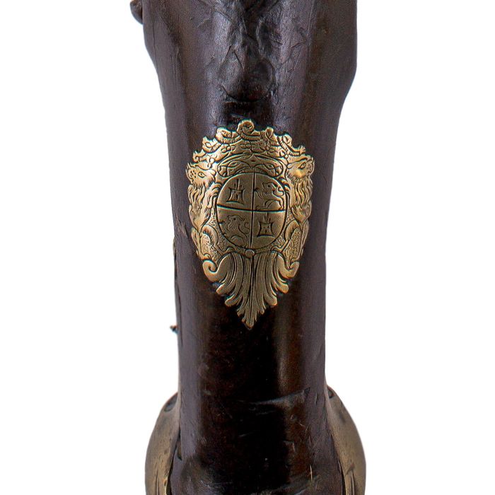

In the gilded shield at the top of the barrel I have JPP RUIZ, still unidentified.

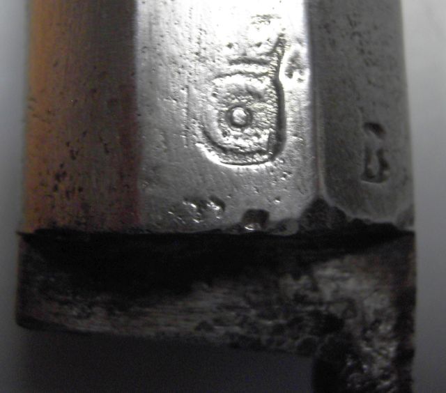

On the bottom of the barrel, I found the year of making (1788 for me)

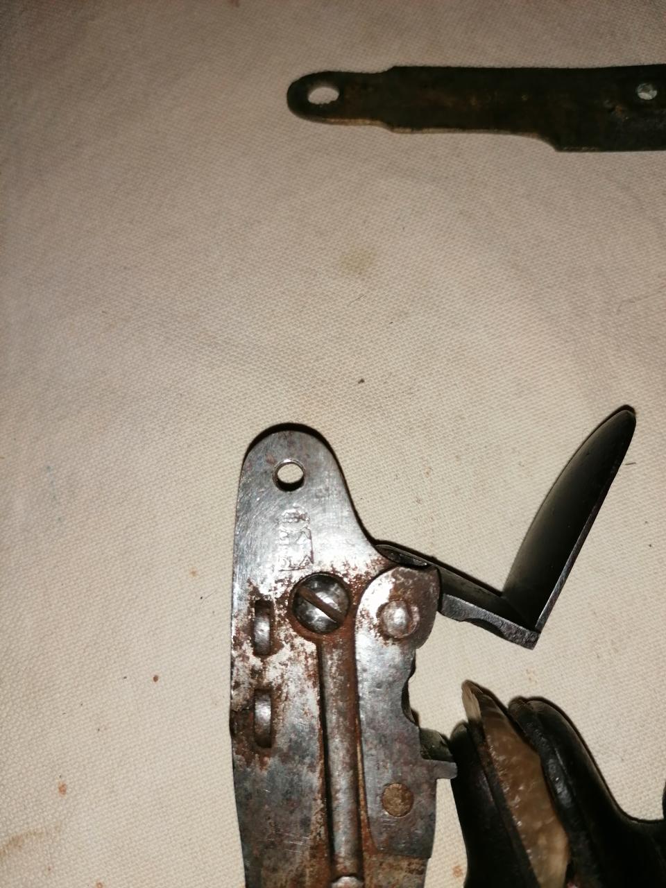

and the inspector mark (G for me).
On the inside of the battery there was the maker (Gabiola for me).

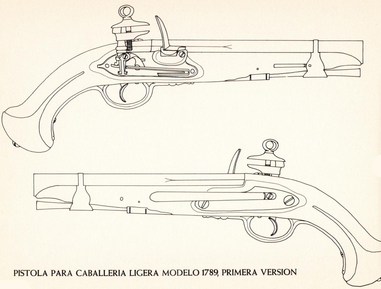

There have been two different versions of this pistol, the first version has iron mounts, the second has brass mounts. See Calvo, lamina 6, aparejos: En hierro!

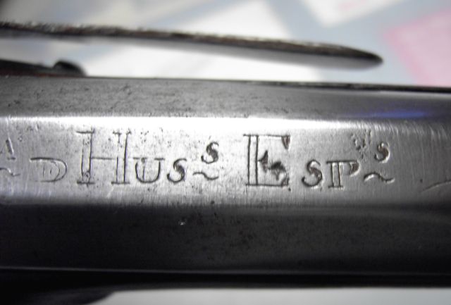

Udo, i would like to know if the inscription on the barrel does include the ESPS in the end.

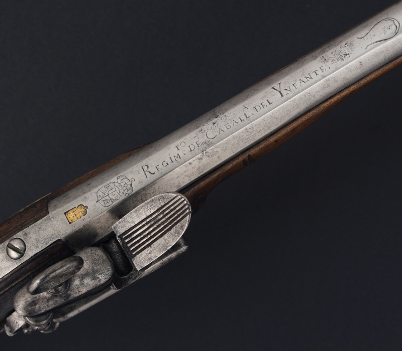

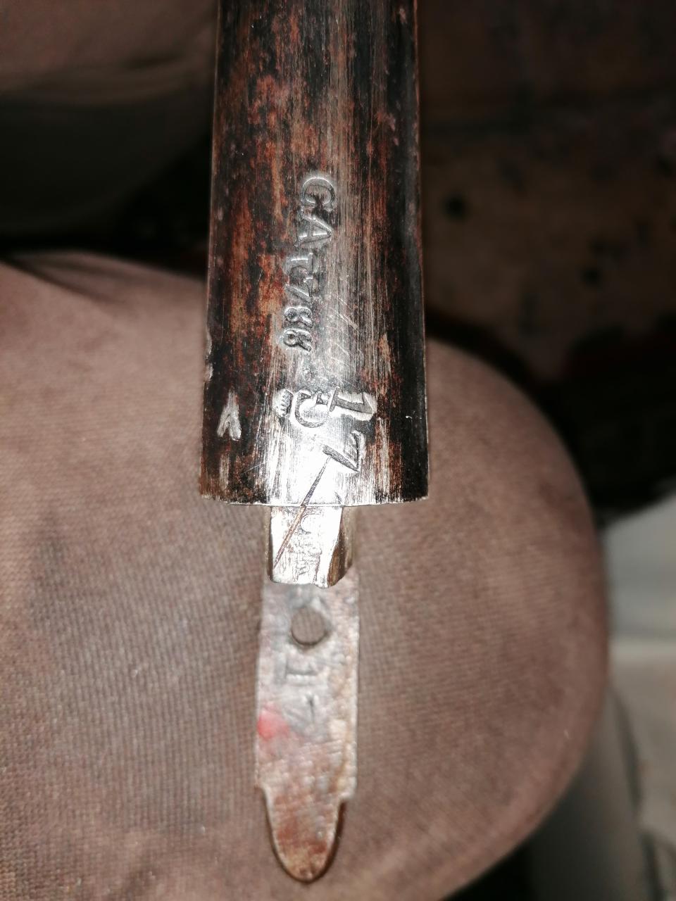

I made some telephone pictures the other day.
As I said, in the 1789 cavalry pistol model there are makings at the bottom of the barrel, hidden by the wood, and in the inner side of the lock.
I checked a Spanish Army State for 1805. Most Hussar regiments were formed in 1802 and changed into cazadores in 1805, but the one referred in here (husares españoles) was formed in 1794 and it still existed in 1805.

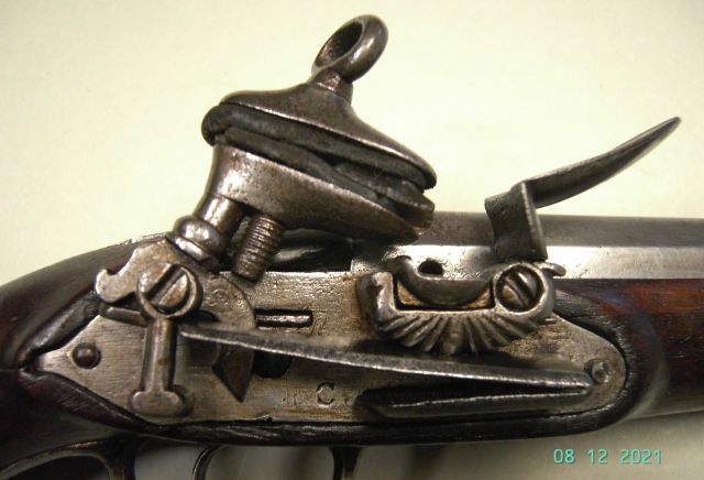

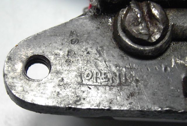

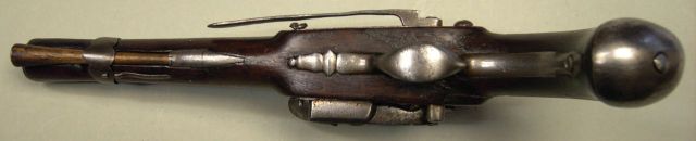

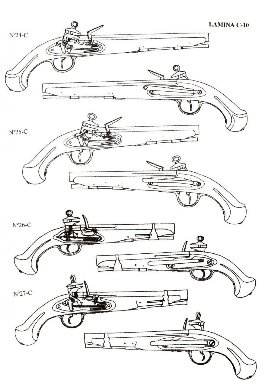

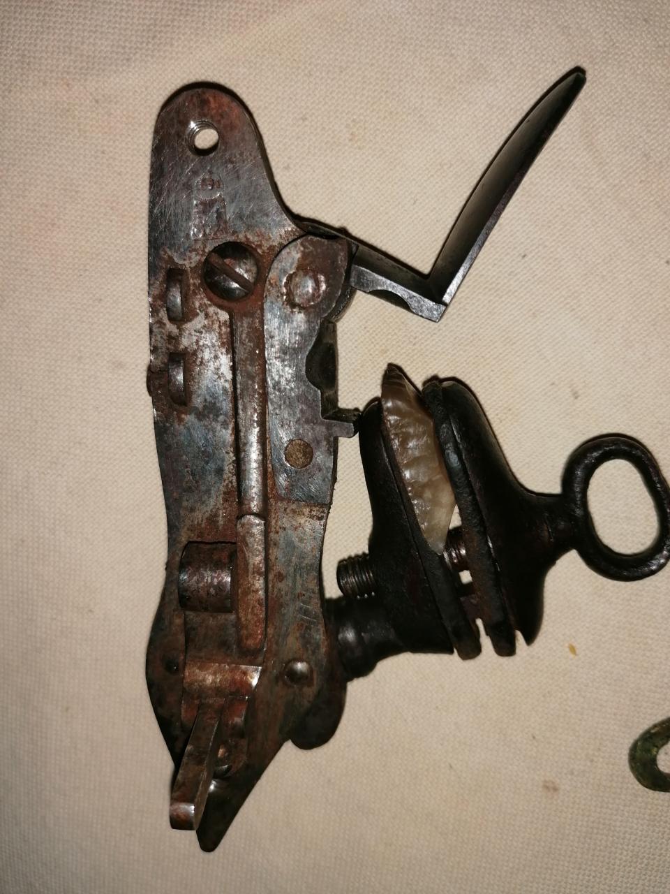

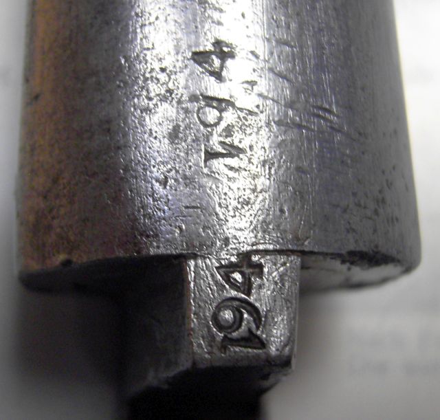

Here come some additional fotos of the marks at the barrel and the lock inside, the end of the narrel regimental marking and the title of Calvo's book as well as the drawing of the Husar pistol 1789. The script at the lock's inside reads TORENTO

In a further book of Juan L. Calvo "Armamentos de Municion en las Fuerzas Armadas Espanolas" you can find other drawings and description of the Husar-pistol 1789 under N°26C

The number 17 at the barrel and at the screw that closes the barrel end is also incised in the wood. I supose it is an assembling code. (194 for Corrado´s pistol).

... As I said, in the 1789 cavalry pistol model there are makings at the bottom of the barrel, hidden by the wood, and in the inner side of the lock.
Gabiola punzon, no doubt. Surprising that it is in that place. There must be a reason for that.
It seems the usual way for these pistols. Maybe in order to protect the mark from powder corrosion instead of covering it with thin gold.

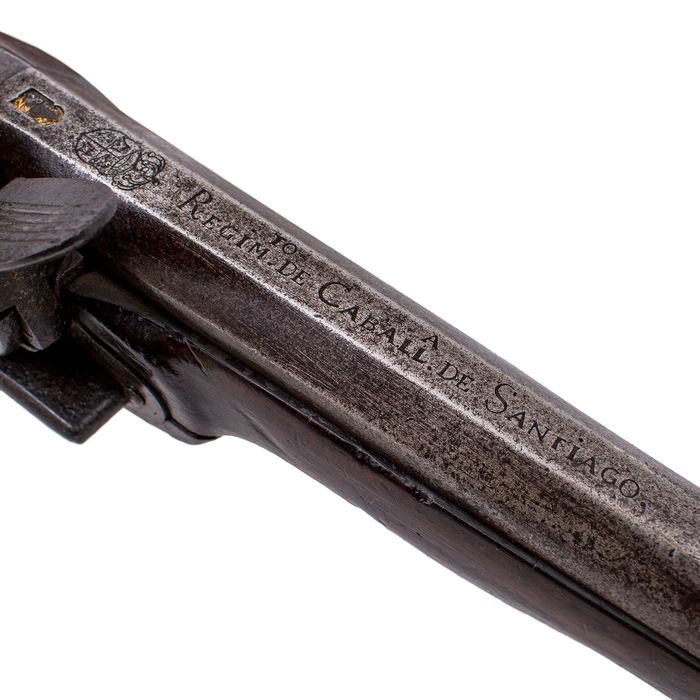

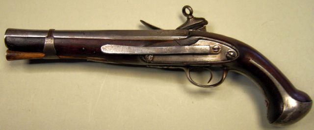

Below my pistol of the Regimiento de Santiago.

Asimismo, las llaves de 24C, 25C y 27C, son llaves de miquelete a las 3 modas, porque la cazoleta tiene incorporada a la brida del rastrillo, y su resorte esta fijado como en el miquelete a la romana. A diferencia de la llave de 26C, que es un mniquelete clasico, con el resorte del rastrillo escondido detras de la brida (postiza)
