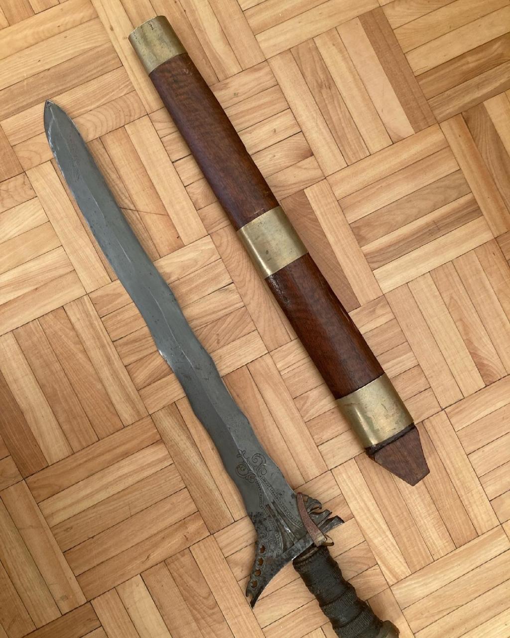

I am new here, and I recently got into collecting a few blades here and there! It's all very exciting.
I recently acquired this blade from my martial arts instructor.
I think it is a moro Kris?
He said he bought it about 40 years ago from a guy, who was a pilot and who bought it off in Mindanao (sometime during WW2?). Not much to go on.
I am quite lost as I would like to restore this blade to its former glory but I do not trust myself with treating it (some told me to just treat the blade with vinegar, and use epoxy steel (or resin) for the handle.)
The wooden scabbard could use a bit of maintenance too, and I can't help but think there are pieces missing in the blade (another asang-asang?)?
I was wondering if there is anyone who could suggest a place who does restoration. I live in Canada, so shipping to the Philippines is quite costly.

Welcome to the forum, Minh!
Yes, Mindanao: Maguindanao and first half of 20th century, I believe.
The piece might well be complete and just need some TLC. With the blade already loose, this might well be feasible for you to do yourself with some help from this forum: Despite a nice blade, it's not a highly valuable piece and IMHO it can cope with some carefully performed learning experiences ... (OTOH, if you want some assistance, Jose is in the US and will certainly be able to lend a helping hand.)

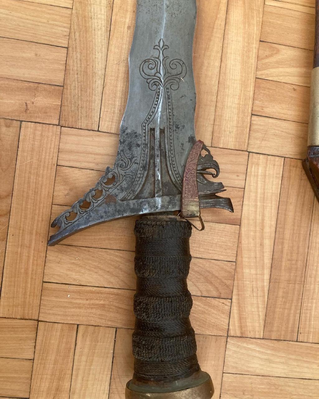

Kai once again is on the money. I would posit 1930s-1940s.
I will also note that the copper clamp (baka baka in Maguindanao) has a nicely chased pattern - best I've ever seen. There is a possibility that the pattern is acid etched - better pictures might better determine it is truly chased or etched.

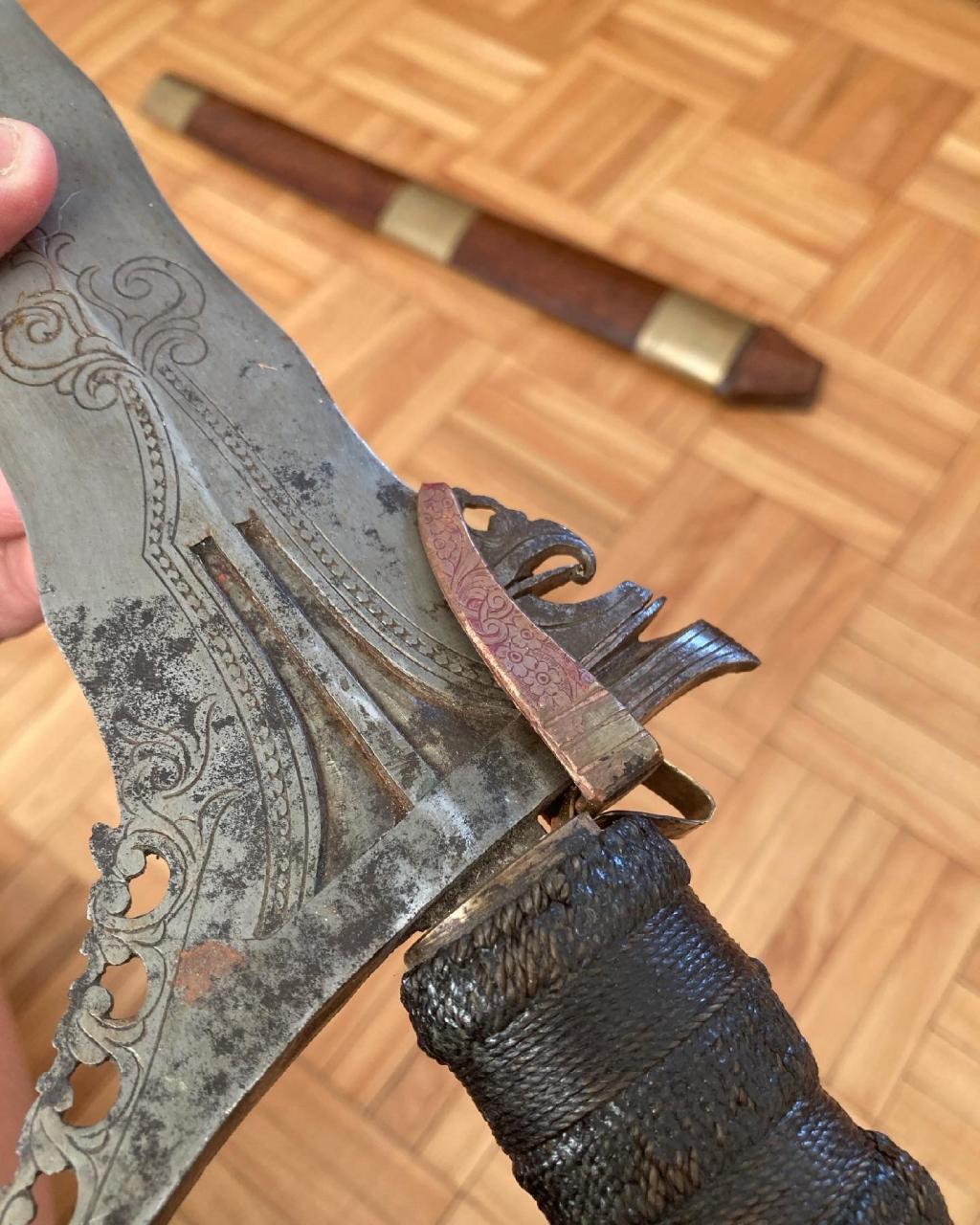

I'm not sure in this zoom in picture of the Baka Baka can help.
The more I look at it, the more I think it's more acid etched?
I mean, if it was chased, wouldn't the lines be deeper, and less precise?

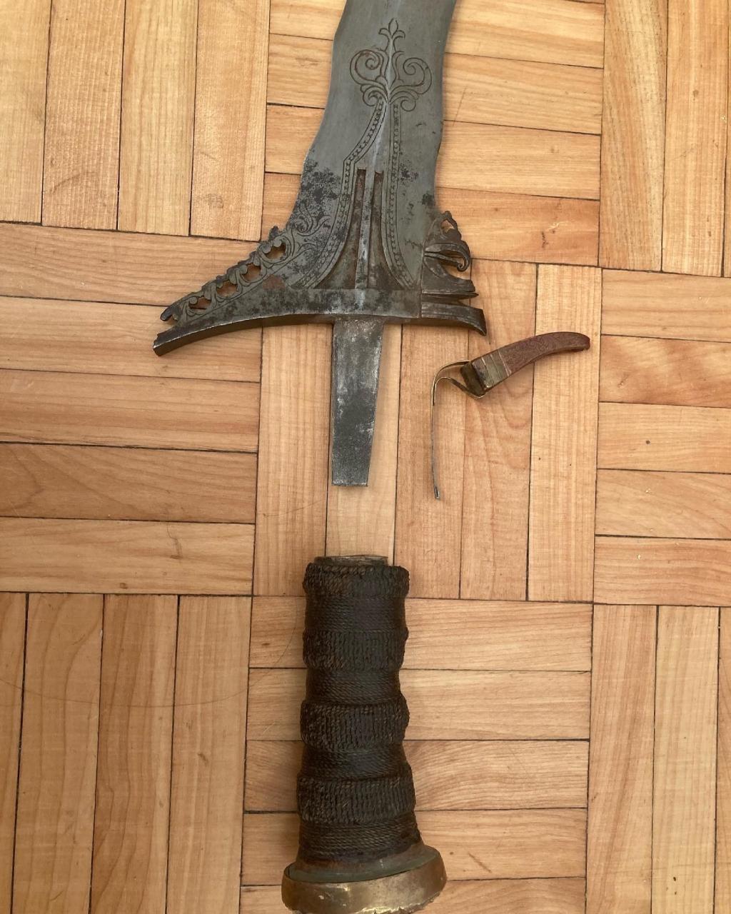

The Baka Baka should be at the end of the handle, yes?
In line with the edge of the blade (same line as my knuckle if I was holding the Kris).
This makes me wonder what is the purpose of the protuded opening on the side of the blade tang in the wooden handle (where you insert the blade).
Would you know?
Did the bladesmith use that opening for a filling?
Epoxy resin for example?
I don't think this pattern is chased. Chasing involves hammering from the reverse side of the metal to push out the pattern on the facing side of the metal. This does not look anything like that to me and the copper is probably too thick for that technique in any case. It could be acid etched i suppose, or simply engraved.
It is a beautiful baca-baca regardless.

Actually repousse is from the back then front.
But with the close ups I do agree David that this baka-baka is acid etched. As Chopstick_minh said the designs are not deep enough.
On the blade itself, the work is most likely chased with tempered steel tools (though sometimes engraving is done....)
