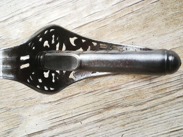

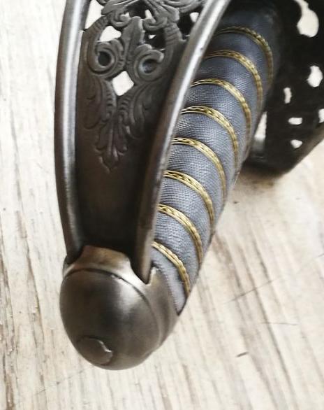

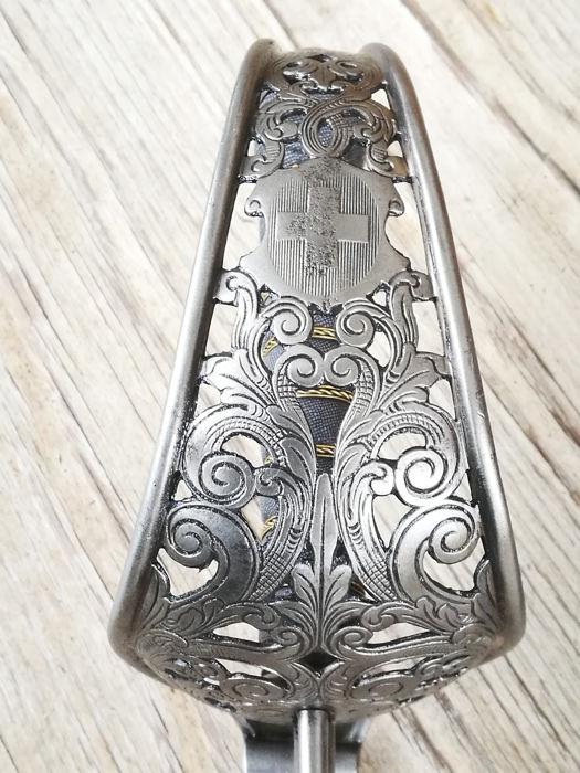

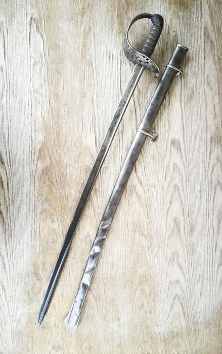

Picked up this Swiss sword, always admired the Swiss, and I have a German aunt & Swiss uncle there. Säbel für unberittene Offiziere. (sabre for unmounted officers).

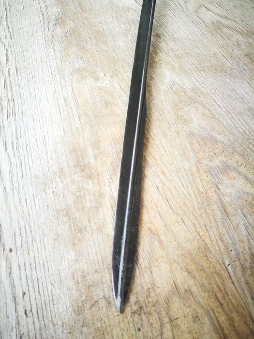

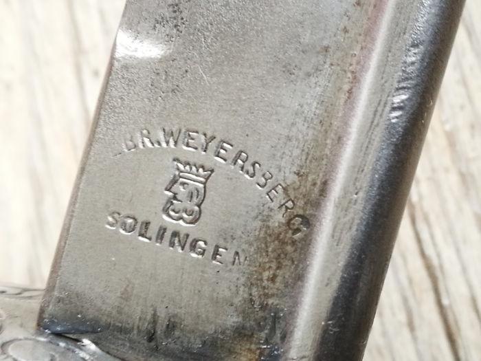

Any Idea how old? Solingen blade, Pipe back, quill point. Few dings on the scabbard.
Pipe backs are not too good for cutting, but look cool, always liked the raised 'yelman' look on the back of the quill point ones, this is my first. Have an Italian Mounted artillery officer's sword with a pipe back spine but no 'yelman'.
Anyone know how to remove the dents?
Thanks for any info you can provide.

I've heard of a variety of strange techniques for removing the dents (filling the scabbard with sand, for instance) but I've never had a go myself. The 'normal' way was to use a metal mandrel shaped specifically for the scabbard type which slides inside allowing the use of a hammer on the outside to work on the dent.

I have 3 mandrels, previous Wilkinson's I picked up without knowing what they fit. I found that if not the exact one that they will not work very well.
You will need a specific mandrel. The cost of reproducing one would be prohibitive, best to enjoy the sword as is unless you have deep pockets.
I have attempted using pieces of steel but inevitably the dents that remain are a tell tale that someone stuck something down them.

Very nice sword; I am also a fan of Quill Back swords and bayonets.
In regards to the dents on the scabbards, I have been told by more than a few collectors that this was done on purpose to keep the sword from rattling or even from falling out on a loose fit. I have also been told that one can remove the dents by filling the scabbard with water and freezing it, however, I have never tried this myself.

Someone has recommended using brown unpolished organic rice, poured down the scabbard, then soaked in water. the rice swells and pushes out dents in hard to reach objects like this. You wash out the rice with a hose or pressure washer when it is where you want it (and before it pops the seams* ).
The rice husks keep the rice from sticking together and becoming a sticky compressed block of rice epoxy. (the great wall was made with over-boiled rice paste as mortar & it's is still there, rice glue is quite common I hear in the orient, so using sticky rice is not a good idea). I am a bit reluctant to use these methods.
The deliberate anti-rattle device sounds good to me.

The main reason for this dents is that the sabre when worn very often got into contact with shutting doors! Filling with water and freeze it might be the best solution to even the dents because it is easily to be removed

Might try that next winter when I'll have a large freezer to put it in. (called Outside )
