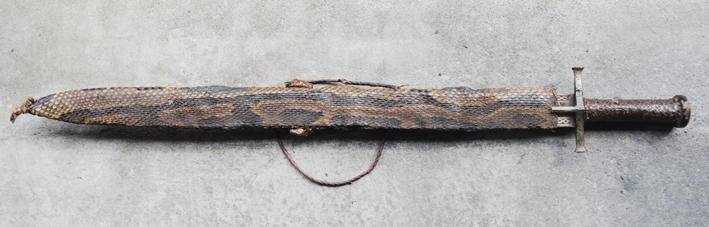

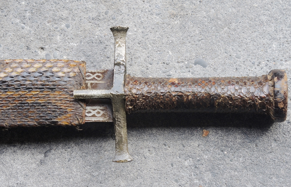

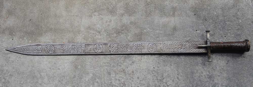

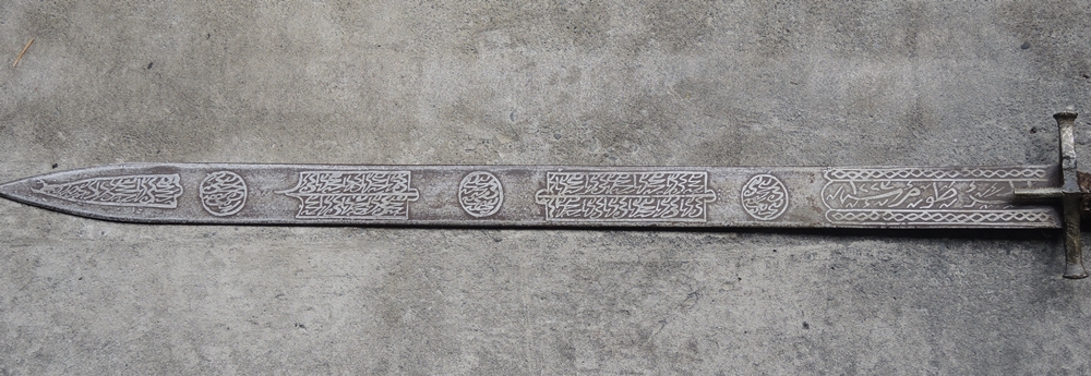

This Kaskara was a WW1 bring back from Sudan. The scabbard is either Lizard or Snake skin and in quite good order for age. The blade is double edged and as can be seen is decorated with plenty of script. If anyone can give a translation I would appreciate it.
All comments welcome

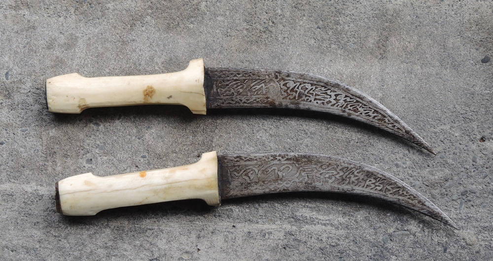

Also with the sword came 2 knives with bone handles.

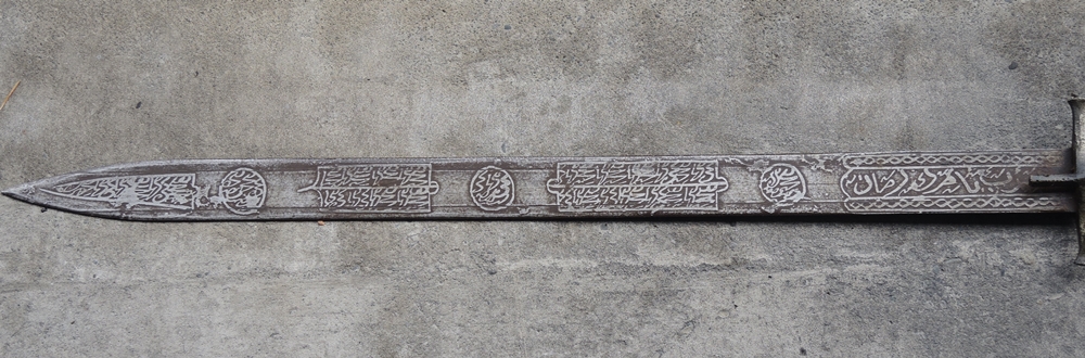

Nice old sword. The thuluth etching is common on a "type" related to the Mahdiya movement that was mainly destroyed after the 1898 Battle of Omdurman and the subsequent tracking down & death of the Khalifa. Also, the copper alloy cast crossguard is almost exclusively associated with the thuluth blade. The blade may have been made from sheet steel. The inscriptions usually are religious platitudes; some were even not words , but nonsense. The snake (?) skin covered scabbard likely had a talismanic role. The sword has symbolic value rather than for battle and likely carried by unit commanders.
There has been some debate on the Forum as to when & where and for whom these swords were made. Jim is much more knowledgeable on this than I am.
I tend to think these swords had a kind of "Lost Cause" quality to them, but I have no evidence of this. Not even sure why I mentioned it.
Ed

I do have a profound fascination with the Sudan, and in fact I was involved in some research several years ago concerning thuluth and the Mahdist weaponry. While I cannot claim any particular expertise, I did learn quite a lot toward better understanding of these weapons.
While the swords (termed sa'if, but now colloquially known as kaskara) were not widely used tribally in Sudan prior to the Mahdiyya (1883-1898) but in degree were known to some tribes in the south. Clearly they became required as Mahdist forces assembled. However, during the time of the Mahdi until his death in 1885, there was not a notable use of thuluth in the manner seen in these profusely covered blades.
The Caliph, in succeeding the Mahdi, was faced with a dilemma. He needed to advance the Jihad, but the Mahdi who was a divine figure in the movement, had died mortally, which of course led to concerns.
He needed to find symbolic and fervor instilling means to inspire the Ansar onward, and legitimize his position as the leader acting on behalf of the Mahdi. The Ansar believed in the magic of the Mahdi, and the metaphor and similes of the 'Sword of the Mahdi' became key aspects of the ongoing Jihad.
The use of acid etched thuluth was a known process used by the Mamluks who had been situated in Sennar, and Shendy and they had been long standing purveyors of arms and armor as well as active in slave trading.
After the fall of Khartoum, the huge industrial complex, shops, tools and metal supply were captured, mostly move to the arsenal at Omdurman. Here the process of outfitting ordnance, weapons etc. was undertaken in huge volume. Here the familiar acid etched blades were produced, and not only on kaskara blades, but on many other weapon forms as they came in with the many conscripted forces from tribes in other regions brought their arms.
The thuluth inscriptions were intended to render each of these weapons effectively 'a sword of the Mahdi' and each warrior advancing in HIS charge. The phrases, invocations and platitudes are simply repeated, in more of a decorative manner, but still actual wording in degree. It was once thought they were more of an 'arabesque' and jibberish, and that to illiterate natives it didnt matter, but that was not the case.
To these Ansar warriors, their weapons were emblazoned with the words and spirit of the Mahdi, and they fully believed he was with them in battle.
This example is shorter as they were worn in scabbard over the shoulder and under the arm, sort of a shoulder holster. The lizard hide, much as with crocodile, is very totemic to these people traditionally. As Ed has noted, the brass guards were quite typical in these ersatz weapons produced for the Caliph's forces imbued with the spirit and magic of the Mahdi.
Most of the thuluth covered blades were consistent in totally covering the blade, and the breaks with these roundels is more consistent with the Mamluk style motif, on the sa'if from which the kaskara evolved. It was these Islamic broadswords, not Crusader examples as romantically held by early writers, that were the source for the kaskara.
These thuluth covered weapons were also used on the battlefield by the Holy Men who attended to those fallen with required blessings etc.

This type of Sudanese weapon tends to fall into the possibly "made for sale" category or genre, the dagger very likely and the sword possibly. The souvenir trade in the Sudan was in fact under way even before the Battle of Omdurman. This subject has been well discussed in the past on the forum and for more information, please refer to the previous posts (with accompanying evidence), by Iain Norman by myself. (For some reason I can't do the link function on my PC, but a search under the terms Sudanese and Mahdist should do the trick).

I rather agree with Colin. I have a couple of these and whether they are based on talismanic swords is debatable, but I doubt that any self-respecting Sudanese warrior or leader would wave one of these around and have the blade fly out of the hilt (which would certainly be the result). So I'm not convinced that these are even for local use as ranks or emblems - rather I think they were produced for sale.
Yes, for sure there are examples of worthy weapons with thuluth, but they are few and far between. These others appear to be more or less mass produced and follow the same pattern based on etched flat sheet steel, no fixing of the blade to the hilt (its just pushed in and padded), and usually brass non-functional or very thin iron guards. All topped off with a crocodile hilt, often with legs. The small bone handled daggers, and triple dagger sets being equally non-functional and from the same steel, also sporting crocodile clothes.
As objects of study, and interest they are actually quite nice but not to be confused with functional kaskara.
