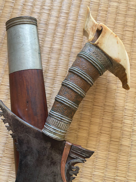

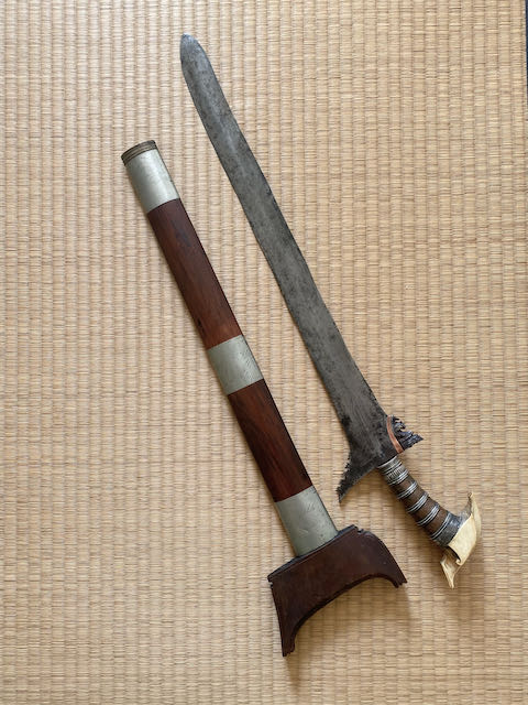

Hello everyone,
Sharing my Datu class Kris. Would like to hear your thoughts and would like to know where it originates.
Thanks!

Your kris is indeed datu class, is Maguindanao in origin, and from the 1920s - 1940s. The mounts might be silver wash (possibly white metal) and the brown hilt bands are copper (possibly brass).

Maguindanao, first half of the 20th C. The metal areas on the hilt and scabbard would benefit from polishing to bring out the sword in all its finery. Nice kris.

The fittings on the sheath don't look silver to me. Can you determine what metal this is? Is it aluminum or some other kind of "white" metal?
I would like to find out if the silver bands on the hilt are actually silver or just washed or plated or maybe some other kind of silver metal. Cleaning them up might help in identifying them.
Are you sure the pommel is ivory and not bone? What happened to the underneath area that looks all chewed up? Some better, closer photos with more a angles of view would be helpful.
I think Ian and José may have more experience with Moro weapons than i, but my general feeling is that the dress at least is post WWII, not as old as they suggest. I also hesitate to place this as Datu class (implying that it was actually owned by a datu). I see a lot of keris in the marketplace that i would consider datu STYLE, but that seem to have been dressed to appear that way for the marketplace. I am not convinced that a keris that would substitute various white metals for silver is actually a keris that a legitimate datu would carry, though i could be wrong.

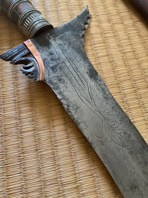

David raises some interesting points. I think the blade is pre-WWII. The scabbard could be a later replacement, and the metal strips might be from low grade silver or other white metal as David suggests. However, the filigree work suggests silver to me. Similarly some of the metal work on the hilt may be more recent.
From what I can see of the pommel, I favor ivory rather than bone. The discolored areas are consistent with oil staining. Additional close up pictures would help settle the ivory or bone question. Check under the beak and the crest also for signs of bone.

With the patina missing, I would suggest the "silver" are in fact nickel/copper alloy "German Silver".
Based on the patina and lack of vessicals on the pommel, I too think this is ivory.
