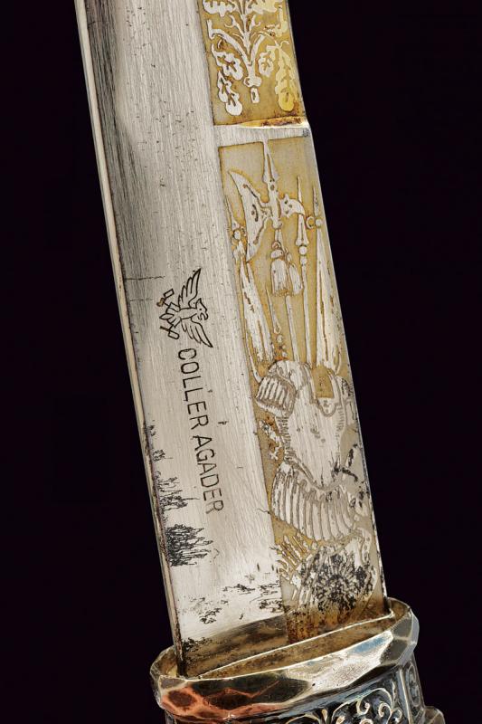

I could not resist the itch and purchased this early 20c koummyia with what at first sight appears to be a repurposed French sword blade.
However, the blade is definitely not repurposed, being specially made for this dagger and bears the marking "Coller Agader."
Agadir/Agader is a city in Morocco.
Any additional information on this dagger or its maker is welcomed!

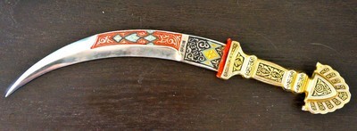

Nice piece, the mountings are made of silver?

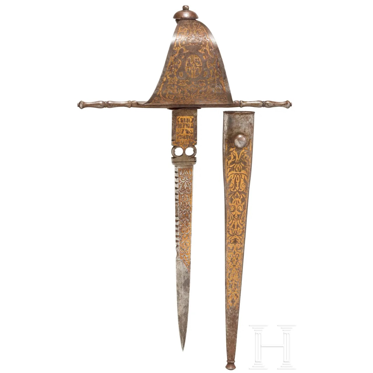

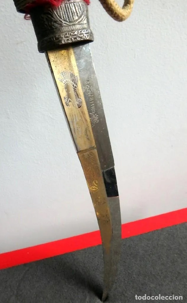

The blade seems to be specifically made for Koummyas, I found two other pieces with the same blade in the internet. For me it looks like an old Spanish Toledo-blade:
https://de.todocoleccion.net/militar...921~x199040756

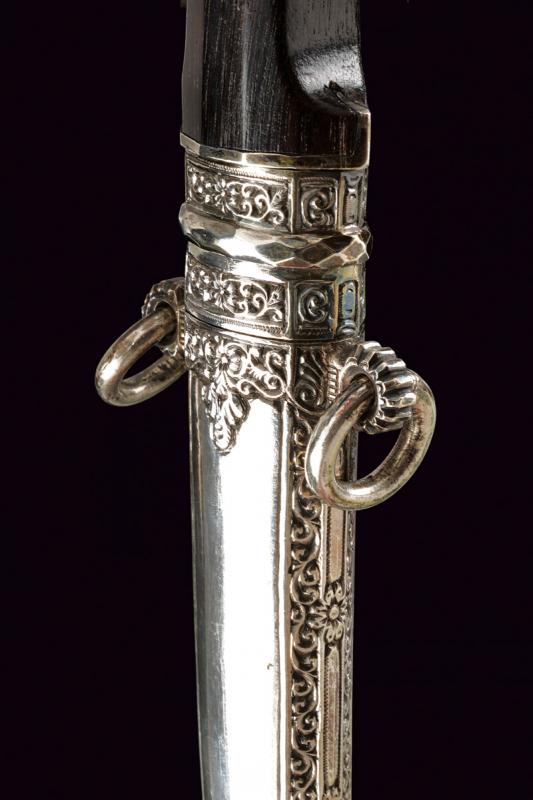

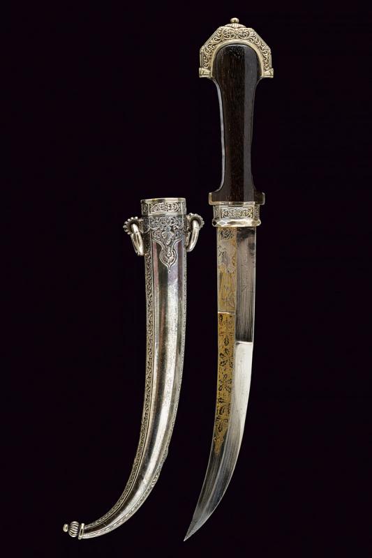

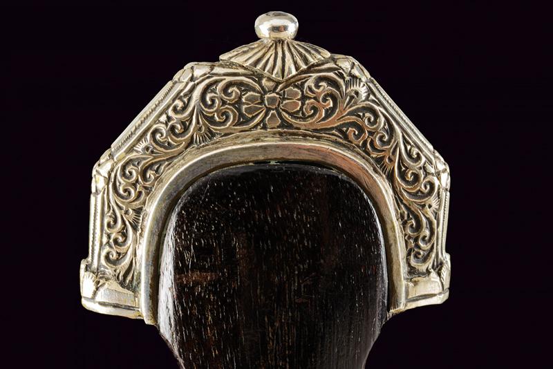

For the maker, the Moroccans write, like the French, "Agadir", the English spelling is "Agader"...So you should look at English blades or English influences like Wilkinson.

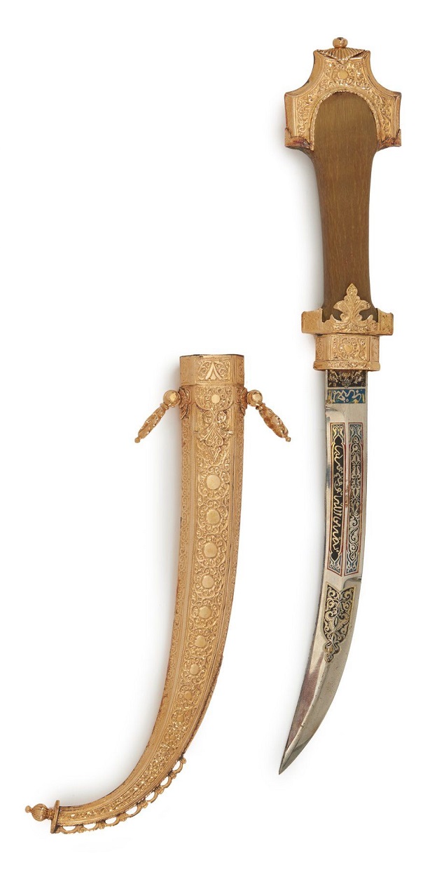

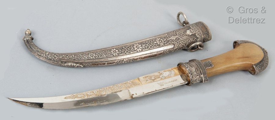

See these 2 koummya, one like yours and one with a Spanish blade.

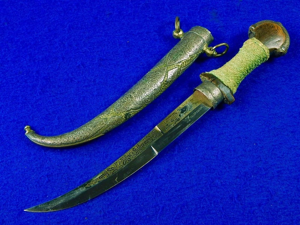

- No, the blade is definitely not Spanish/Toledo. Different manufacturing style and different style decorations. The decorations on the blade are very French in style and technology, but from all I could gather so far, the blade was indeed made in Morocco/Agadir by a local, albeit French bladesmith named Coller.

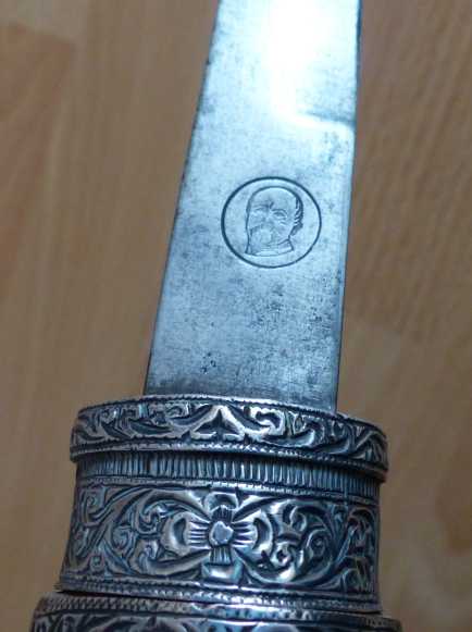

- In this case, I consider this koummya particularly valuable (for me) because it was locally made and it reflects both local traditions and the colonial past (even earlier 20c koummyas had French made blades - see photos of what I believe to be a first quarter of 20c koummya with French/Poincare face marked blade having the silverwork stamped with the Moroccan ram head).

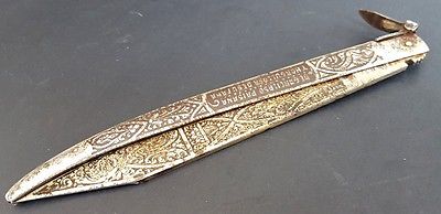

When I looked at this blade I thought about old Toledo-blades like the attached ones. I don't know if similar things were produced in France or England.
But I think Spain would be plausible because Morocco was occupied by France and Spain during a longer time.
