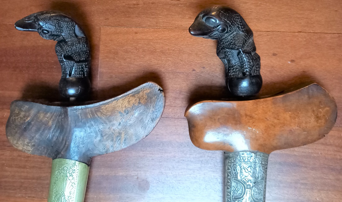

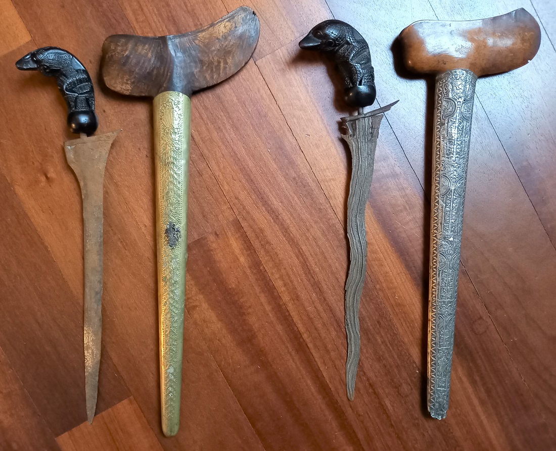

I recently acquired these two Keris which intrigue me a lot because their grip is very close to that of the Keris hilt from South Sumatra.
However, the base of these handles is typically Javanese.
The two Keris come from two different collections.
In both cases there is unfortunately no Mendak.
What type of Mendak would be the most suitable?

IMO these 2 hilts are indeed in burung style from South Sumatra, while the scabbards are rather from NW Java (just in front from each other). And the blades....

Yes there is nothing exceptional about the blades ... one was probably beautiful in her youth, but is now just a ghost. The other is really very basic and still covered in rust.

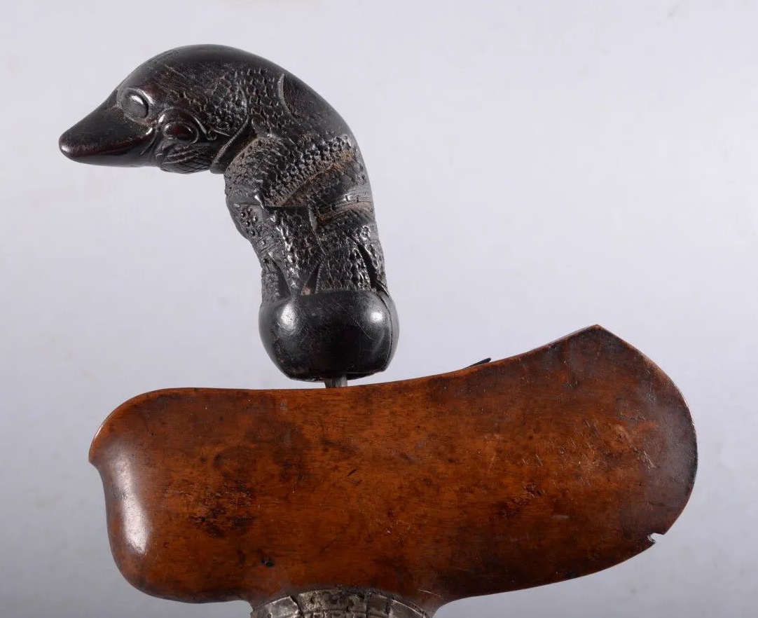

The Burung handles that I am used to seeing from South Sumatra usually have a sort of "ruff collar" at their base, just above the Selut (see the picture of hilt from Detlef collection).

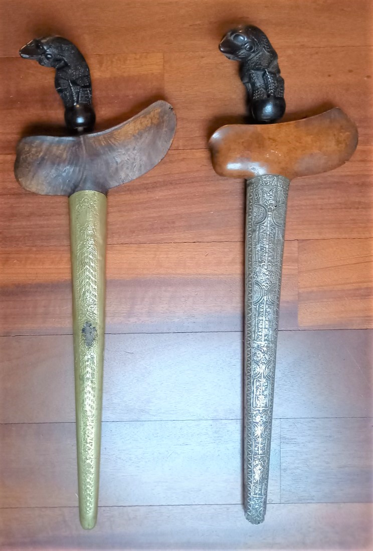

Posts: 432
I note that the handle reported as coming from Lampung in Tammens Vol. 3 is typical of Cirebon.
Even though the hilt style of this subject is from Lampung, I don't have a Selut to go with it, and the scabbards are from Java so I put on mendaks that I had in stock (an old one (left) and a new one in an old style (right)).
