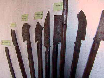

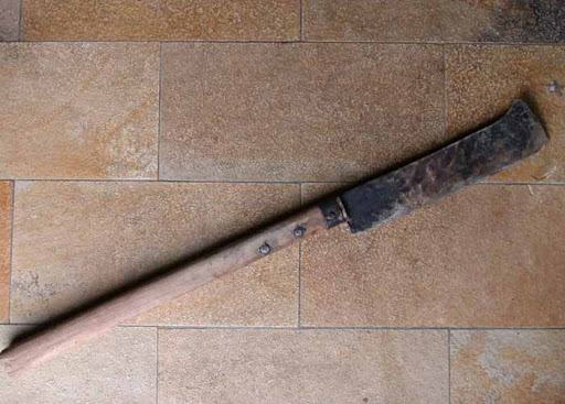

i have attached some images i could find of some of the hafted chopping tools and the billhook the billhooks are very similar to some types form indonesia

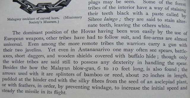

As far as I can make out, the peoples of Madagascar did not really use "swords" in the historic period. Their main weapon before the introduction of firearms was the spear.

see "antsibe" image attached.. in the image to the left the heavy bladed knife (not the european made machete) .. i mean this is a defined style.. almost like some southern indian chopping knives. and its not inspired by some european tools.. it appears to be native.

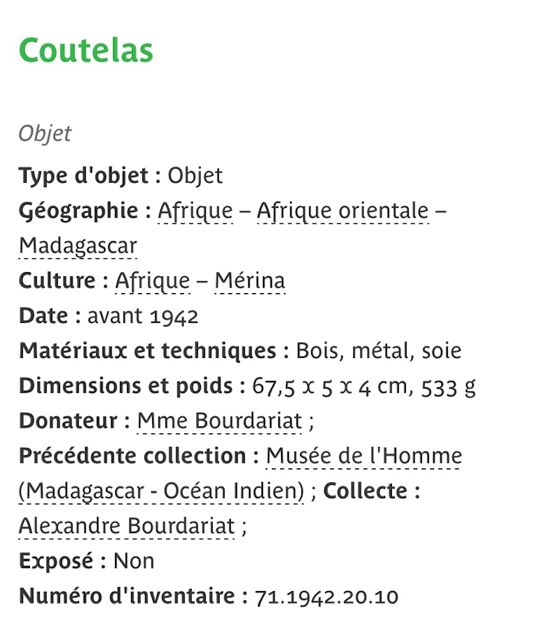

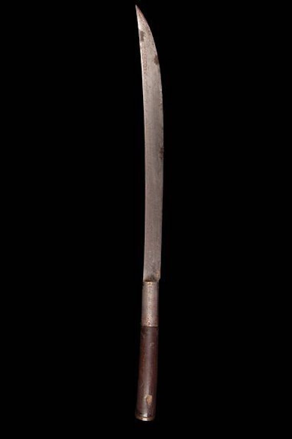

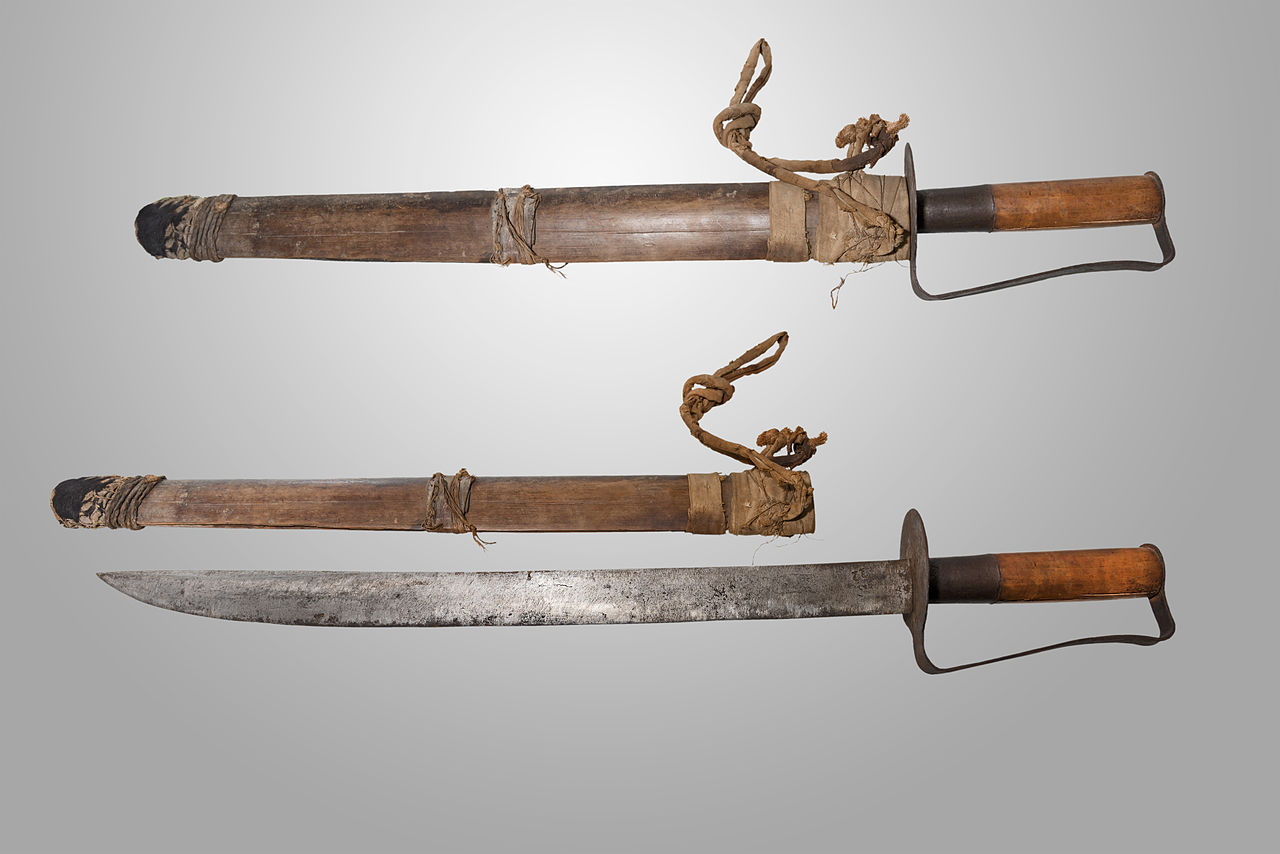

here i found soem more images.. this is the dahb like swords ive seen.. also french wikibeadia has images of two "19th century madagascan sabres" under the french section on machetes that are with knuckle blows but have similar blades..
this clearly shows some sort of swords
an interesthing very thick bladed knife

this dahb type sword in the links Duccio post earlier

Posts: 4,738
The second sword shown by ausjulius in the above post is indeed a Lao daab, most likely pre-WWII. The curator's notes indicate a date avant 1942, consistent with the style and condition of the sword. Because both Madagascar and Laos were under French rule at the time, it would not be surprising to find a Lao daab making its way to Madagascar, although an error in attribution by the donor or the museum is also possible. The daab is made in a traditional Lao/Northern Thai manner, and is very unlikely to have been produced by a native of Madagascar.
no i doubt it was introduced from some place in asia, infact the two "cutlass" type swords tagged as madagascan from the french wiki article have the same blade and handle construction and same furrel but have a D guard attached. .. id say its an indiginious weapon... the locals have had iron and steel since they arrived from indonesia and ignoring the malayian and later bantu peoples who both worked iron.. additinally there is sizeable ethnic groups whos founders were somalian, as well as arab/indian/sumatran. the arabs having introduced writing., additionally europeans were present on the islands for a long time prior to when the french finally invaded in the 1890s.. the only reason it was not colonised previously was because of the very fact that there was a resonable population that possessed large amounts of european guns at an earily date.. and had some form of organised government that allowed the mobilisation of a some sort of army that was sufficient to see off plucky arab traders and later european entrepreneurs which makes me think were swords traded and if so why not copied? .

Incorrect.
Extract from "The History of Mankind" by F Ratzel, 1896 and another extract from "The British Museum Handbook to the Ethnographical Collections", 1910 :-

Posts: 10,862
Incorrect.
Excellent references Colin! well support your observation regarding 'swords' and Madagascar.
While Madagascar is one of the larger islands in the world, it was remote and only tribally populated until about the 18th century. Tribal cultures typically have the spear as a primary weapon, which serves both for hunting and warfare. Most tribal cultures, especially in isolated context, have not had inclinations toward the sword, unless incidentally by exposure to outside cultures. Even then, the sword is seen more as a curiosity and an item of prestige more than an actively used weapon form.
As a maritime replenishing station, it was visited by vessels frequently, especially as well known in the golden age of piracy 17th into 18th c.
With this of course, these kinds of instances would have provided certain types of weapons and tools of European styles in limited degree, but there would not been any sort of native production of these. Naturally, limited forging of smaller metal tools or weapons is always possible in these native cultures.
It seems the early inhabitants populating the island were of Indonesian origin, coming from the Malay peninsula by outrigger, but this must have been an arduous journey as open sea voyage of that distance would have been impossible in those times. With this, it does not seem that any sort of regular contact would have been likely in earlier times, so any steady or ongoing Indonesian influence would not seem the case. However trade from western India to East Africa was well known and with Arab trade networks so that source for influences may well have had presence.
