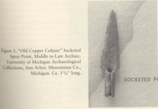

Posts: 6,024

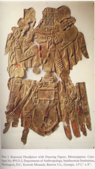

Copper weapons were at one time in use in pre Colombian North America. In forms unlike Central and South Americas. Okay it is not iron or steel, but I think it is odd that this metallurgy and often exquisite metalwork is so over looked. I have mentioned this book before "Miskwabik, Metal of Ritual, Metallurgy in Precontact Eastern North America" Amelia M. Trevelyan, The University press Of Kentucky. A little academic but not too challenging for the general reader, though I shall not try and quote from it. There is mention of tools and weapons, axes and adzes being large and heavy. I will also avoid the debate as to where this metallurgy originates from. Personally I see no reason why it is not home grown. As metal work was well established I also cannot see why this practice would not easily adopt the new material iron. Here are some of the interesting pics from the book

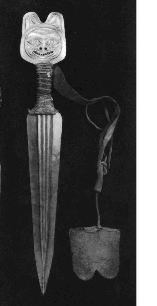

Posts: 7,302

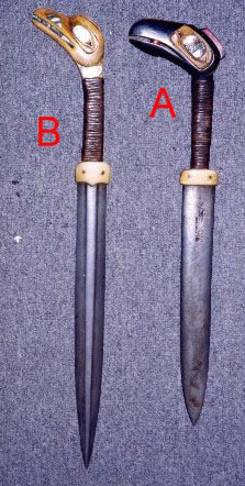

Here is another Tlingit dagger, this one made of copper. I am afraid i know less about the origins or dating of this one. It seems to many that you can find many Tlingit blades that are trade blades, but i believe the two examples i have posted were actually forged by the Tlingit.

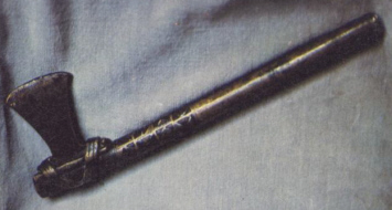

Posts: 6,024
This interesting axe is in the Museum Of America, Madrid well worth a visit. Bronze from Peru, with what looks like silver, tin or lead inlay. Bronze implies considerable metallurgy rather than working in copper as bronze is an alloy. So smelting was not an unknown activity. I like the way it mimics a stone axe, I would imagine this was an exceedingly special object, as it is today.

Posts: 6,024

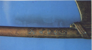

This is also from the Americas museum in Madrid. I think this is most interesting as it has the same method of attachment to a halft as the axe I post earlier from Wisconsin except this one is bronze. It is 11cm long and reminds me of axes from South Africa. If one is to work on that well trodden path of like forms means it came from somewhere else. Then Zulu sailors went the long way round, or round the cape of good hope and then cape horn and settled in the Andes . I prefer to think that some objects are universal and the design comes to a mature form that does not alter where ever one comes from.

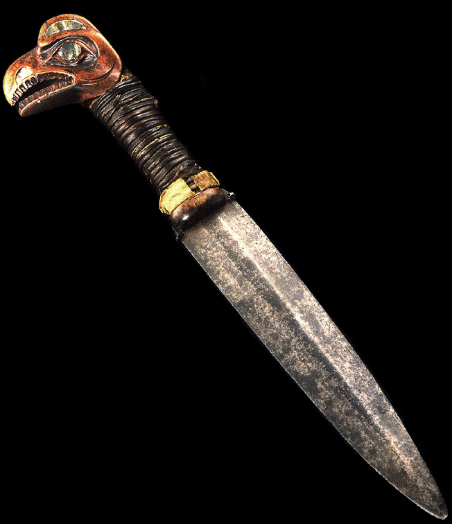

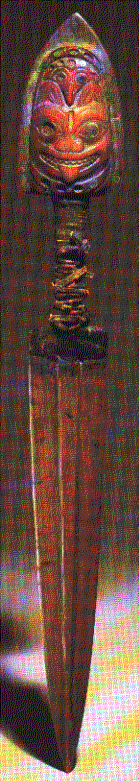

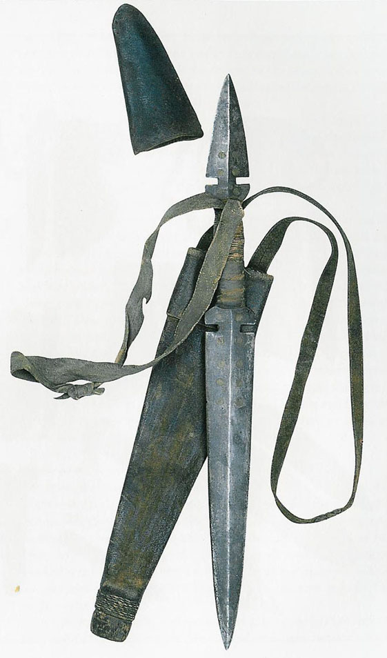

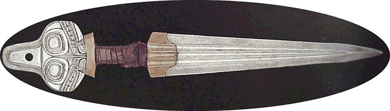

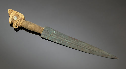

Apparently the earliest travellers to the northern west coast found both copper and iron in use. Copper most likely was mined and Iron and steel was probably salvaged from ship wrecks and drifting debris. (Coe, Swords and Hilt Weapons Pg.218). I have accumulated a number of photo's over the years, unfortunately I can't remember all their origins. 1) copper blade, 2) Iron blade 3) Russian bayonet, 4) Sheffield trade blade, 5) double blade.
Jeff
Old 12th September 2006, 08:52 AM   #15
Flavio
Flavio's Avatar
Location: Italia
Posts: 1,243
The last one, double blade, is simply beautiful!!!!

realy very attractive knives,
the blade shapes and handle decoration had a very natural look , i find these far mor eattractive than many other ethnic weaponry,, they have somehow a natural , but brutal look
very nice daggers,
its interesting that they developed their own style different form the blades they obtained,
would you thhink they had been making them for along time , otherwise theyed be much mor einfluenced by the trade blades,
it is also interesting that these seem made fistly for fighting not for hunting or general use,
