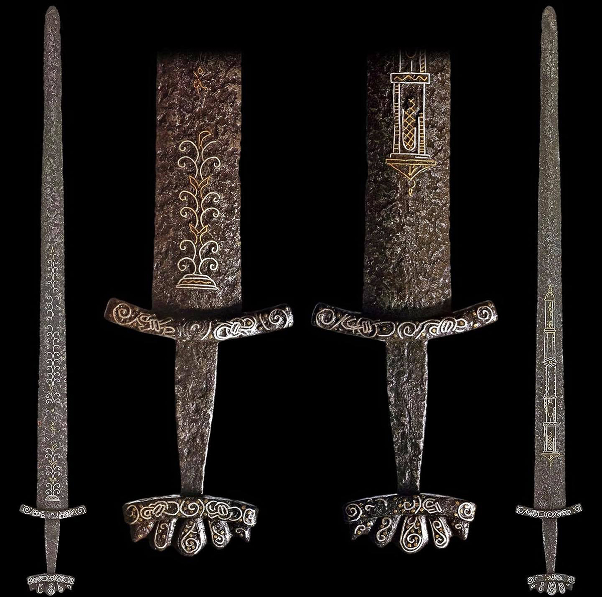

Hey folks. Just saw this extraordinary sword. The only info on it was as follows:
Viking sword, Hedeby, Denmark, 10th century.
I am familiar with the archeological site, which is know officially in modern Germany. But i am amazed at the condition of the sword, especially the silver inlay. While i am very interested in Viking culture, as many are i suppose, i don't know much about there swords. Any further info on this particular sword would be appreciated.

I have found this information on line about this sword which seems to have come from Peter Finer, who apparently sold this sword at sometime within the last decade.
There do seem to be numerous aspects of this sword that speak to a none Viking source such as the unusual inlay motifs and sword shape. But again, this is beyond my scope of knowledge.
With double-edged blade of gradual taper; inlaid on both sides in gold and silver with decorative patterns, one side bearing a gradually tapering geometric-architectural design in five stages and the other bearing a gradually tapering palmette design. The hilt comprising down-curved cross guard, sturdy tang and five-lobed pommel riveted to the upward-curving upper guard; the cross-guard, upper guard and pommel all inlaid in silver with decorative knotwork and tracery and in gold with dots.
Overall length: 94 cm (37"); Blade length: 80.6 cm (31.75")
This rare Viking sword, the hilt of Petersen Type O, has a cross-guard with decorative devices reminiscent of those on one of the three swords that were found in the rich ship burial of about 900 at Hedeby in Denmark when it was subsequently excavated in the 1950s. More of these ‘rabbit ear’ or ‘knotted rope’ characters may be found on three of the ‘Hiltipreht’ group of swords, namely one in the Wallace Collection, London (Inv. No. A456), the Ballinderry sword in the National Museum of Ireland, Dublin (Inv. No.1928.382) and the example from Malhus in the Trondheim Museum, Norway (Petersen, Abb.89).
The credentials of this prestigious weapon are further enhanced by the decoration upon the blade. On one side there is a palmette design of inlaid silver with traces of gold that is very similar to that on a fragmented blade from the River Bann in Ireland and illustrated in Bøe. This should be compared with the inlay on a sword from the Waal near Nijmegen (Oakeshott, Records of the Medieval Sword, p.47). On the other side, the inlaid precious metals may well represent a schematic plan view of a building, as is believed to have been intended upon another silver inlaid sword illustrated and described by Ewart Oakeshott (Records of the Medieval Sword, pp.28-29).

This sword makes the rounds of the forums and image boards regularly - I very much doubt its authenticity, and I am not the first to say so.
I think the ornamentation gives the game away, and the analysis offered by the auction house is completely off base. Firstly, the ornamentation on the "Hiltepreht" swords mentioned (and several other similar ones) is a Frankish-style floral/vegetal design that does not resemble this sword in any way. All of these are of Petersen's type K and probably of the 9th century. The sword from Hedeby is of the same type; its ornament is different but executed with the same technique: the design is engraved in dark niello (I assume) on a plated silver/bronze/etc surface. This is completely different from the sword in question.
The comparison to the sword from the River Bann is also dubious; its ornament consists of three comparatively simple palmettes, also it has a brazil-nut pommel and is probably of the 11th century. The broken blade from Nijmegen (illustrated by Oakeshott) cannot be precisely dated, but its design shows far greater affinity with the Bann palmettes and certain other inscriptions than the ornamentation of this sword.

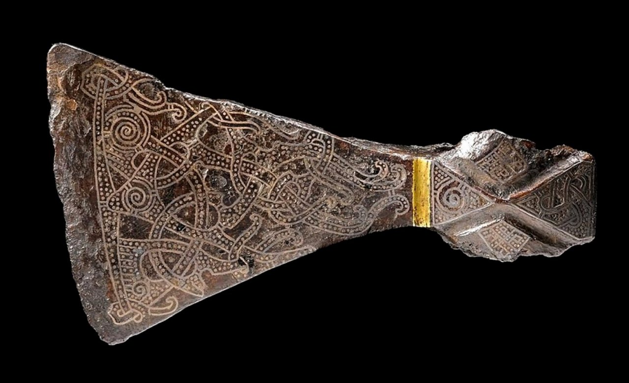

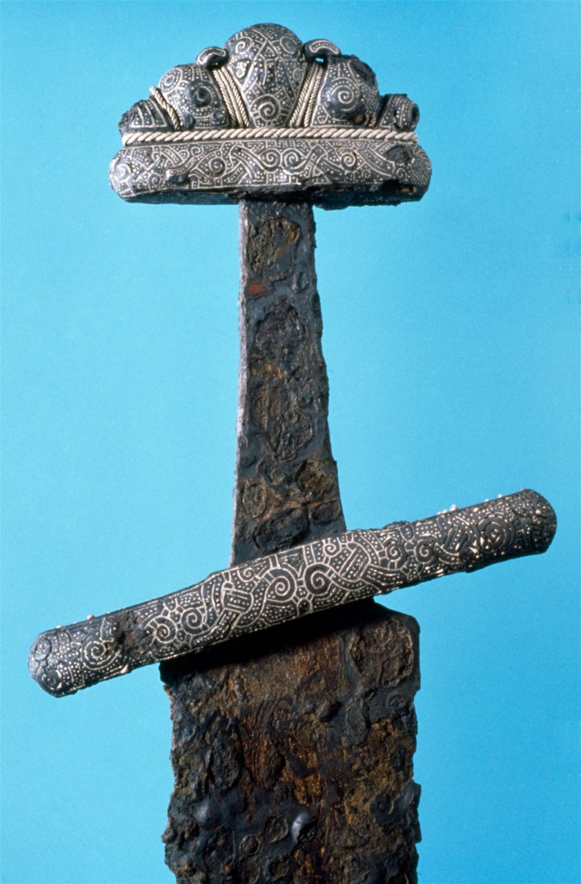

The hilt ornamentation we see here is instead a poor imitation of designs that do appear particularly on hilts of Petersen's types O and R, and can be associated with the 10th century Mammen style of Scandinavian artwork. The intricacy and quality of the designs on every genuine weapon decorated in this manner far surpass what can be seen on this sword and others that have appeared at auction in recent years. For comparison, I attach an example excavated in Norway, and the namesake axe from Mammen in Denmark.
