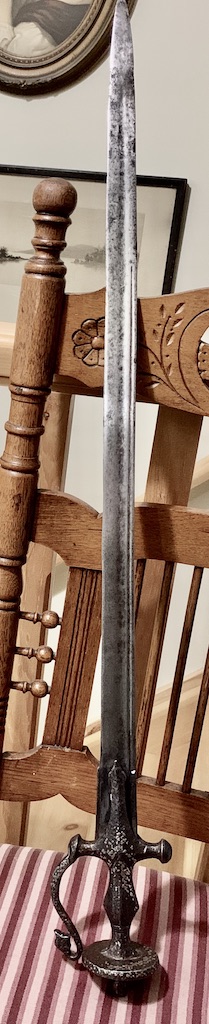

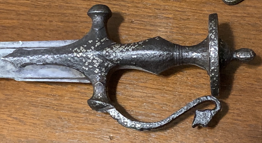

Not the type of sword I collect but I liked it and the price was right.
Blade is 31 inches, thin and flexible, could it be a European blade? No markings anywhere. Very flexible and thin past the fullers. At the ricasso it is 7/16 inches thick and 1 1/2 inches wide.
Any info is appreciated.

This is a classic firangi.

Looks like pretty much the well known tulwar hilt form of Rajasthan from about mid 19th c. +, it seems well used by Rajputs and Sikhs. The 'stepped' ricasso' seems to be more an Indian favored feature and thought to be to accommodate the much debated finger around the quillon practice.
This was the reason this feature on blades was termed 'the Indian Ricasso'.
It has often been argued that the forefinger around the quillon outside the guard endangered it, however it has been generally noted that sword to sword combat in India was rare, and parrying was 'the work of the shield'.

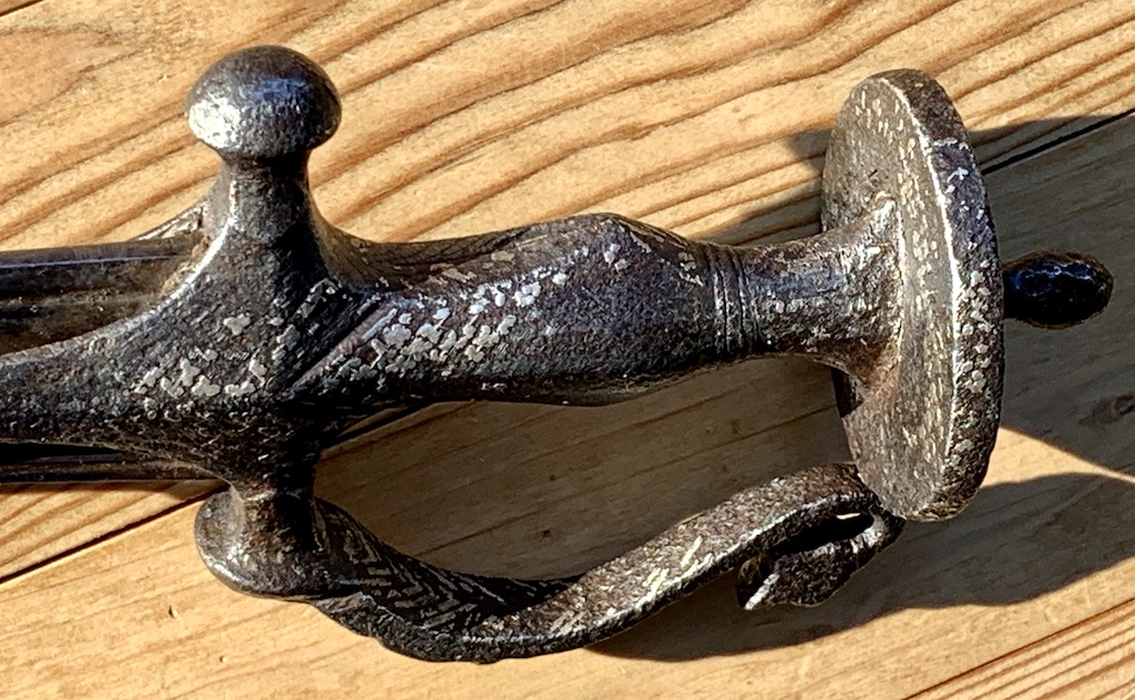

The hilt looks like it has silver metal application which it may be what is known 'bidri' technique, silver over black .
Old 18th December 2020, 07:48 PM   #4

From the pictures, the blade appears to be European and the "Indian Ricasso" is the result of repeated sharpening & repairing of the edge. Moreover, the wear of the blade matches quite well the corrosion of the hilt, so my guess is they have been together some very long time (18th century?!). However, I might be wrong.

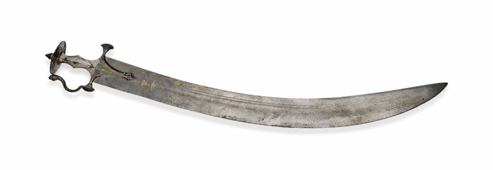

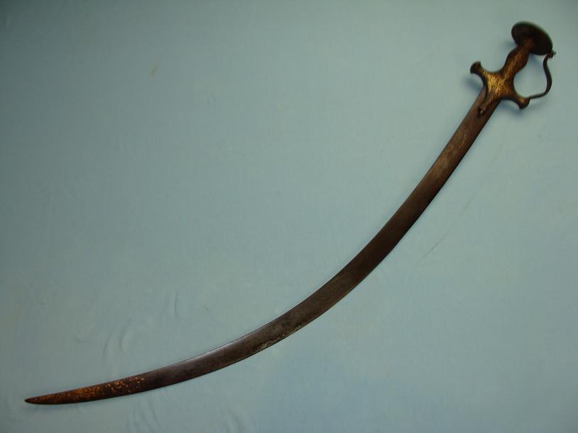

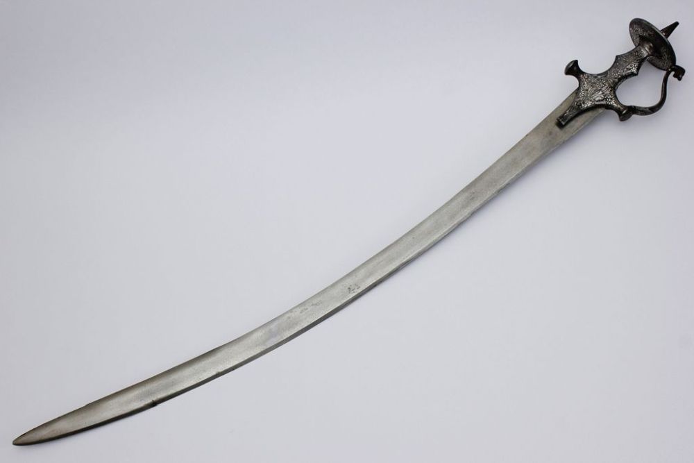

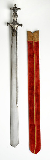

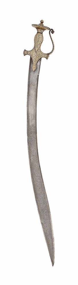

Anyhow, let us not fall into the trap of calling every single sword with an Indian, disc pommel, a "tulwar" because then we will end up with a lot of confusion.
Then we may very well call "tulwar" all the swords in the photos below, when in fact they are very different swords.
So, in naming a sword, I will give priority to the blade and call the swords below:
1. Tulwar
2. Shamshir
3. Tegha
4. Khanda
5. Sousun Pattah
But this may be only my narrow and stubborn point of view... yet, it is stubborn indeed!
