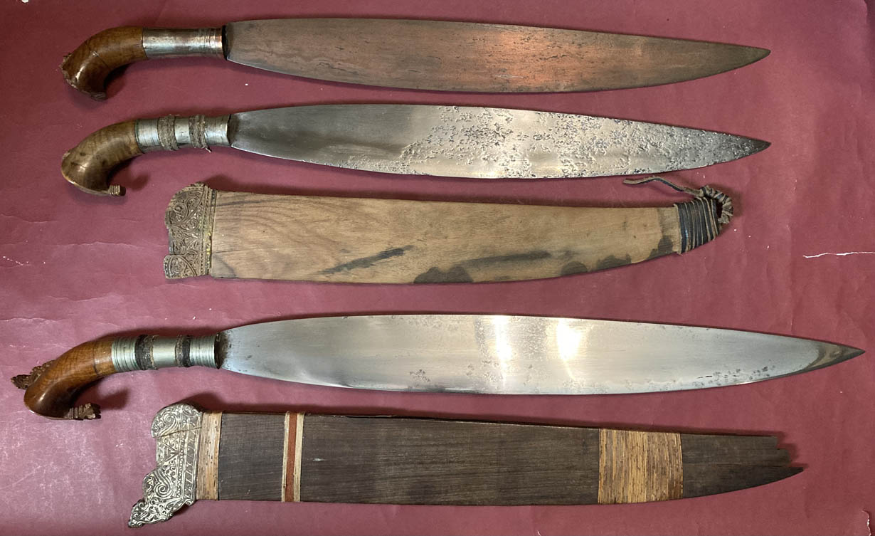

Hi All,
I'd like to know whether the three swords shown are kepings or barongs. Actually, I'm pretty sure the bottom one is a barong but the blade is so slender for its length (20.375" [51.7525cm] long by 2.5" [6.35cm] wide that I decided to add it to the group. The spine is also respectably thick at the hilt (5/16" [7.9375mm]). I really think the top sword is a keping and am not too sure one way or the other about the second one.
Sincerely,
RobT

Hi Rob, I believe they're all barungs.

xasterix,
Dang! I thought for sure the top one with that flattish part of the spine starting about half way toward the tip indicates that it is a keping. It looks as if telling a barong from a keping is rather tricky.

Yup it's tricky. One of the helpful things to tell them apart is the hilt. Barung hilts have a different flavor vs keping hilts (whether original or re-make).
